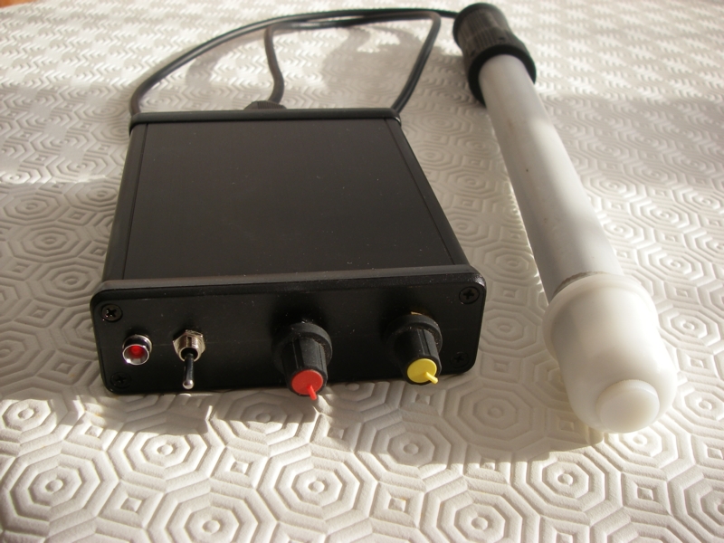

                      • Baracuda using like pinpointer
                        Hello all,
                        My Baracuda in pinpointer versus, I will try to make a video.
                        • Hello Legaucho please can you descript your coil for the pinpointer Bara i think with a switchbox between the coils (normal Coil and small for pinpointing) you can use the pinpointer coil on a normal bara like sunprobe pinpointer thank you.greetings from the harz montains
                          • Hello Vermeer111
                            My intention was to use the basis of the Baracuda for make a pinpointer, allowing me to locate more easily a target after locates with my main detector (Fisher F75).
                            I have therefore achieved this pinpointer with a coil on a kernel plastic hollow to be able to pass a screw plastic through ( one sees his head on the photo)
                            Caracteristic of coil: 0,6 Ohms inductance 0,485 mH.
                            Best regards
