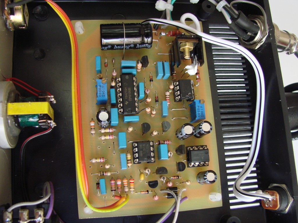

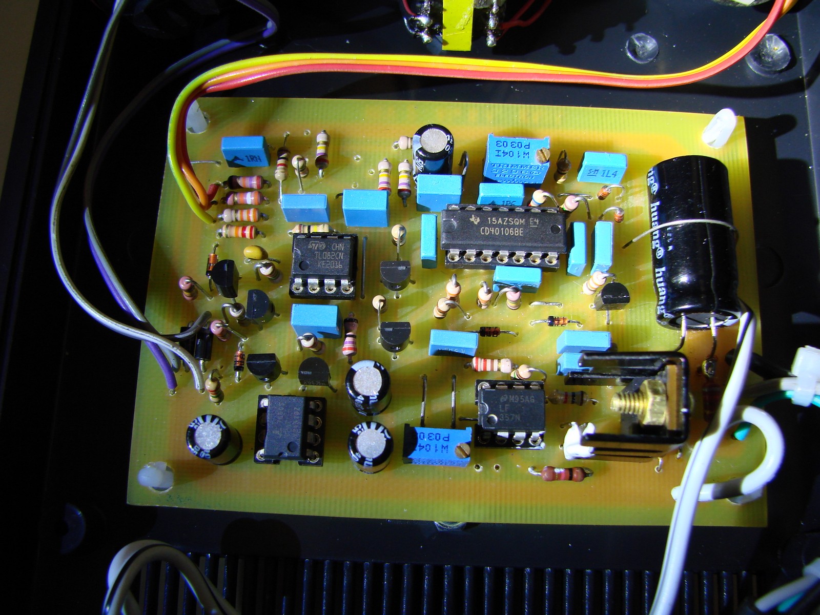

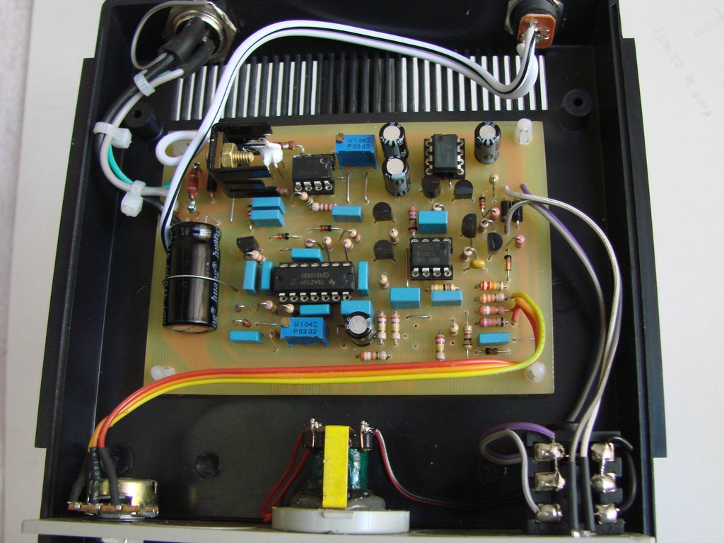

        • Hello, this is my Barracuda.
          • Good results from a Wilson Barracuda
            Whether slow motion or fast motion.
            best time
            j.
            • Thank jap, following a photo.
              Fet BF245C
              TL082
              LF357
              IRF9640
              • (all) beautiful Finish of box .

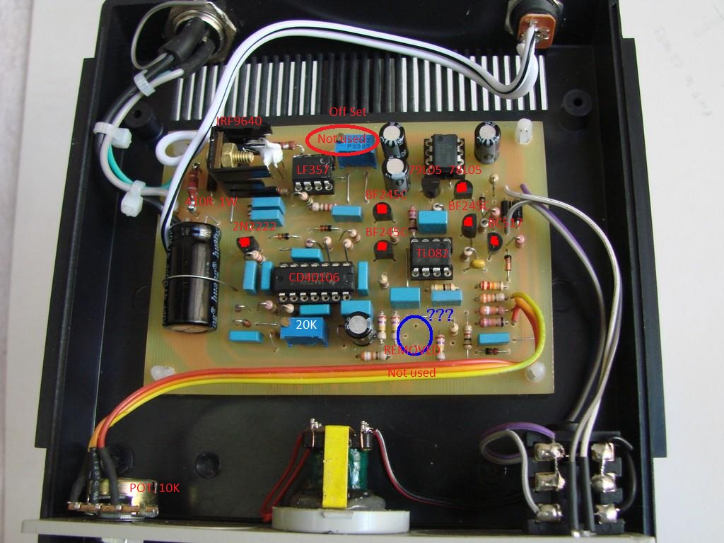

                        please I have some questions.
                        1-I need to know all transistors names that you use.
                        2-does your baracuda work without the last transistor and resistor 270k?
                        thank you

                          • Hello Volcano, eliminated 270K resistor ic pinout different from LF357 NE5534, iliminado "offset" because I do not have the original ci.
                            Attention: The PCB has been modified to correct the use BF245C pinning.
                            hug.
                            • Hello Wilson
                              The resistor connected to pin 7 of the 7660 is 2M2 ohms
