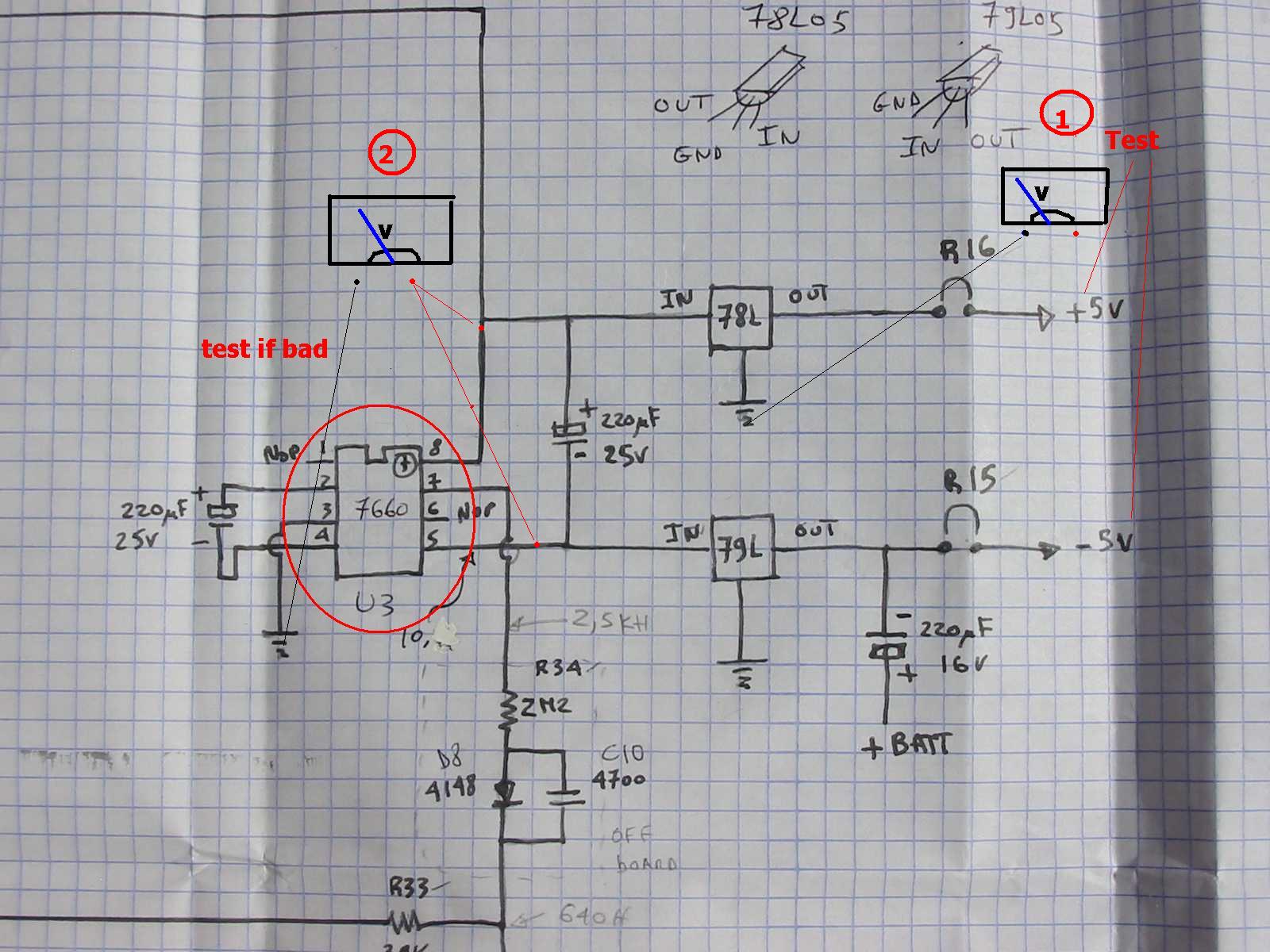

        Hi
        I have build Barracuda from silverdog and after i play with it a few seconds, the detector starts to make an intermitent beep beep beep every two or three seconds.
        I rechecked components placement and values and this are correct too
        Battery is fully charged and coil is the correct one. Any ideas of what could be wrong?
        In advance many thanks
        Nelson
        • Hi nelson.
          This topic has been well "developed" (25-page), there was talk of possible failures and their removal. Maybe you have something set wrong, take photos PCB in a better resolution to see...
          • Hi nelson
            - hard to find out the mistake, but can from you direction....
            Maybe,,,,,,
            -first The work of re solder with a random suspect.
            -read reply #557,575..May useful.
            -test 1 +5v.-5v
            -test 2 u3 reply #556.
            Step by step you will.
            best time
            j.

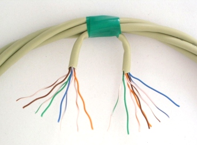

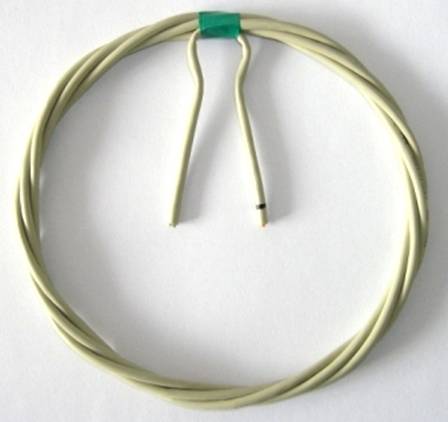

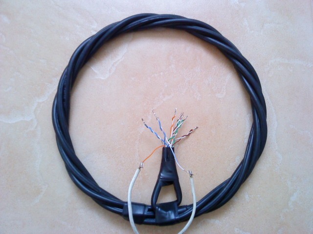

              • Hello Nelson, my Barracuda also has beep beep when in research, also rode a surf and the same thing happens, falços are alarms that hinder use.
                One way to reduce this is to mitigate the adjustment "Theshold", but this measure reduces the depth of capture of the target.
                I think the problem is the construction of the coil, it picks up interference causing false peeps.
                I found some pictures on the net this coil, it is constructed with a spiral twist, someone has built this one? This twisting should be to reduce external interference and the noise canceling.

                  • hello wilson
                    this coil is used by yhl for surf pi pro -he sais it works really good

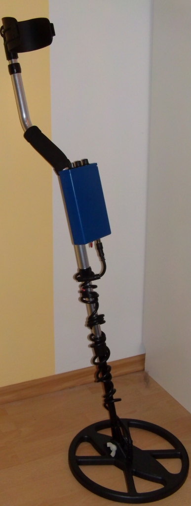

                    here last pic of my baracuda
                    • Bernte_one Hello, this coil uses some kind of shield?
                      Are you using a PIC in the electronic circuit of the Barracuda?
                      • hello wilson
                        no pic used i only use the word pic for a short version of the word picture
                        coil is not shielded i think its not necessary, it has good sense
                        but shielding coil can bring better performace on small items and shorter delay times
                        regards bernd
                        • OK Bernte_one, thank you!

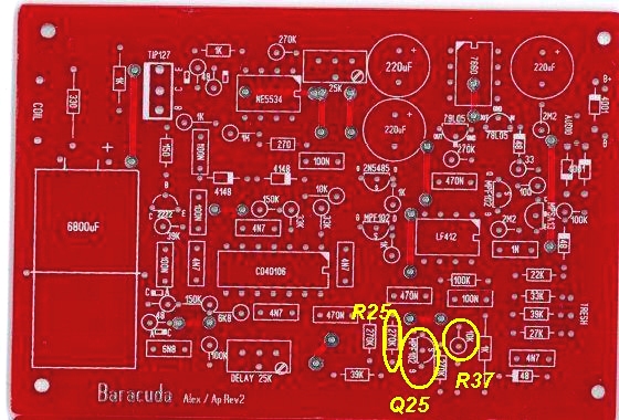

                          • Can someone pose a picture of the silverdog kit with the 3 omitted component locations shown? Q5, R25 and R37 . Thanks
                            • s
                              Hi grizzly
                              see
                              best time
                              j.
                              • Thanks
