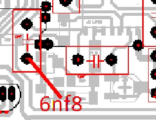

          • Hello
            bernte_one and satdaveuk
            Sorry. The value I put into the pcb is not 4N7, is C3=6n8
            regardsClick image for larger version
            • Hi
              Is C3 very critical, because had a bag of 50 and gone through half of them and not one is anywhere close

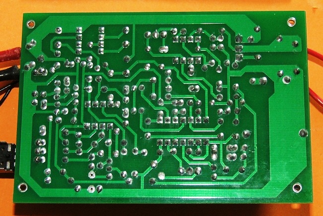

              • hello everyone just got around to sorting out my barra does anyone have a picture of the underside of the rev2 board(after its been correcttly soldered!)
                i know there is such a picture of the rev1 board but i cant find a rev2 pic i want to double check my soldering
                thanks ally x
                • pcb
                  thanks ally x
