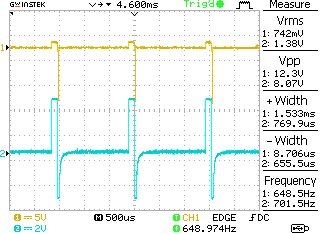

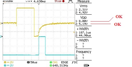

  • Hi my friends

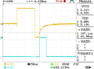

    i think tired you. but please change your op27 to ne5534 and show me the wave(ne5534-6)
    I have this problem in psg detector too.
    please tell me equvalent for ne5534 that i use in detector(all pins same together)
    i measure all point that you say all are ok!!!
    so i change 40106 and look at the ne5534-6 and dont change.then i chang all bf24b to bf256 again not change BUT all point that you say ok (i measure all and were +5 & -5 volt and 650hz)
    SO:
    i think ne5534 not good but op27 is the best.

    • look at this
      please tell me best of the kind of op(GP or GS or....)
      thanks
      • Hello Mohandes, keep the IC NE5534 it works well. In the picture you sent a waveform and PP voltages are correct. Fix your attention on the following stages.

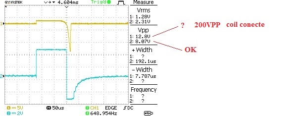

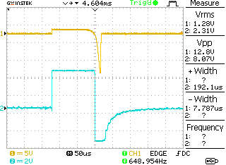

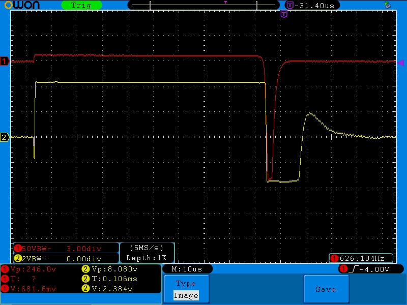

        • Mohandes, this other picture you sent looks weird, the pulse generated in IRF9640 "12.8VPP" coil is connected?
          In my barracuda pulse reaches 200VPP.
          • Originally posted by Wilson View Post
            [ATTACH]26243[/ATTACH]
            Hi wilson
            max voltage is 135volt p-p.
            my coil is 461mkH and 2.1 ohm , so what is the problem?
            can i use tel cable for coil or cable electical, like this ?
            thanks

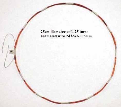

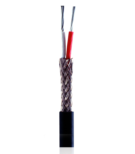

            • Mohandes, my coil is constructed as illustrated below, appreciate if some friend of the forum can help this information because it may have some variations.
ID:	337620Click image for larger version
Name:	2-conductor cable used in microphones.jpg

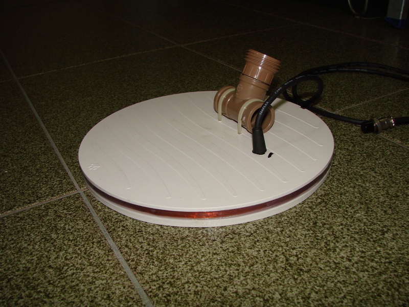

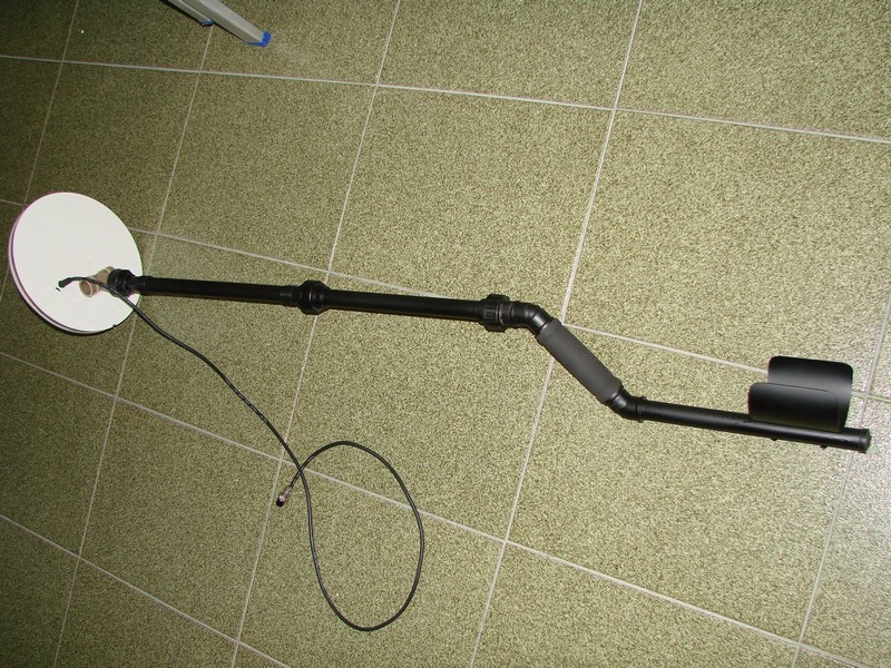

              • Coil built with lid, tubes and connections 3/4 "PVC for residential use. This is an example of a possible assembly.
ID:	337622Click image for larger version

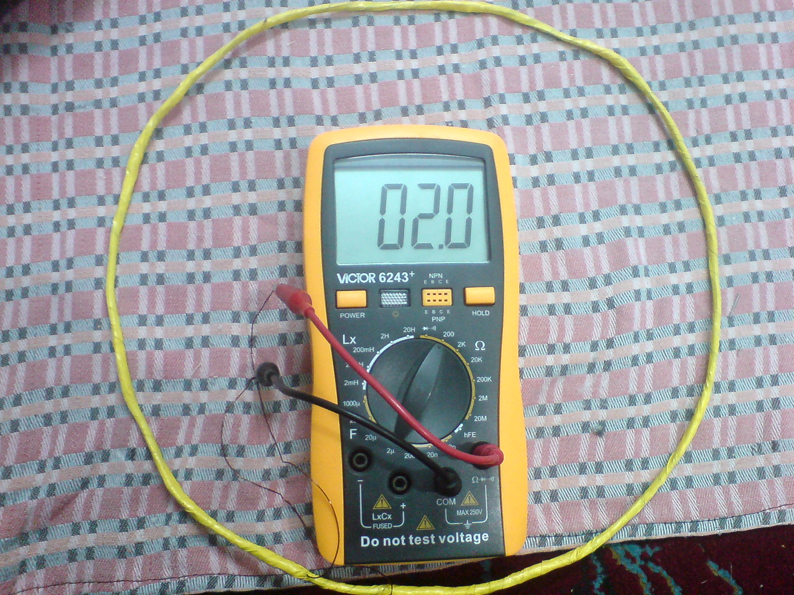

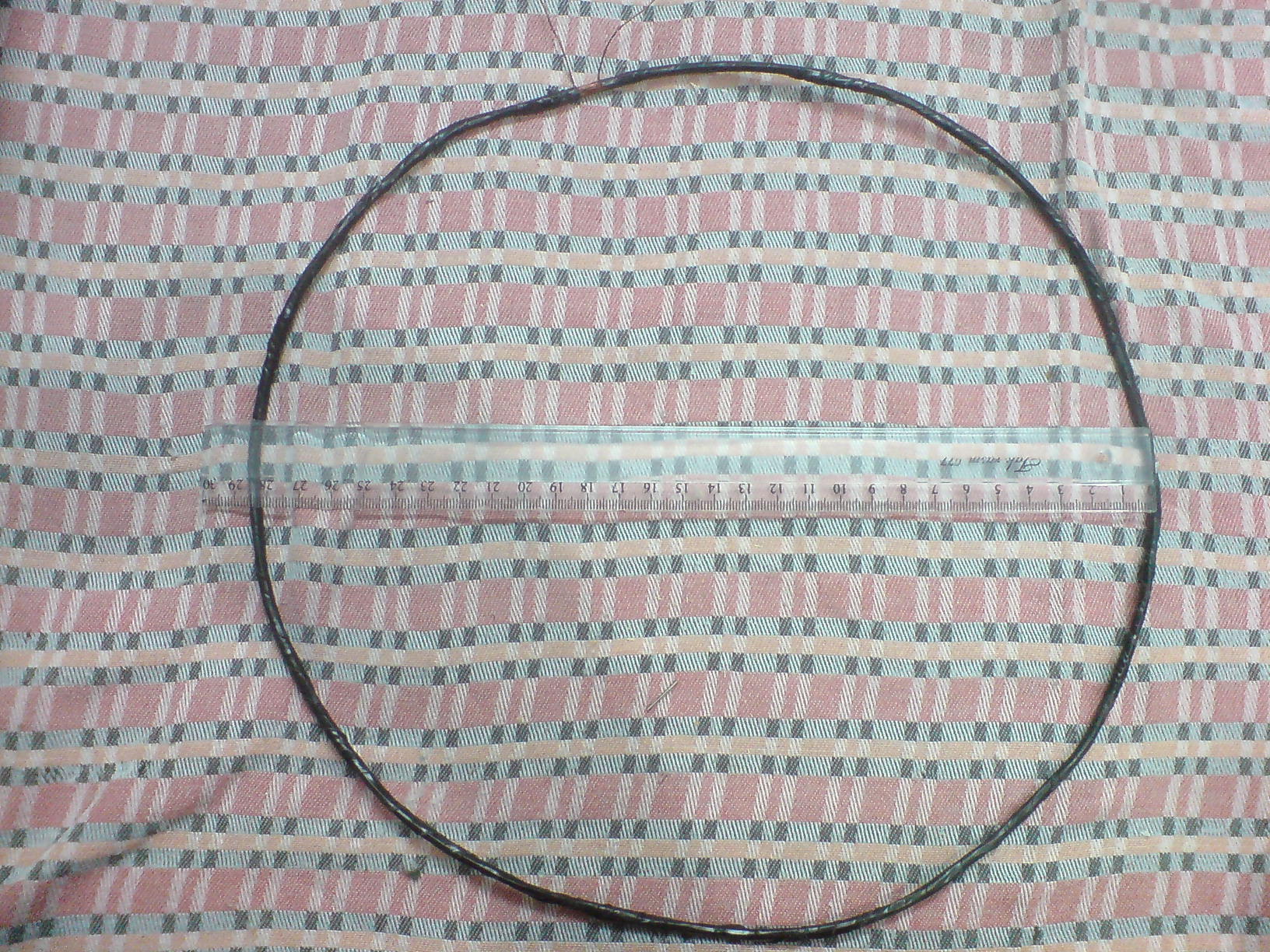

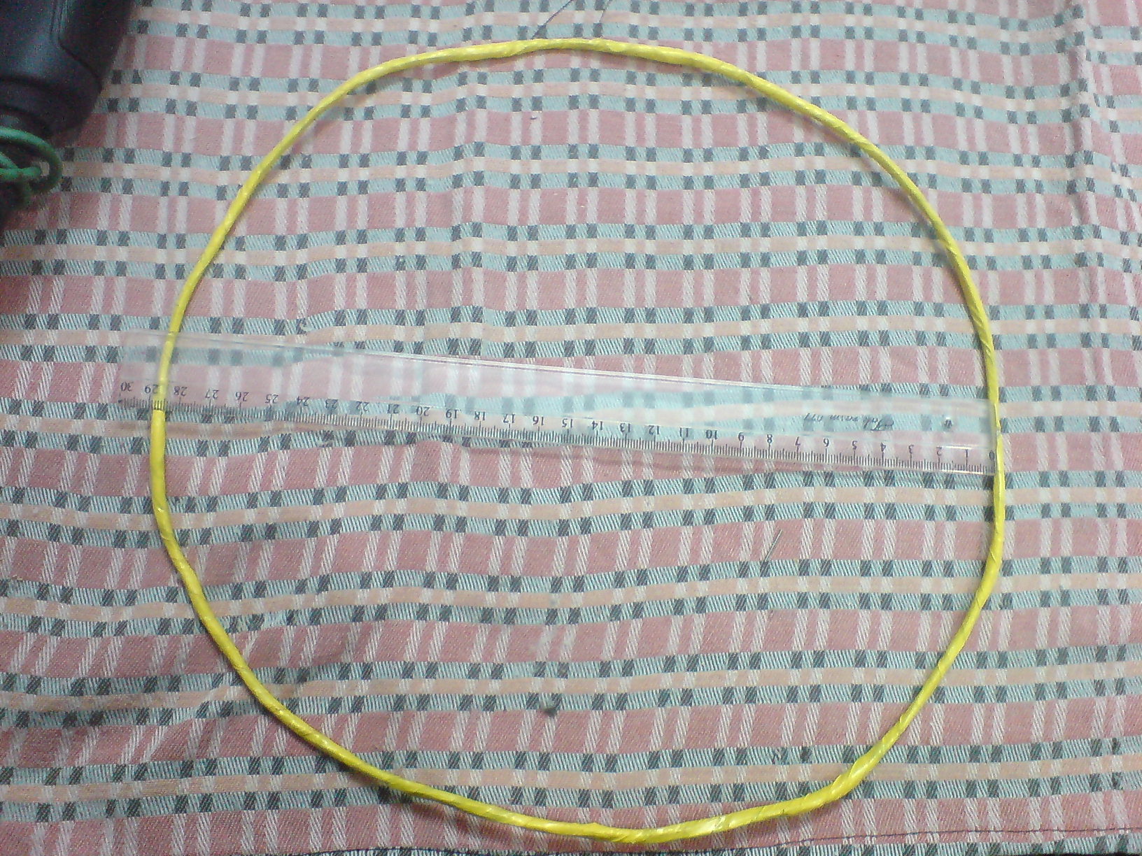

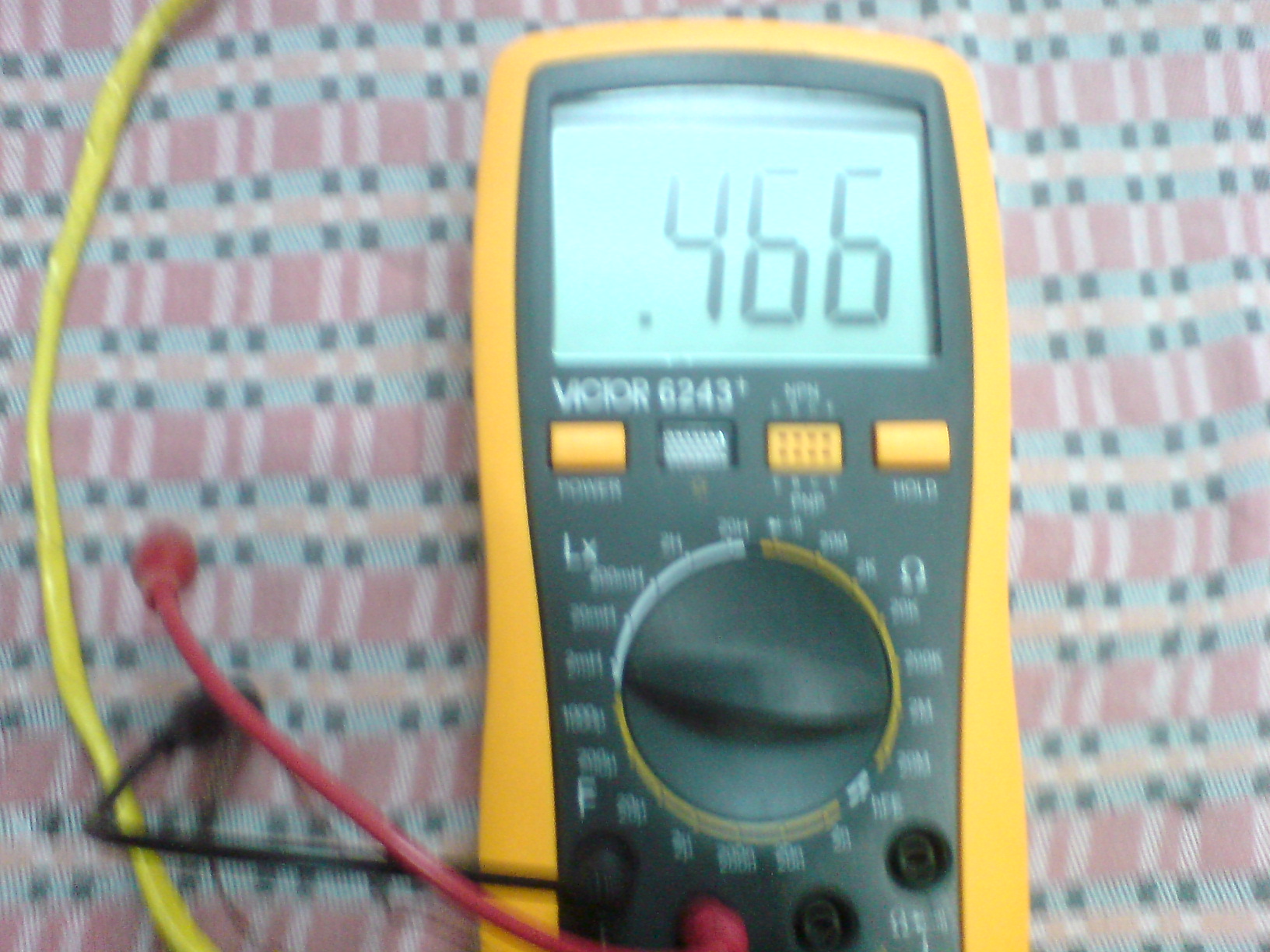

                • my friend wilson
                  look at my coils , seems ok
                  how can i calculate the MANUFACTURE voltage by coil?can you say me (have a formula)?
                  do you use op27?
                  can i see your coil wave?
                  thanks

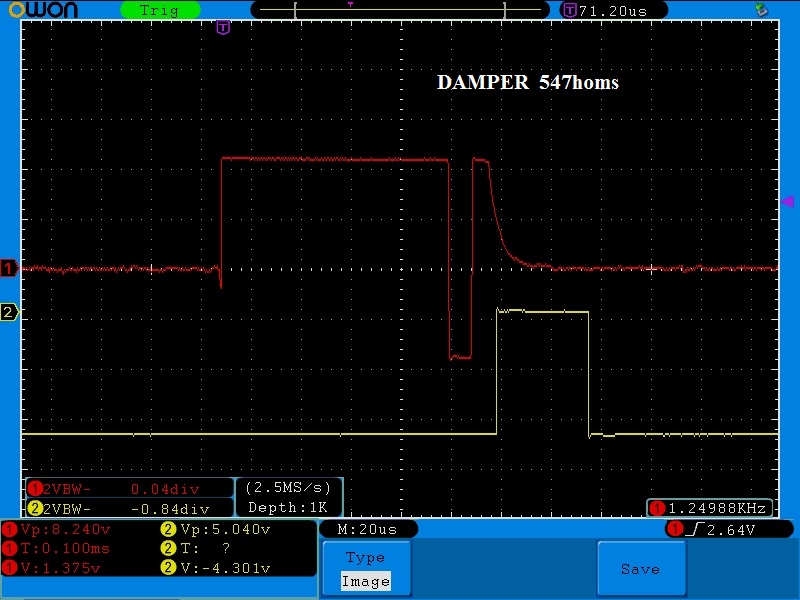

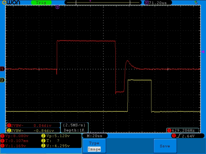

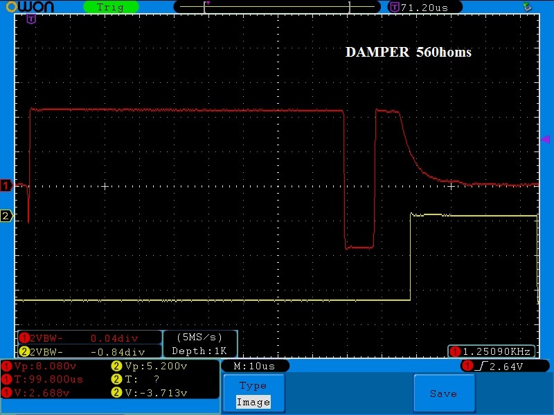

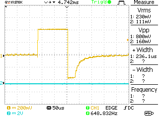

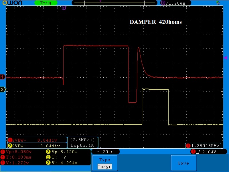

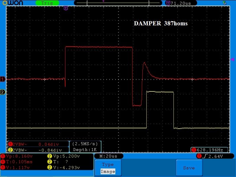

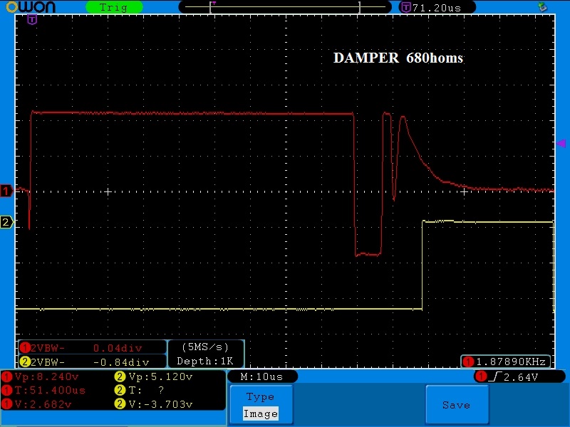

                  • Mohandes, try to answer your questions.
                    1 - I use the NE5534
                    2 - Logically egistem formulas, calculations and so on. Calculations are complex, usually almost all the forum build their reels based on information obtained, making mistakes and successes to get a good result. I believe that the forum has people who have knowledge of calculus ok.
                    3 - I am attaching some waveforms with different values ​​of the damper resistor, even with different values ​​barracuda works by varying the depth of capture of the target. I used a potentiometer 3W 1K resistor in place of the damper to show you how you can vary the waveform on pin 6 of the NE5534.
                    You're wasting your time, look for other problems in the circuit since it has no sound played ok.
                    If the waveforms are not similar to those of the builders of barracuda in this forum, please show me. thank you
                    • hello wilson
                      nice diagrams
                      if i understand right 420R iss the best value for your coil
                      or how would you interpret the waveform form pulse signal?
                      thanks
                      • Actually the last waveform (red one) is the best damped. This shows also a different yellow waveform and the settings have been changed so it is a little confusing. Looks like something less than 350 ohms would be about right.

                              • Originally posted by Old cart View Post
                                Hello old car, the figure you said that red is pin 6 NE5534 I forgot to identify the value of resistor damper, I used the original value 330homs ok.
                                The last picture refers to pulse the MOSFET on the coil reaches around 246VPP.
