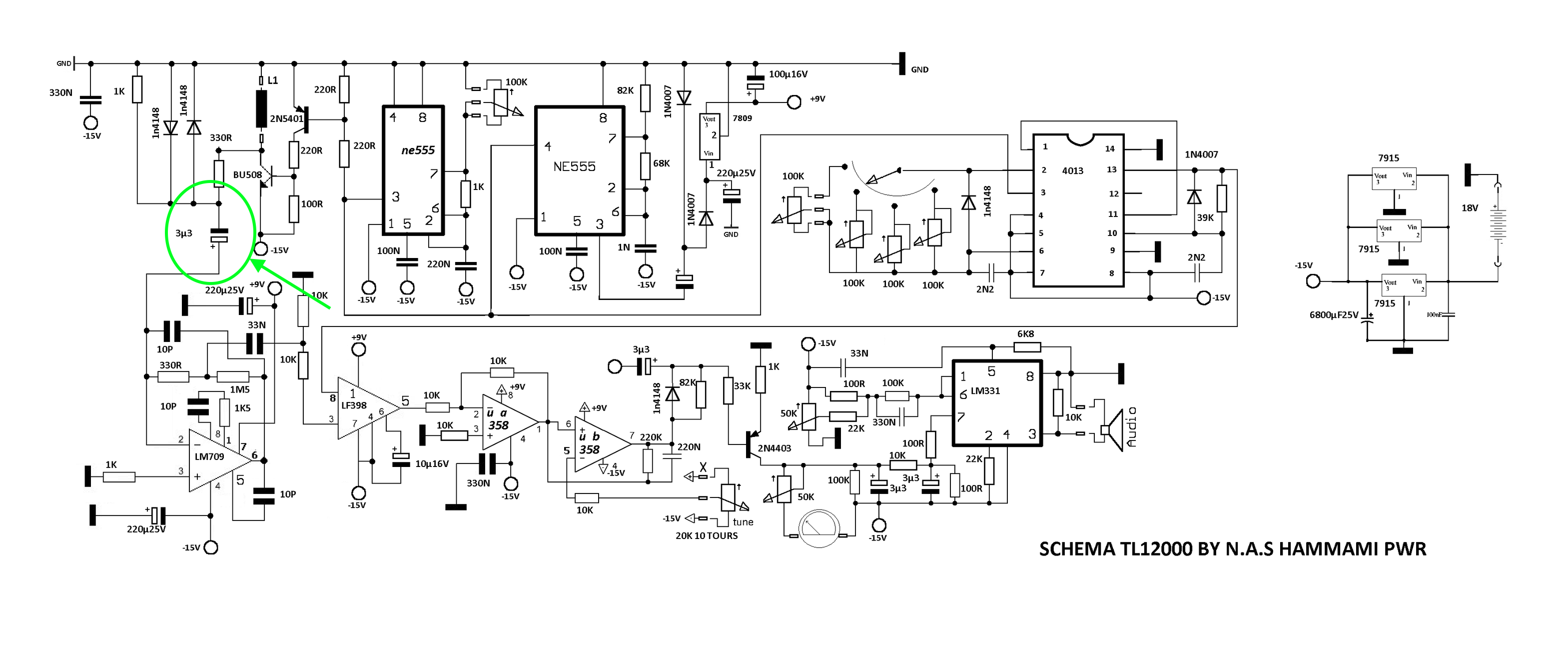

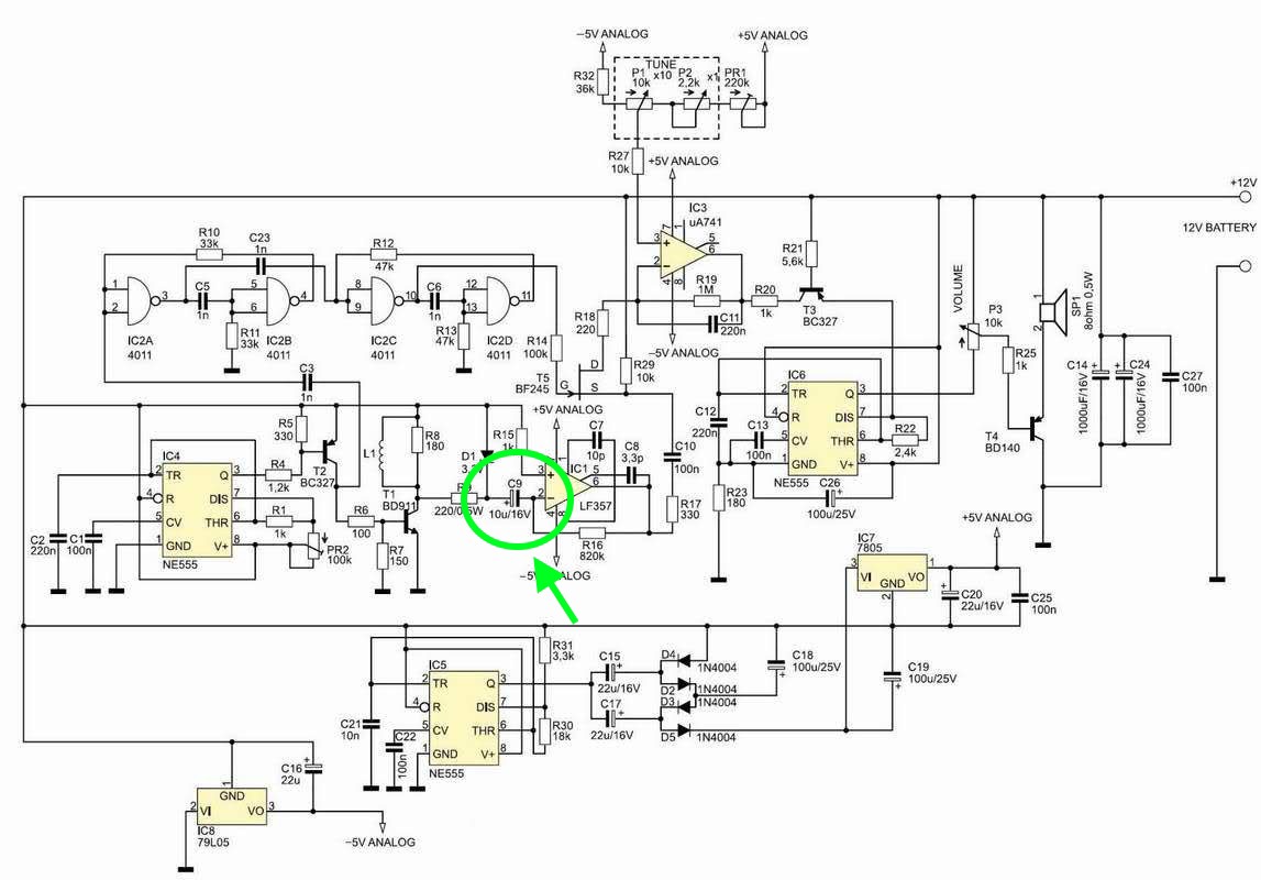

    • Hello,
      The PI Polones and the TL12000 both have an additional capacitor in the input stage. This might contribute to reducing EFE noise, but I'm not sure. I haven't tested it.
      See schematics.

      If it helps to reduce EFE noise let us know.​
        Hello,
        See schematics.

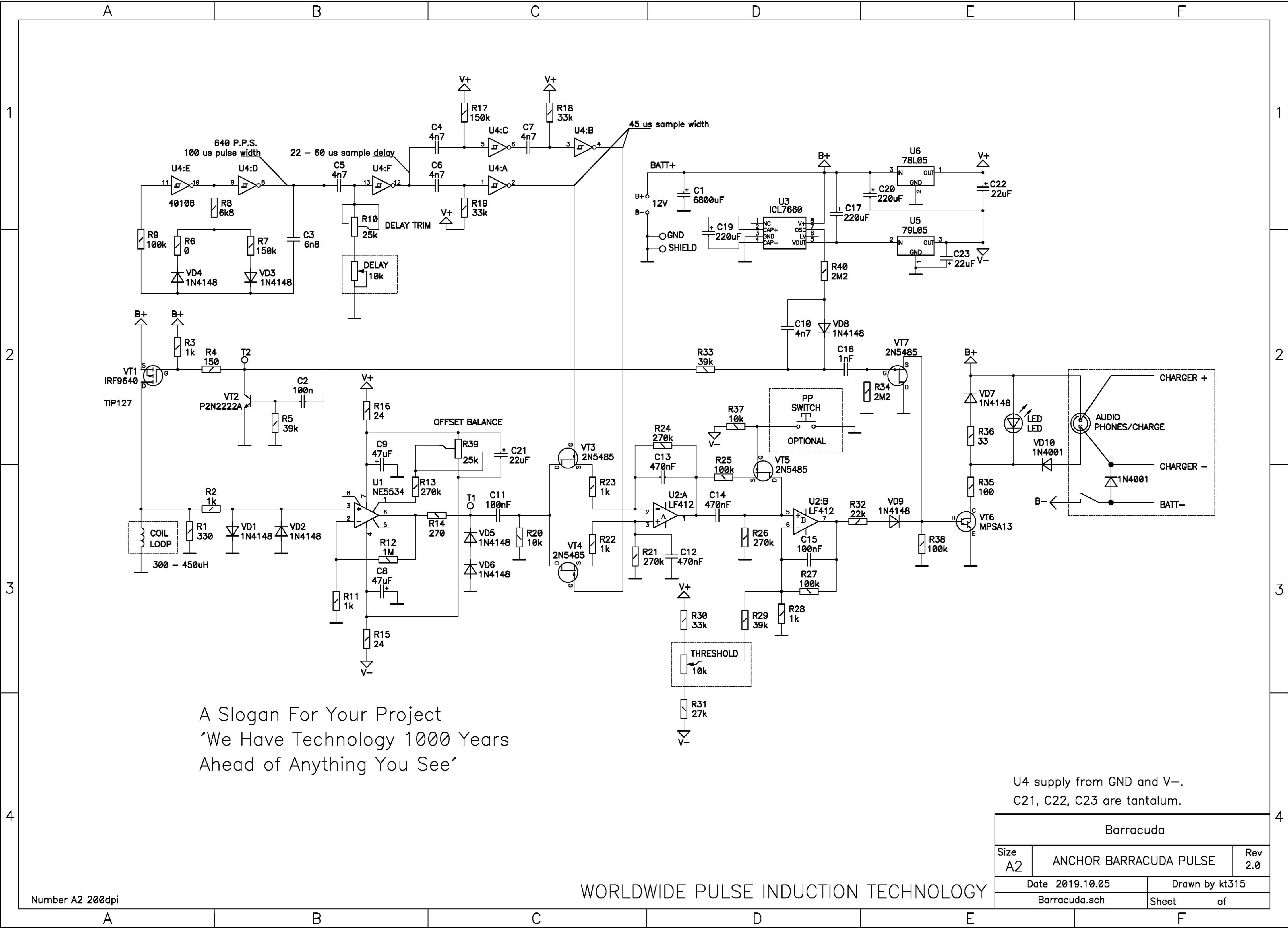

        Bara does not have the capacitor on preamp input.

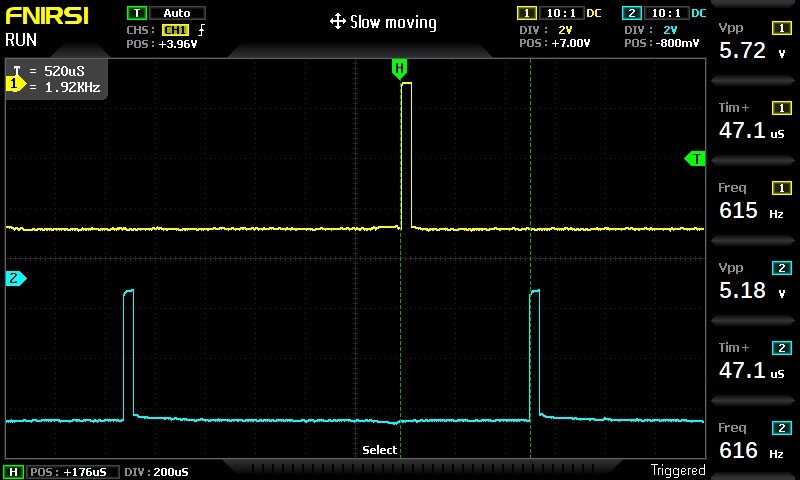

                  Show us what the waveforms on TP7 and TP8 look like.
                  hi carl
                  this is my TP7,TP8

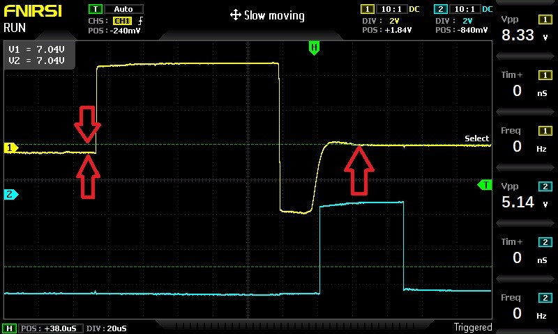

                  but i notice something i thing it is the cause of my problems take a look to this pic
                  coil is 1.5m off the ground and nothing around it

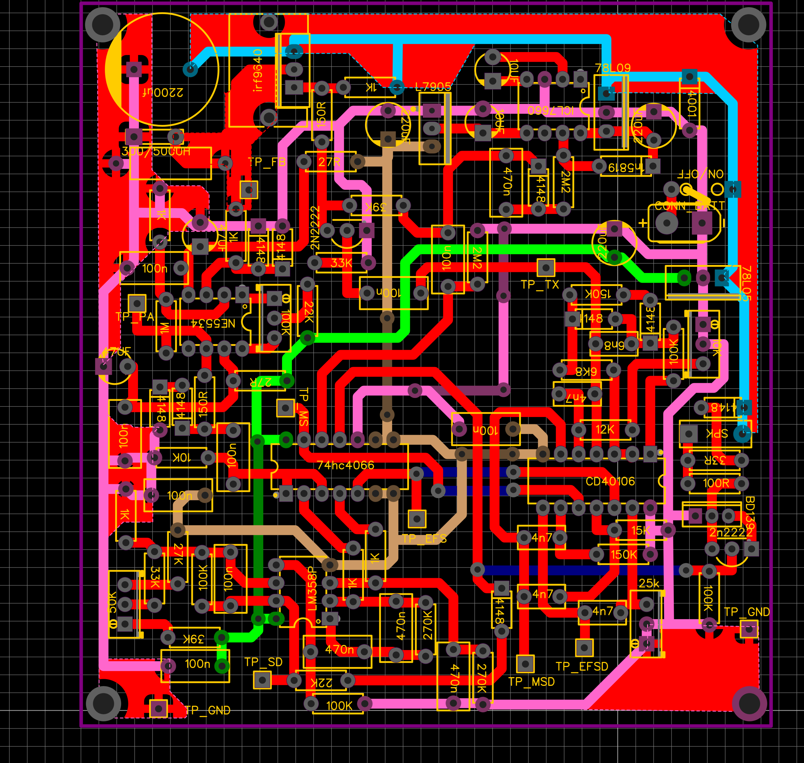

                  • Hello,
                    Could it be that the offset balance is incorrect, or that you're using a counterfeit Chinese NE5534? The NE5534 offset circuit in the posted KT315 schematic definitely doesn't match the NE5534 datasheet. What schematic is your Baracuda PCB based on, and what does your layout look like? I'm asking because someone in another thread also had problems with their design. It wasn't working as expected. The problem was this own custom PCB layout.​ The PCB tracks, how he routed his design caused disturbances in the electrical circuit.
                    • The preamp output looks good, the sampling pulses look good assuming the pulse widths are matched. That's what R21 is for, to trim the EFE pulse width to match the main sample width. You should adjust this while waving the ceramic magnet until EFE is canceled.
                      If you cannot get an EFE null by adjusting R21, then here is something else to try: remove C13 and short U4-pin13 to U4-pin11. This will cause both sampling switches to sample at exactly the same time with exactly the same width, and should cause any target -- even a large piece of metal -- to have a very minimal response, or none at all. If you are getting a good response then either U8 is faulty of there is a problem with the components around U6. If you do get a minimal response then R21 is not correctly adjusted or it is not EFE.

                        my board is a copy of original. George's board (GEOTECH) has another reference designators, 'own'.
                        • Hi KT315,
                          do we know what PCB is used by Deghbar613? Yours, the Geotech one or his own?
                            Hi KT315,
                            this is the PCB i am using

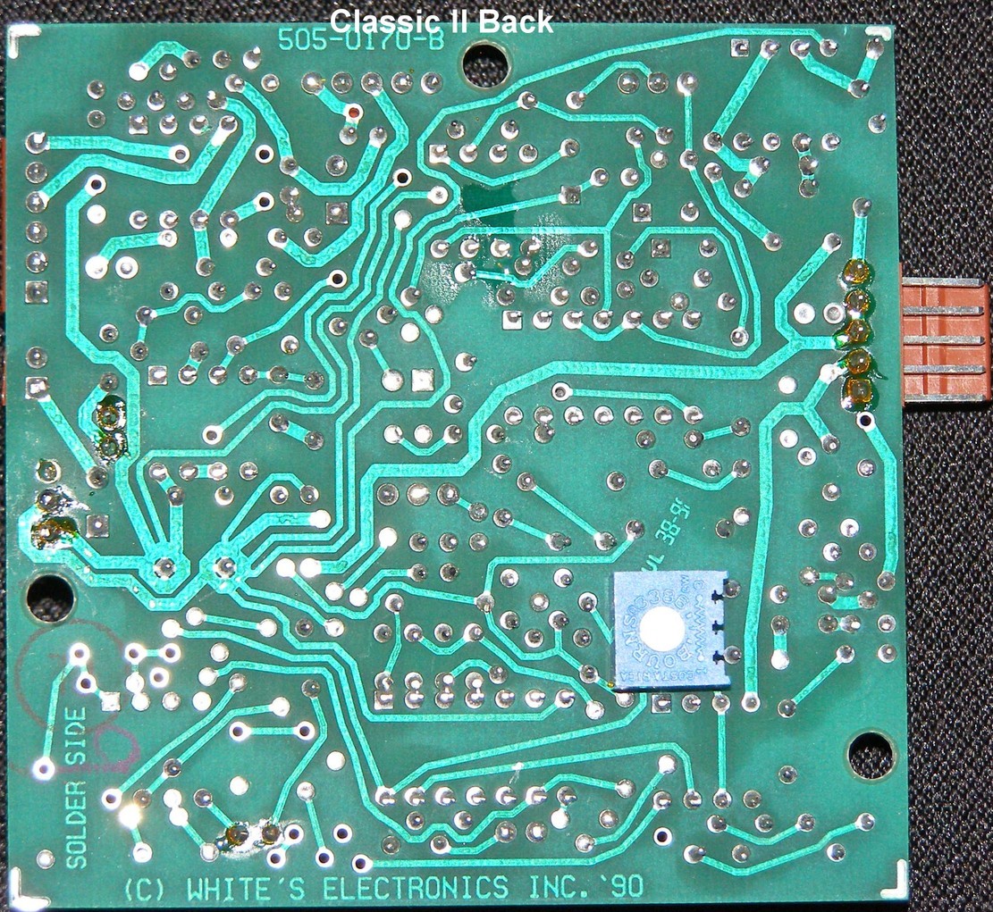

                            • take Quaoshi-George's layout, it's free. this your board is a trash... desolder it.
                              right trassing is HUGE SCIENCE chapter in electronics, no so you draw like you want doing just trash on finish.
                              i give you example of WHITE'S COMPANY pcb layout.
                              Click image for larger version  Name:	ClassicIIBack_pcb.jpg Views:	0 Size:	489.2 KB ID:	442826
