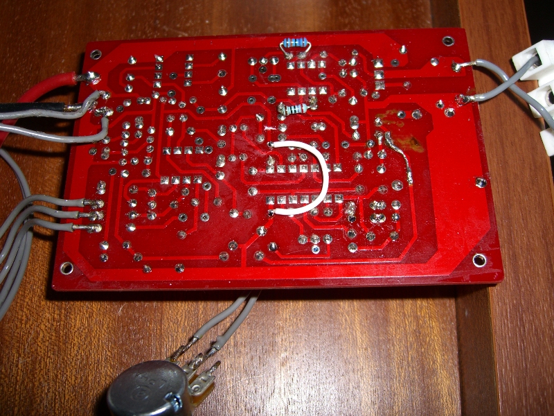

        • http://www.geotech1.com/forums/showt...486#post215486
          You could try the mod here.
          • Originally posted by Koala View Post
            And yes...its increase the treshold,but to noisy for CD40106 than HCF40106. Its help reduce the shake beeps to.
            Cut and make a jumper only, im not sure what the 2 resistor is.
            • Originally posted by ripsdevala View Post
              Thanks koala
              [ATTACH]36345[/ATTACH]
              You have to make all the mods. Read ALL OF THE REST OF THE THREAD. It will tell you what resistors need to be changed as well as what values they must be. If you just cut the trace and add the wire your earth field cancellation will be wrong which causes the false beeps. You will also probably have to replace the 40106 parts as they can be damaged by the original circuitry.

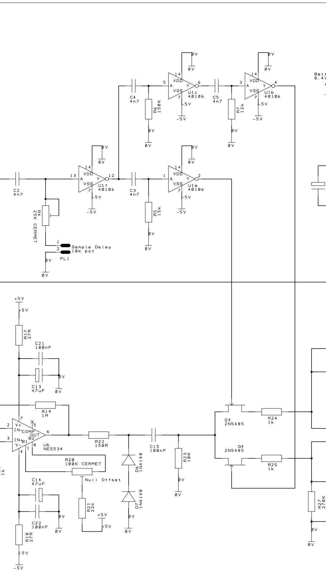

                    Read this whole thread from the beginning
                    http://www.geotech1.com/forums/showt...it-Rev2)/page2
                    The schematic you want is near the end in thread in post 124. The resistors that need changing are R5,6 and 7. When you cut the trace and added the jumper you changed the reference for the timing of the 40106 chip this means these resistors need changing too.
                    These new values should work but they may not. These chips are not precision devices. If this does not fix the problem you wil have to adjust the values. To adjust the values requires an oscilloscope. Do you have one and know how to use it?
                    Note it is also likely that the 40106 has been damaged because of the power supply problems discussed in post 102.
                    Good luck!

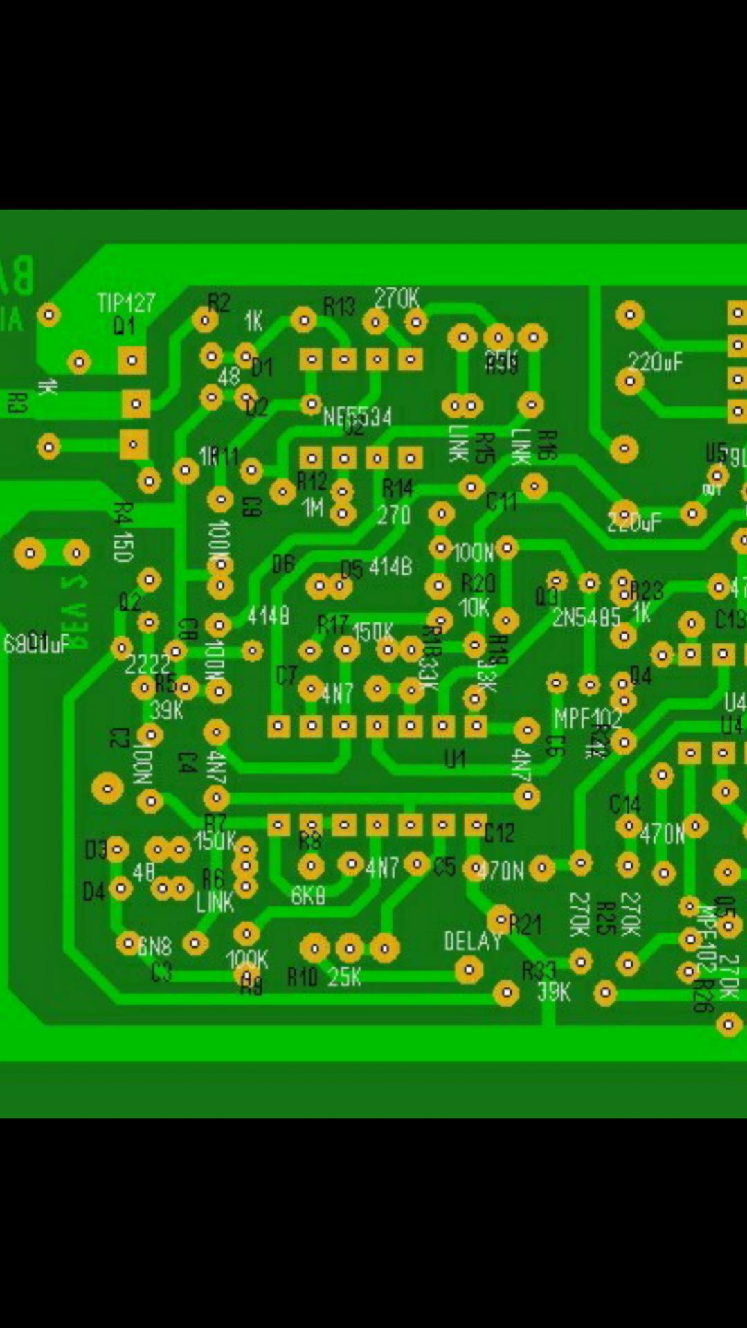

                          Original Click image for larger version
                          Change Click image for larger version
                            Nothing change, change R5 ,6 and 7. .. still beeping on tilt
                            I should wait CD40106 replacement.
                            Original [ATTACH]36362[/ATTACH]
                            Change [ATTACH]36361[/ATTACH]
                            I SEE THE PROBLEM. The resistors numbering has changed in the new schematic.
                            First put back the resistors where they were! Be careful. Every time you unsolder the pads get weaker.
                            R5= R19 on your board connects to pin 1
                            R6= R17 pin 5
                            R7=R18 pin 3
                            Double check these. You must go by the PIN numbers.
                            It is also wise to replace the 40106 but it will not hurt to try this mod. If it does not work then do the 40106 replacement.
                            Sorry for the confusion.

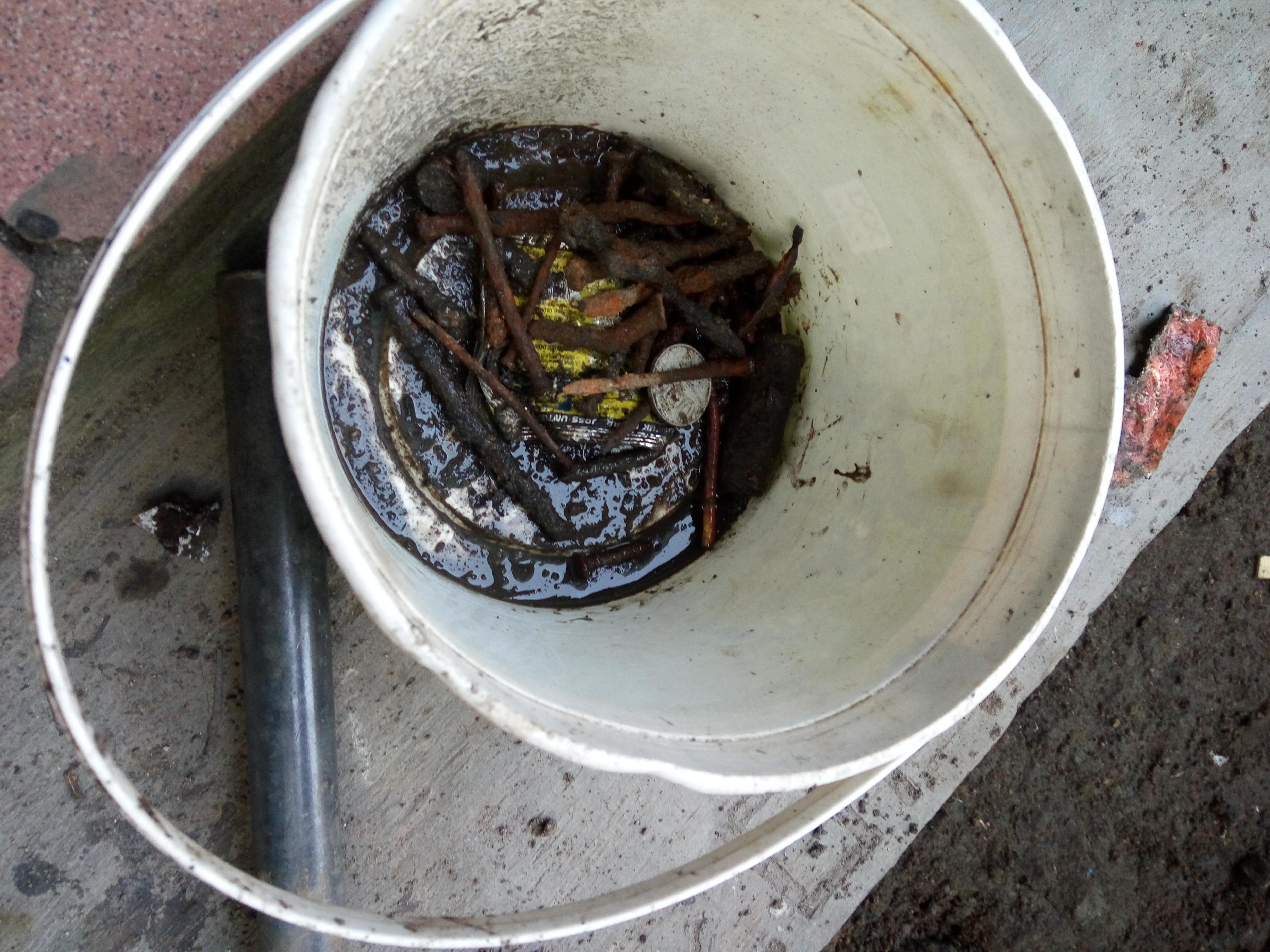

                              • Change R18=12K, R18=15K right?
                                Reduce tilt beep, already test outside....Nice, hope new 40106 will arrive tomorrow.
                                I using HCF40106, CD40106 is too sensitive.
                                Is this MD use ground earth efect as signal gain, its detect small nail on the ground, not in the air.

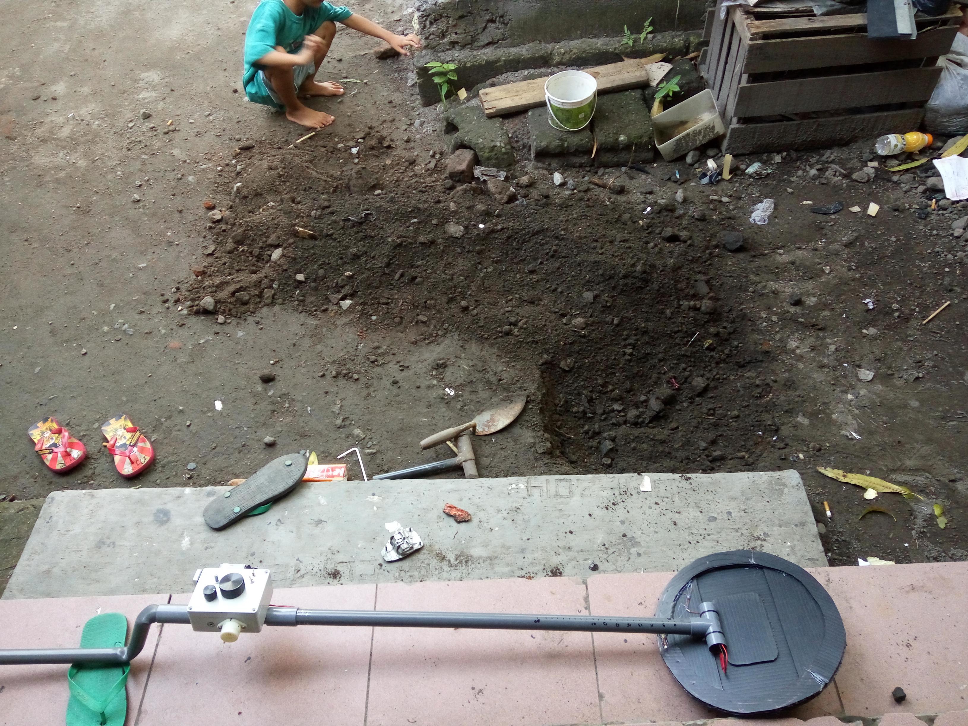

                                Dig site Click image for larger version

                                Result Click image for larger version
