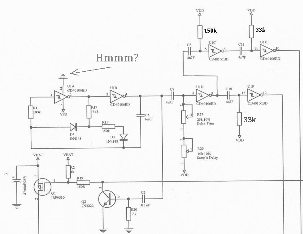

      To be honest, I've not paid a lot of attention to the Barracuda circuit. But now I look at the schematic more closely, I think you are correct. Can you measure the delay time for each sample? i.e. monitor the gate signal for Q3 and Q4. The secondary sample (Q4) needs to be made significantly later than the main (Q3) sample.
      You're right, Quiozhi. The Baracuda is fairly unique in that the primary sample is applied to the FET attached to the inverting input of the differential amplifier,
      with the secondary sample being applied to the JFET at the non-inverting input.
      On another note, I hate to make trouble but sometimes do it anyway...

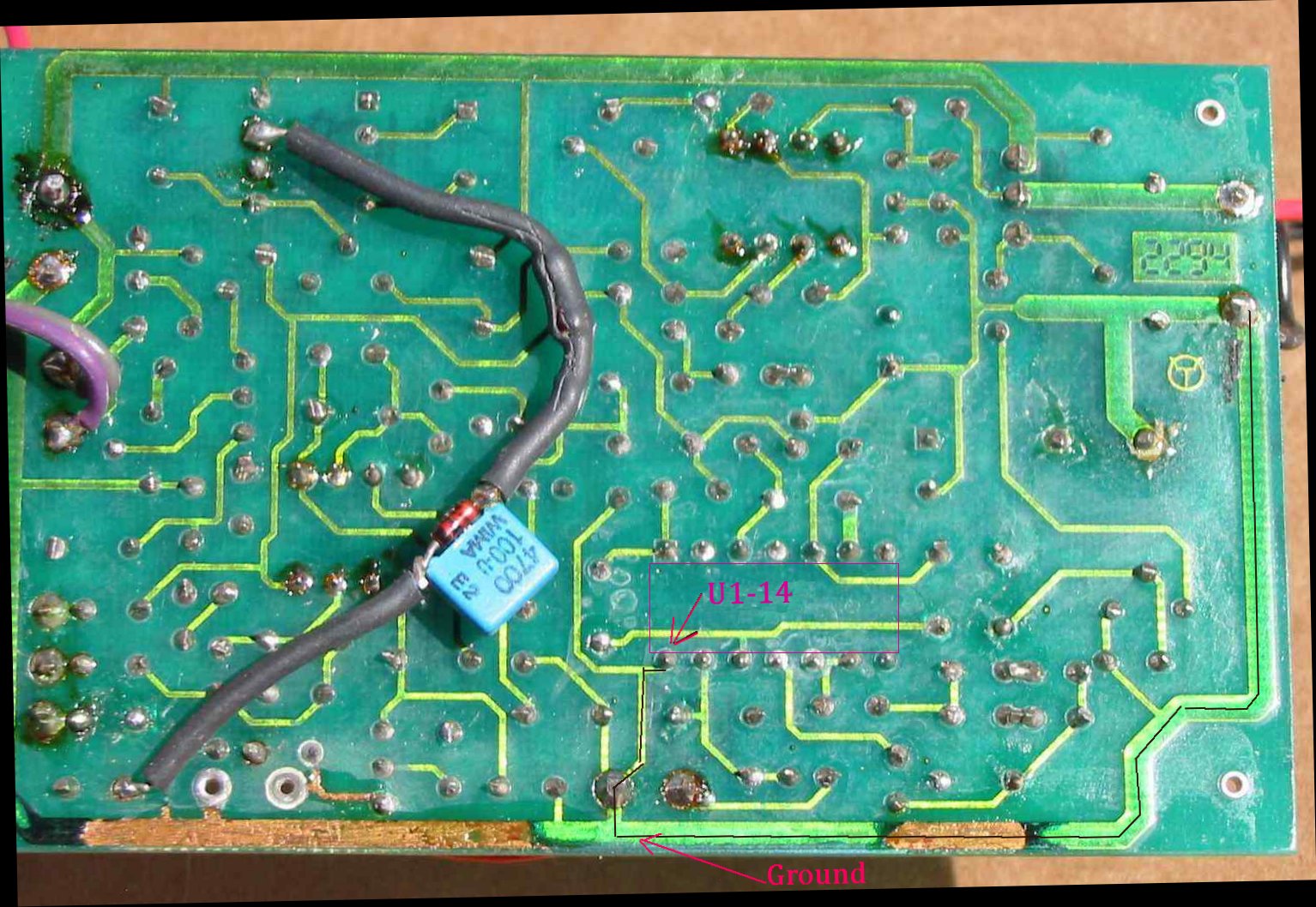

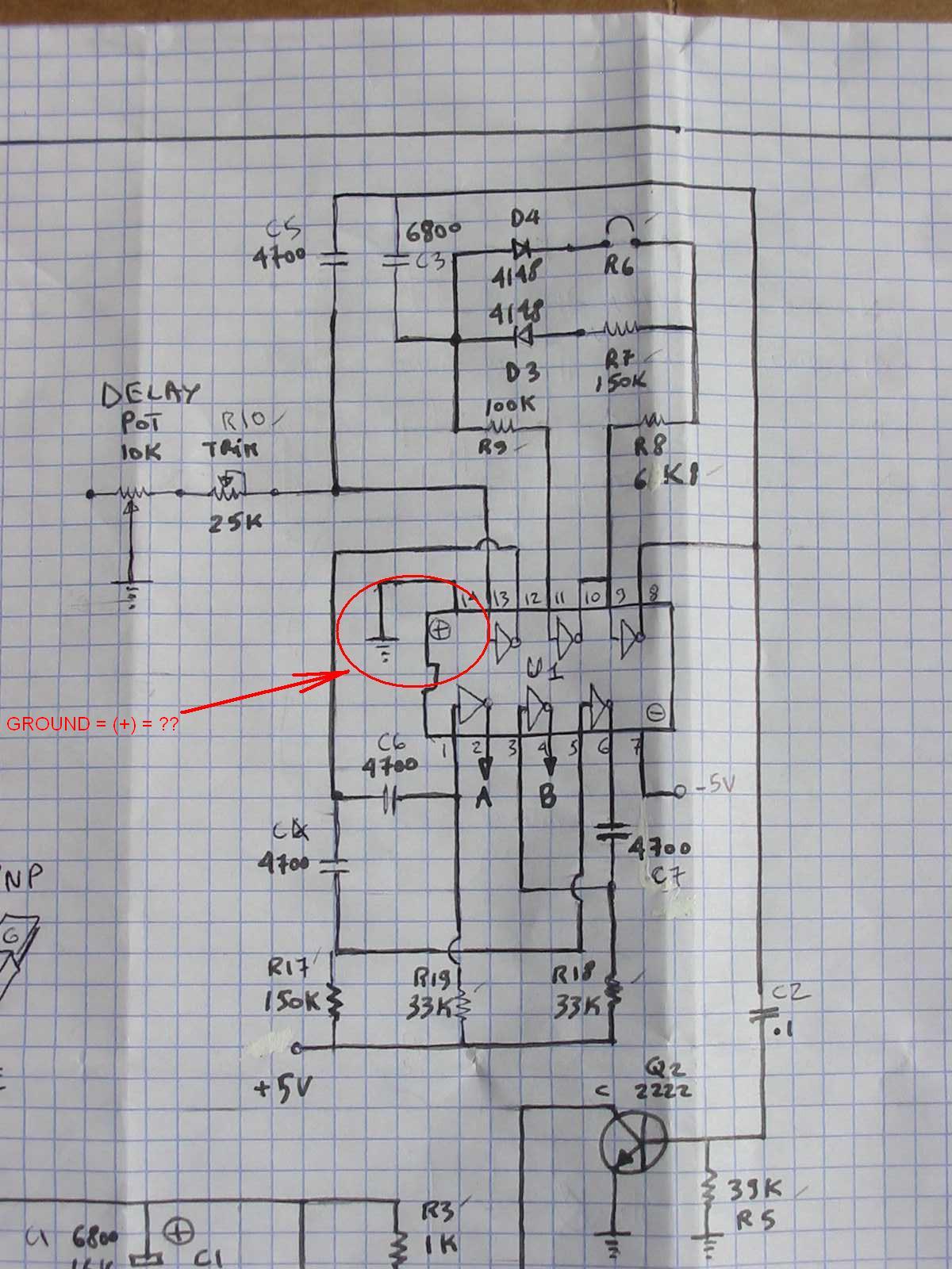

      I was examining at the Baracuda circuit and made an observation that makes me think the timing circuit is drawn incorrectly.
      Alexismex's drawing shows that U1 (CD40106) is powered from Vdd and Vss, +5 and -5V. I don't have a factory unit to look at but from looking at the photos on
      page 1 of this thread it appears that U4-14 (positive power to U4) is connected to ground, not Vdd.
      That would mean that the sample pulses swing from -5V to ground.
      I wired the tx and timing circuit up in LTspice and it shows that excursions from -5V to ground would be plenty to drive the transmitter.
      In the matter of the sample FET drive circuits, I never did like how the FETs were shown being pulled to Vdd (thinking that it would be more appropriate for them
      to be pulled 'high' to ground, not Vdd) but then I came to accept it (mistake though it may be) because if you apply some 'noise' voltage on both terminals of a
      differential amplifier, the noise voltage should be rejected because it is common to both inputs, and the output should still be an accurate product of differential
      voltage amplification. So, that could explain the current crop of Baracuda clones functioning well enough, even if the RE schematic has the error I've indicated.(?!)
      Maybe also the Tune Reset switch wiring needs be examined, as I have noticed some complaints about it being dysfunctional.
      Am I right, or am I wrong?
      • Ok, all the places where I said U4, what I really meant was U1.
        U1 is what looks like it the positive power is supplied from ground. (doh.)

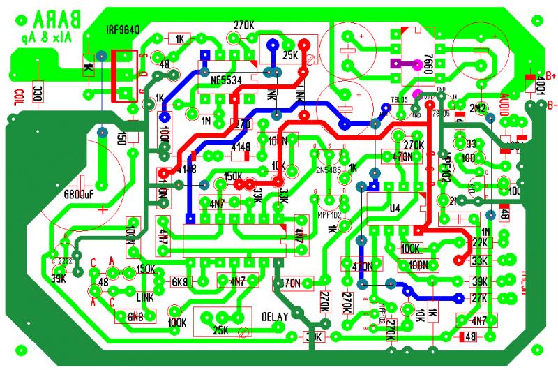

        • Originally posted by ApBerg View Post
          Hello Friends,
          Made a new pcb, I do not like those large standing caps...
          In the zip is the sprint layout file, hope there are no errors...
          Best regards.
          Ap

          • Also noticed a difference between the lay file and the Silverdog kit PCB.
            There is a small red strap (these appear to be called a link on the layout file) next to the delay 25k pot on the Silverdog kit PCB that isnt in the layout file contained in the zip file.
            • answers to Q5 and switch 1
              Hello gcause,
              I do not have much experience with metal detectors but I think I can answer your questions. The red stripes on the silverdog board is the copper layer on the top side of the board. You do not need to solder additonal bridges, copper wirer.
              For switch 1 and Q5 see attachment.
                  Hi porkluvr. Yes you're right here something is wrong.

                    No problem I think (but I can be wrong..) the 40106 is connectet to 5volts, -5 on pin 7 and ground to pin 14 ..

                      Hello Grant,
                      The function from Q5+ switch and "his" parts is not clear... so do not use the switch
                      Best regards.
                      Ap

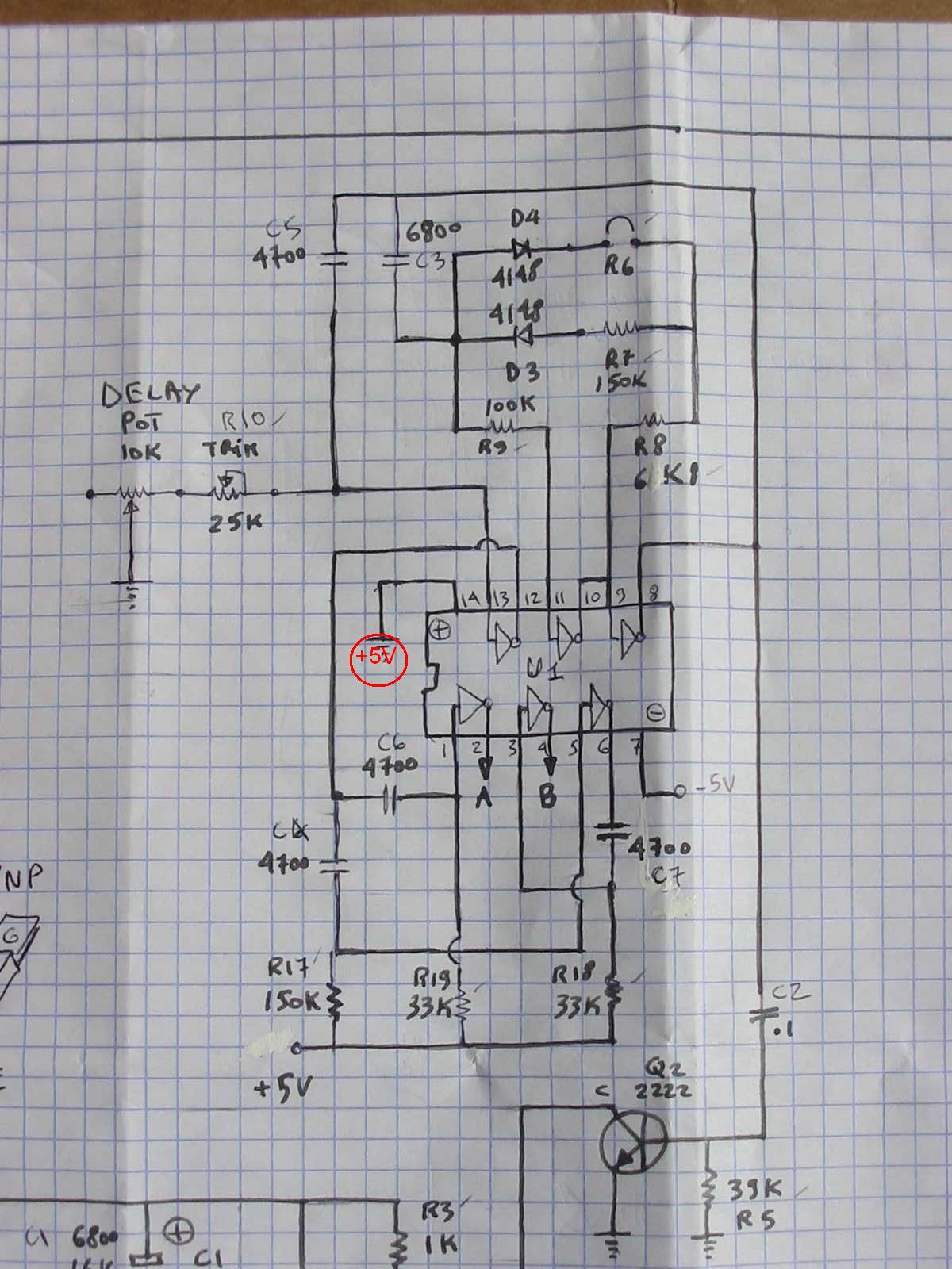

                      • Hi ApBerg. Pin 14 of IC 40106 should be connected to "+5 V" and not "ground". It seems that the schematics of Alexismex not correct.
                          Hello Friends,
                          You're right, no problem. My post was false alarm because I was stupidly looking at older schematic. Nice work on your PCB, by the way.
                          No. ApBerg and Alexismex are correct. I was looking at an OLD schematic copy - nicely printed but incorrect in many areas, the one posted by KT315. I should have been looking at the hand-drawn Alexismex (later) version. It does correctly show ground on U1-14.
                          Big mistake, my bad. Sorry, people. (Egg on me.)
