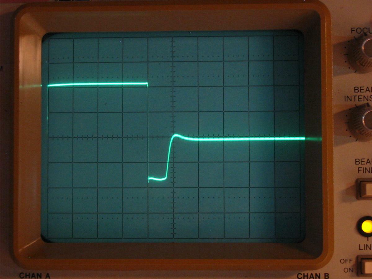

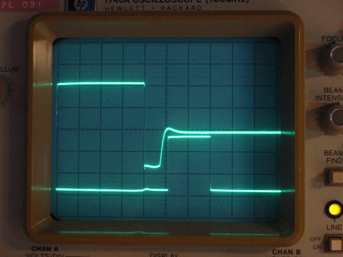

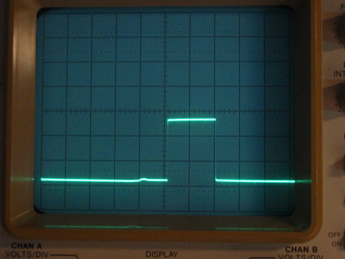

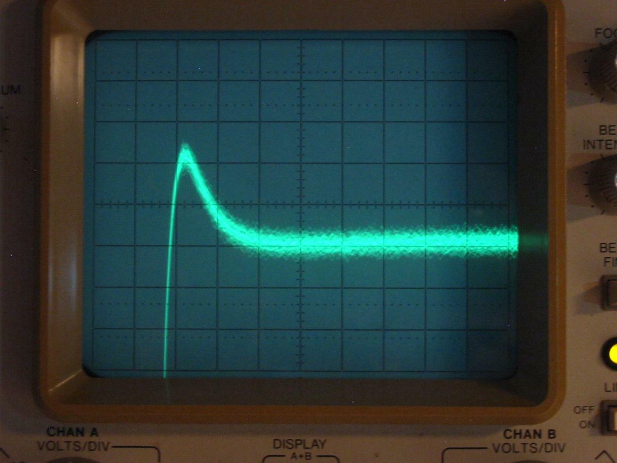

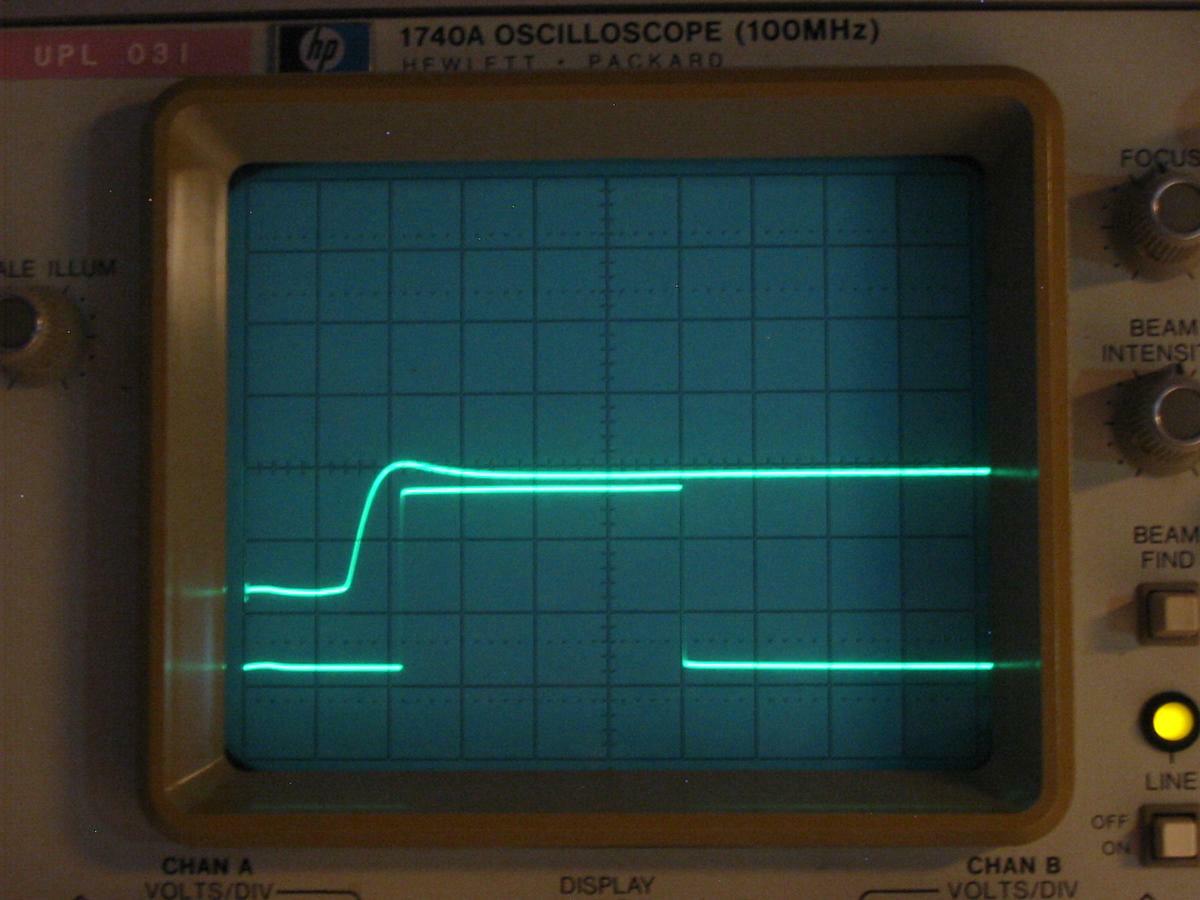

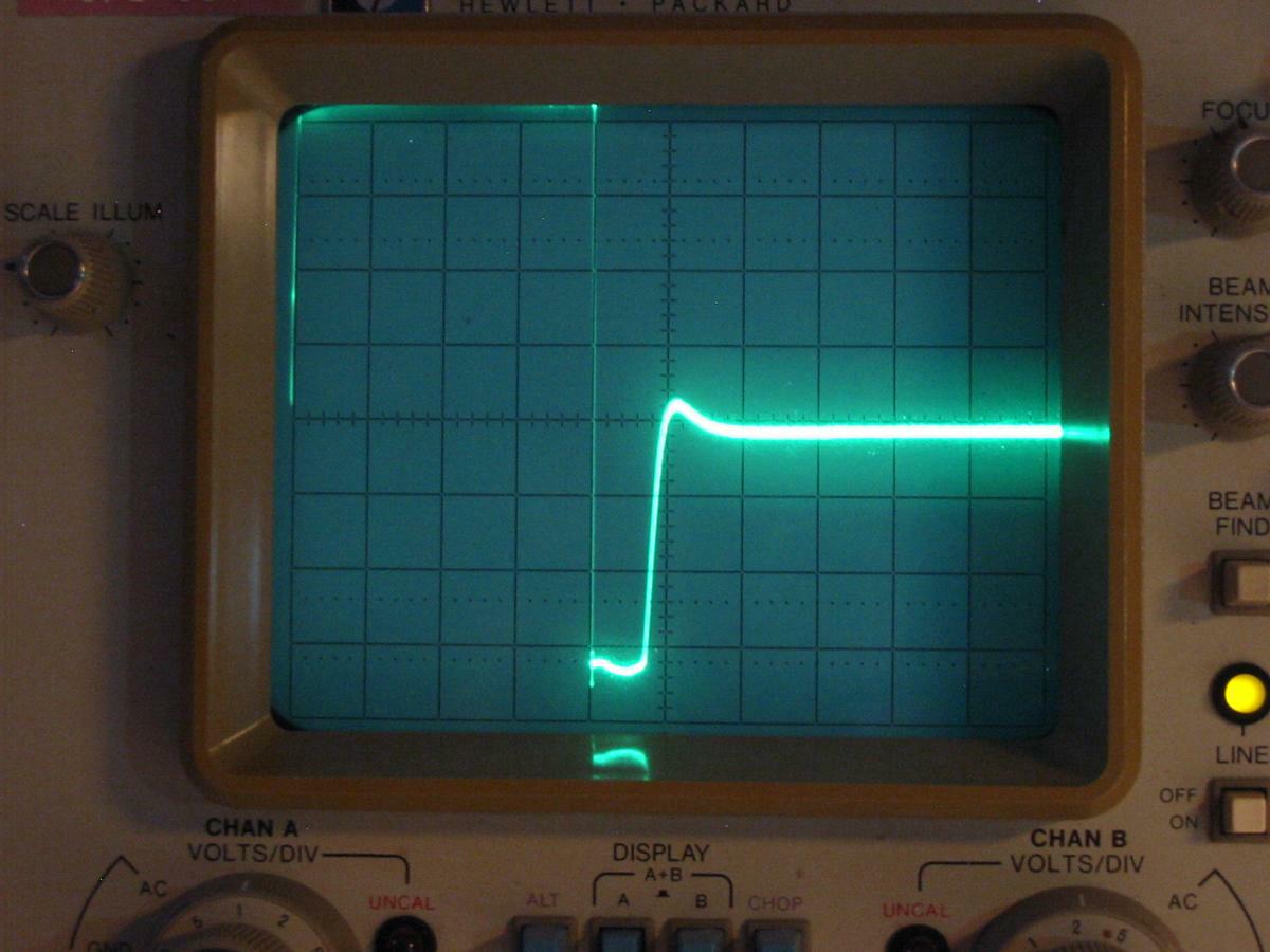

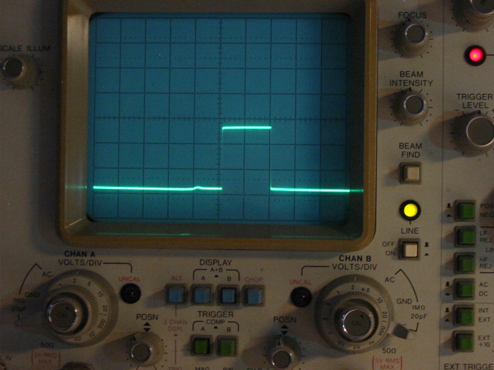

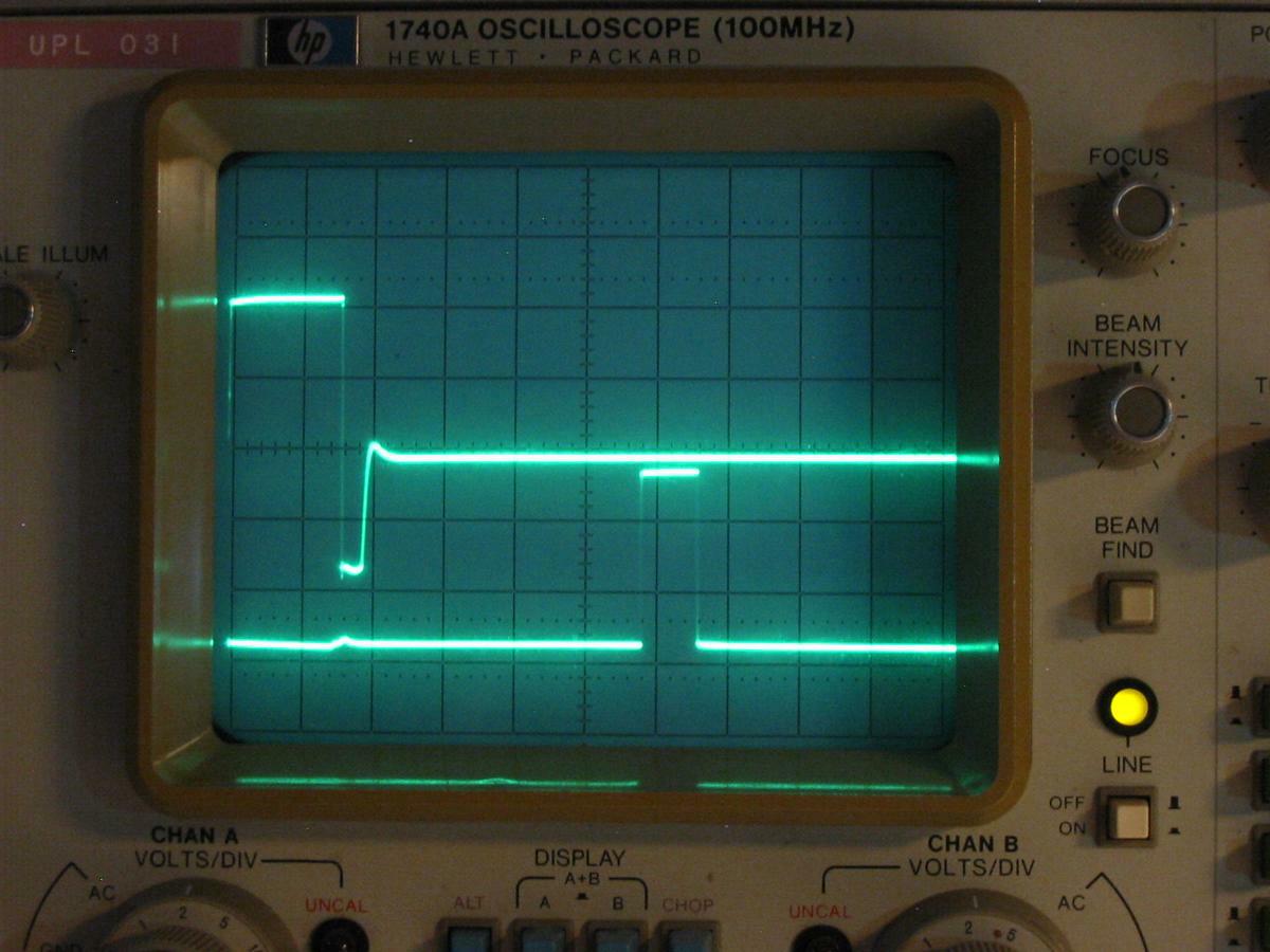

    • Some photos make in the original Baracuda
      Pin2 Q3...First window(2V/20uS)
      U2 pin 6 (2V/20uS)
      output of 5534 (2V/20uS)
      Window 1 DELAY position Zero
      Pin 4 Q4 (2V/ 50uS)
      U2 pin 6 (200mV/10uS)
      • More Photos from baracuda original ....see the noise in the last
        • You can see the adjustment of the first window with Delay in position Zero and second window
          • Dirceu

                    • Hi Alexis
                      Thanks very much for supplying the scope pics of the original Barracuda waveforms - very helpful, thank you.
                      ApBerg, thank you for all your advice and helpfull suggestions, I have seen now that if the offset is set to high then this is what corrupts the pulse on pin 2, when the offset is lower there is a cleaner shape to the pulse.
                      I have not had time to do much work on the Barracuda at the moment as the tides have been long and so I am busy out on the sands with the SurfPI, but will have another try at tuning it up in a few days time.
                      Regards to all, Jim.
