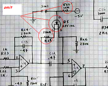

                            • Help with Baracuda kit
                              I'm new to Geotech and see some of you have some experience with the Baracuda PI. I'm building the kit from SIlverdog and found out that some components were removed such as: 1-MPF 102, 1-10k, 1-270k that were redundant?. Can anyone confirm the locations were Q5 (MPF 102), R37 (10K), R26 or R27 (270K)? ALso, what is the procedure for setting the trimmers? Every schematic and parts list seem to be different and I could use some help! I bought a waterproof Whites case and wound a nice coil and can't wait to finish it. Joe
                              • Originally posted by Joseph Norrell View Post
                                Hi Joe
                                I guess you haven't been getting my emails ?
                                The parts are Q5, R37(10k) and R25(270k)
                                Adjust the top trimmer to give 0v on ne5534 pin 6
                                The delay is best adjusted with a scope, but if you can adjust to detect a gold ring your pretty close to perfect
