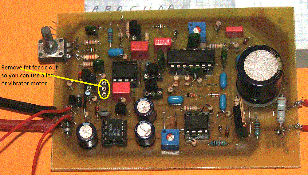

    • Baracuda kit is here Andy! I gotta say this board is a beauty. Can't wait to get started on it! Before I do, are there any changes I should be aware of?
      Thanks,
      Bob
      • Originally posted by plumabob View Post
        Thanks,
        Bob
        Hello Bob,
        Look carfull for the 2n2222 connections E/B/C the symbol on the pcb is NOT leading for how you place the 2N2222, the text for E/B/C is good so look on the data-sheets transistor that you use.
        The fets that switch the signal after the NE4434 are importend for good sensetivety, I tested some, not working was the BF245c the b and a versions were O.K.
        Think if you can select the 470nF caps on close tolerance( same value) this is good for the sensetivety...
        Lots succes and have fun...
        Ap

                        Andy would you mind posting a good picture of your completed working Pcb
                        thanks
