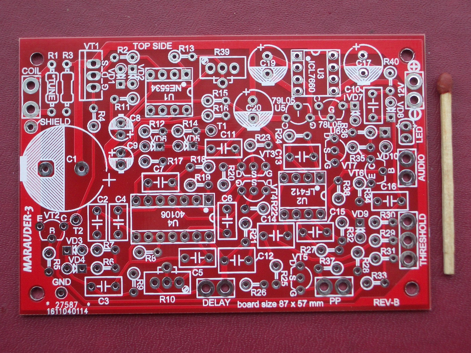

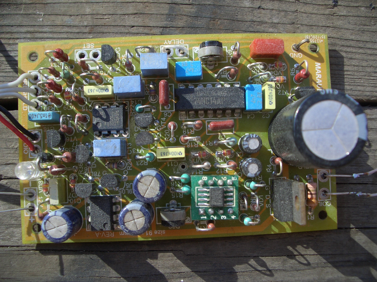

  • Hi to all, i bought this pcb 5 yrs. ago and i finaly soldered i have some questions if i did it correctly am i missing something on the photo you will see that i made circles on it. I seen on some other photos they put switch and something else can someone help me with the board . I didnt test it yet i need conector for 9v battery also to solder the speaker on it. Thanks in advance

    • 9V batt LR22 typo does not work with PI detectors. lowest current given. your longest trip in electronics... just began...
      • Thank you then 6 batteries with 1.5v AA is that ok
        • alkaline ok. accubatts 1.3V 8pcs AA gives 10.4V.

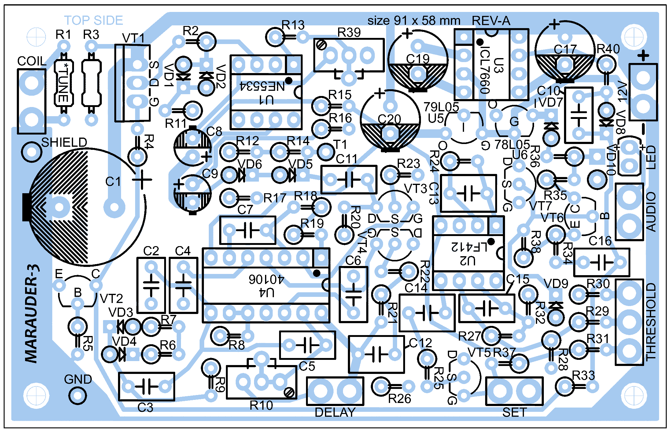

          • Where is on the board on/off switch does it work without it ? Also is I got 4700nf 25V is this ok or i have to put 16V ?
            • the switch is left just on mine board. on geotech board it deleted.
              • On my 1st photo the circles are one of them switch ?

                    He's not referring to either your PCB or the Geotech version. He has the the original Apberg board.
                    Dominator69 - There are several problems with the Apberg board that were corrected in the Geotech version. Please read the full story here, and in particular read the Build Document -> Geotech Baracuda - REV-A - Project Details

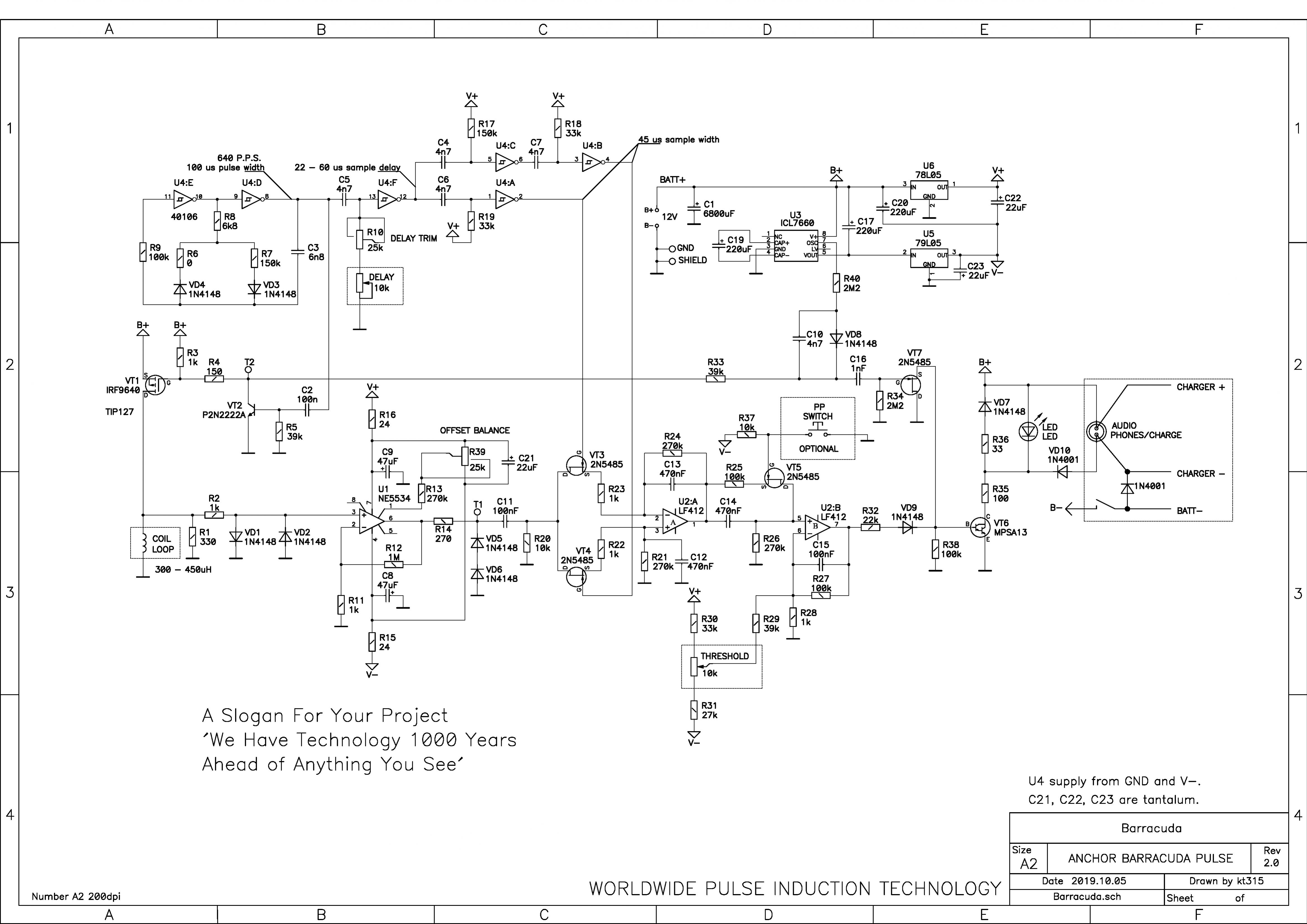

                                we have this schematic '650 RTR'... but i do not see RTR on the enclosure.
