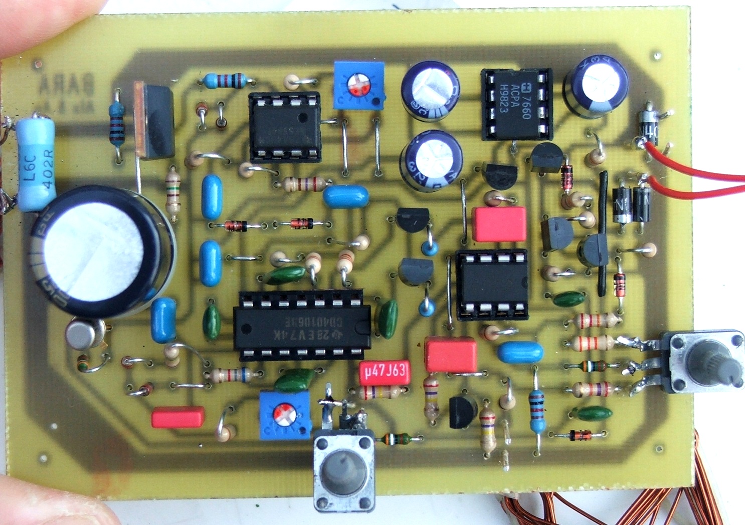

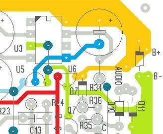

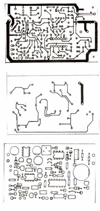

            Made some corrections, send also the Sprint Layout file now.....but I have not build the board (yet) so there can be errors in it !
            If anybody make's the pcb it is at his own risk !! (pfff.. I do not like this...) but I have no time to make the pcb in the next weeks ...
            Best regards.

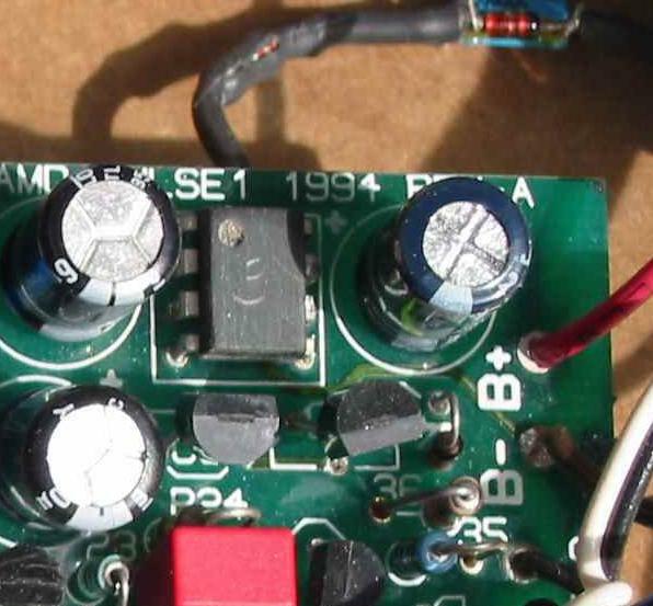

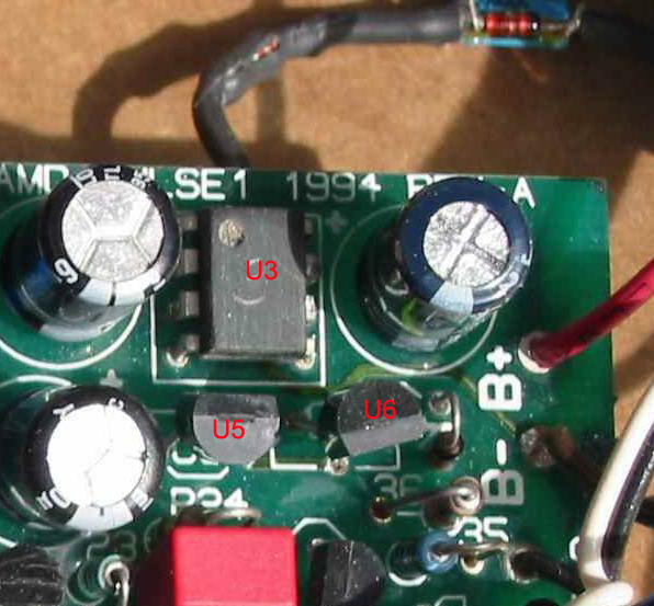

            It can have errors.....? IT HAS ERRORS... Have build the SPINT Layout board now there are some errors in the power part, the 78L05 and 19L05 both must rotated 180 degr.
            Need some more testing, it looks like it is working now ..but the sens. is dropping if the batt voltage is going from 8 to 12 volts... later more...
            Ap

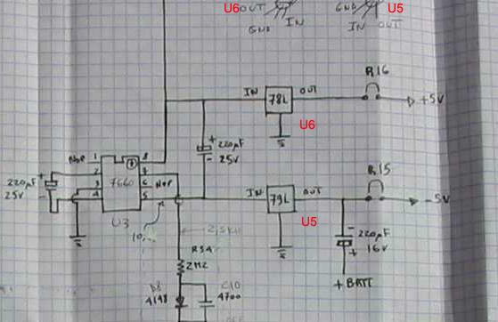

              Yes i foung that with mine it needs 12V for good performance and the error with the regulators is from the orriginal there in backwards there to.

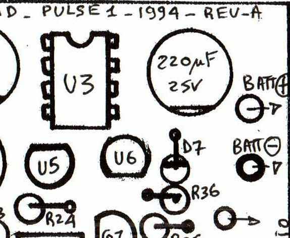

                Hello is right for the regulators sorry i did not see the small layout in your printed circuit , just you need to inverted the transistor like in the Original is OK
                If you print my hand layout in a transparent sheet you can cut and adjust alls the sheets....
                See the photo of the original board is OK the regulators U5 and U6 is good place...
                Also see in the original board you have one bridge for R15 and another bridge for R16 you can put some small resistor in place to stabilize the voltage but i think you do not need when you use nicad batery
                  Sorry i upload the good photo

                    Thanks for update,s it is not your mistake ! I had placed the power regulater and not checked them 100 % ... for good orientation (getting old I think)
                    If I use 8 volt as power supplay the detector is working good.. ,with a higher 12 volt power its sens. is dropping and it gets unstable.
                    I have used for the pulspower a IRF 9640, think that that can be the problem ... to much power...( some 200mA consumption at 12v ) today I replace it by a TIP127 (if i have one) ..

                      Hello Friends,
                      Problem found... wrong transistor at the place from the 2n2222 the detector was working with it .... but gave the voltage problems...
                      Now with a good 2n2222 and the IRF9640 still in place it is working o.k.
                      This is a good beach detector I think, and can be made from very cheap parts !
                      For battery's it is very tolarant, works from 8 to 12 volts.
                      If you use the sprint layout file .. do not forget to turn the 78l05 and 79l05 180 degr.
