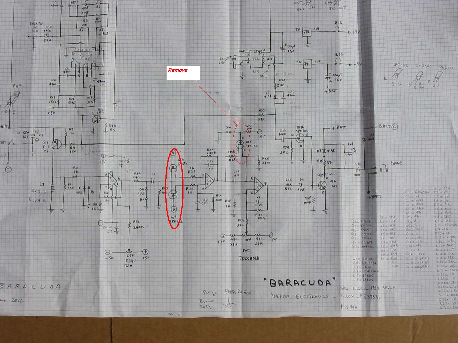

    I bought the kit and I have a problem baracuda you connect and works well for a long beeping minutoluego remains as if you were ever detected
    if someone can help out I would appreciate
    • hello
      I have changed the coil by one of 22 laps with a diameter of 0.40mm and 21 and according to light it is constantly beeping turn it off and back on and always follow beeping
      if you have any idea why this happens tell me something thanks
      • Originally posted by miguelsaen View Post
        hello
        Did you install the pinpoint option? Some of us had this issue. If so, remove Q5.

          • hello dfbowers
            thank you very much for answering
            I removed Q5 and dicer and works perfectly

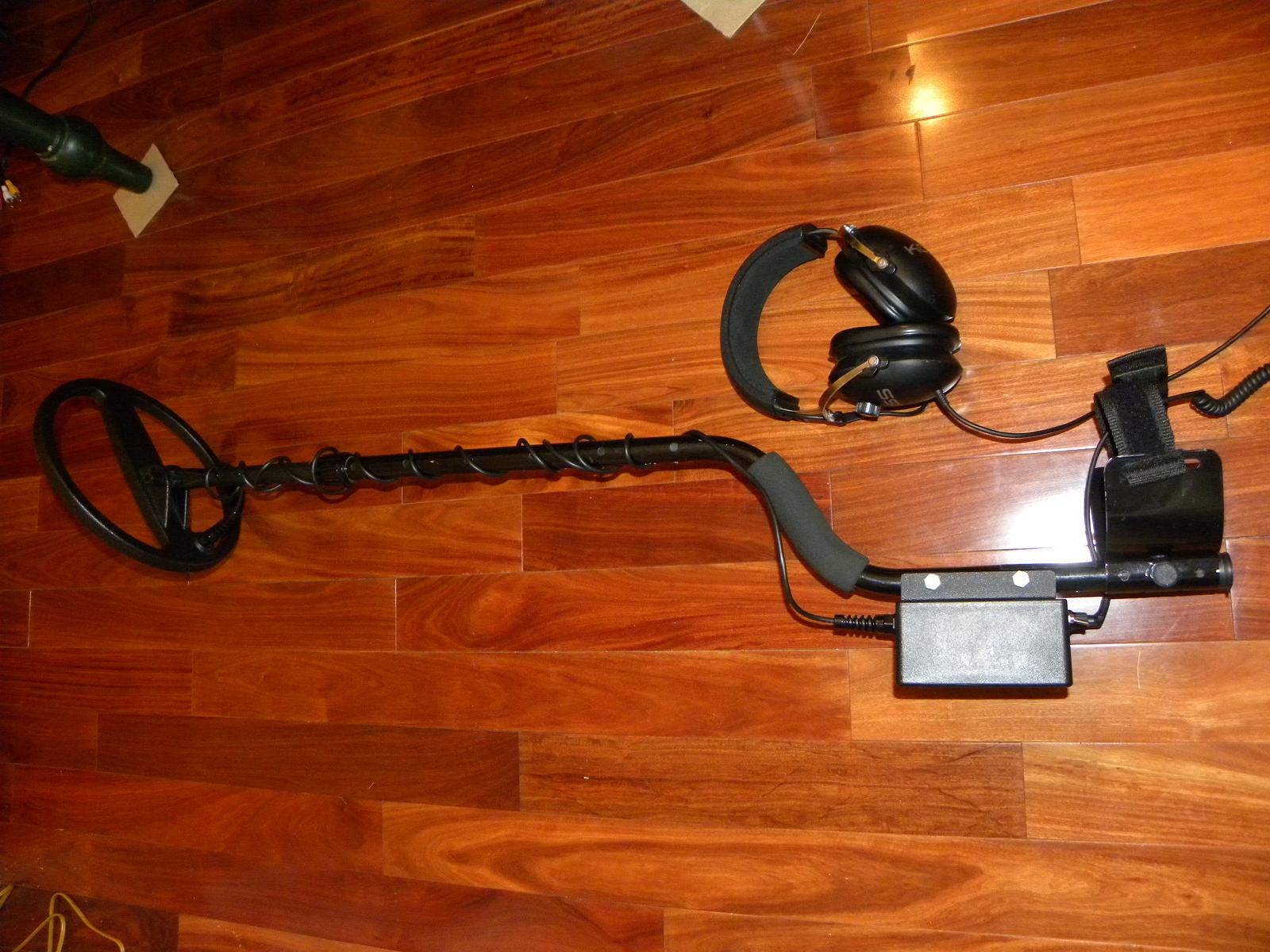

                        • good, I would like to know where I can buy a waterproof case like the photo, or buy cheap Spain, and certainly very good job with the barracuda was doing I decided to get in the water
                            Alexis, nice home work... thanks. I only would like to reminder a point Chris did begin to learn the device from.
                            good, I saw the magnificent Mobile Populations has performed with the barracuda, and do not know if I misread sells the full kit, I would like to buy a kit, shipping to Spain, and if the box can be sealed or where you can get a waterproof case like that, because I was doing on my own a home to put my garret 250, and thus be able to get into the water at the beach, thanks for everything and expect an answer, greetings.
                            • Barracuda project..
                              Well, I finished up the Barracuda project today and took it for a walk. It works fantastic!
                              I did have several problems that I needed to overcome though.
                              1. Point circuit prevents setting threshold correctly (omitting Q5 solves this problem)
                              2. The Barracuda is too sensitive to coil movement (through earths magnetic field).
                              I attempted to replace Q3, Q4 and 1k Ohm resistors with matched sets and the problem got worse!! More sensitive!! The only solution I could find was to reduce the value of R25 (1M Ohm resistor around U2) to reduce the gain a little. This solved my problem completely. Performance is now about the same as the Surf PI project. Oh well, such trade-offs Anyone else run into this one?
                              Don
