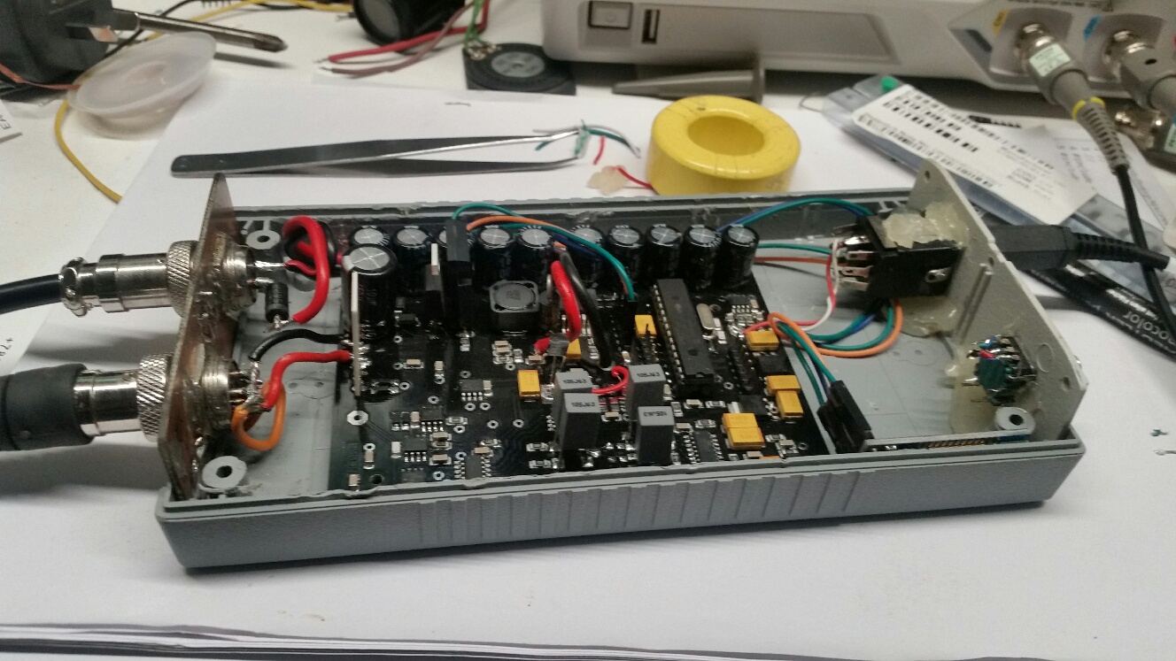

      Thanks Orbit .... next step bench test of coil.
        hard work, good result

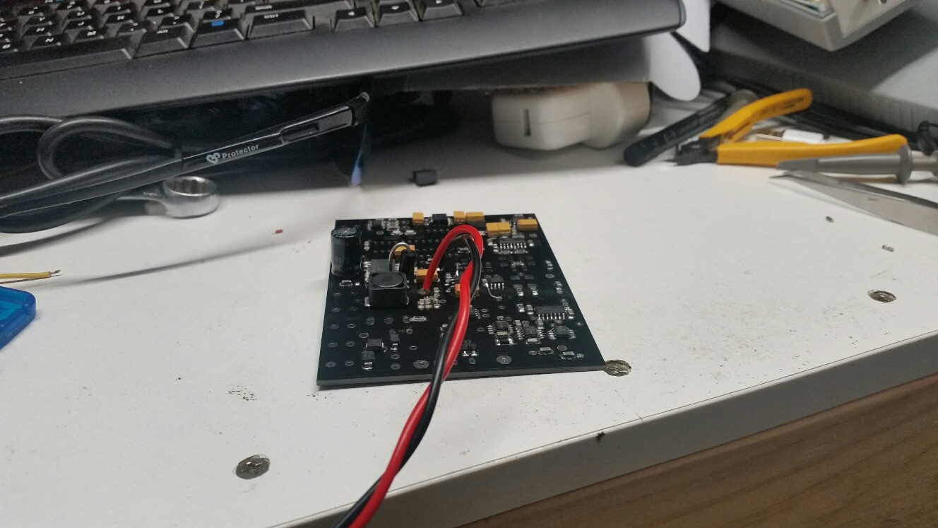

          Thanks bernte ! Board in test box with power and mono coil fitted ... no smoke. LOL ..found two sample pulses crossed over by pcb layout ... swapped two lines of code in CPU and now uncrossed. Next step ... off bench for target tests. Everthing working except digital volume control ... will check code. Board / circuit and code at 99% complete.

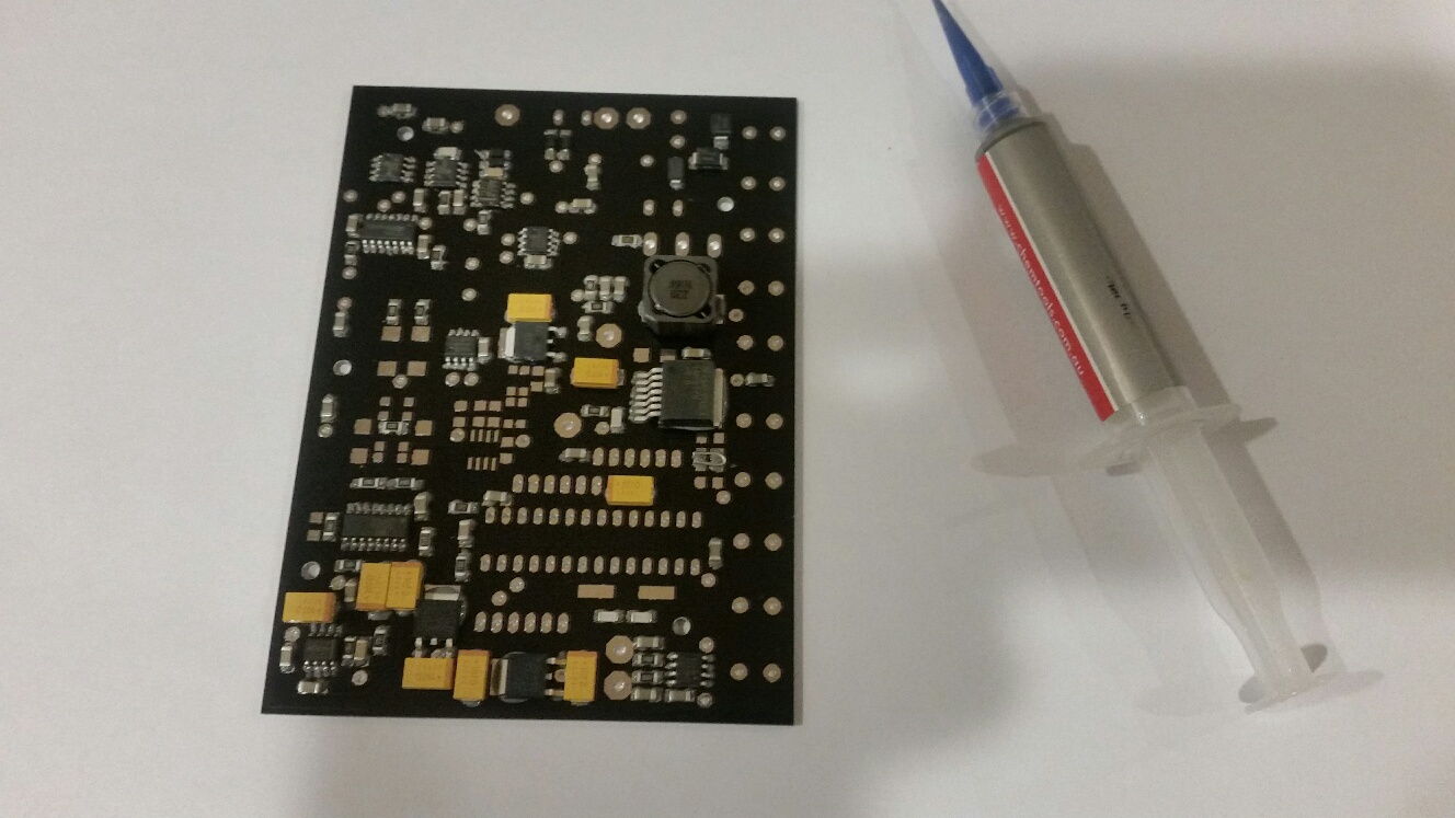

                Do you want bare boards or with parts installed. This is 95% surface mount (1206 sizing).
                Thanks.
                  Personally I would prefer bare boards but some may want board + parts assembled(?)...is it a big deal to sell both types?

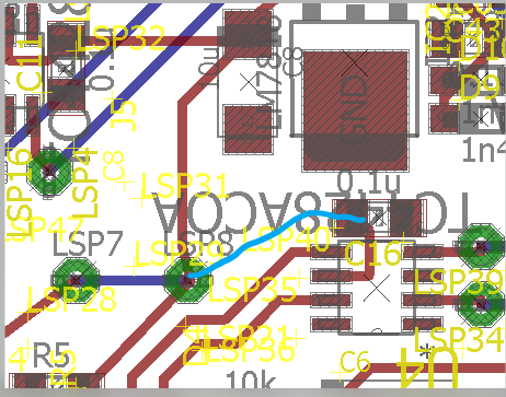

                        Good news it has got a preamp .... I was wondering why my earth field cancellation was not working properly and spotted a missing power connection to one of the sample switch driver chips so I looked at the preamp again. It was working partially but not fully without power connected ...so thanks for that. LOL ... had to solder small link on board.

                          In case of miniature SMD parts I would prefer surface mount presoldered board.
                          It is enough to do with coil and other parts of detector.

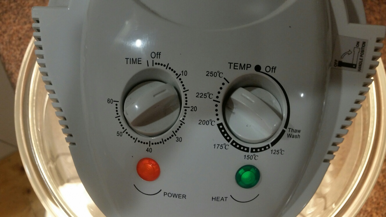

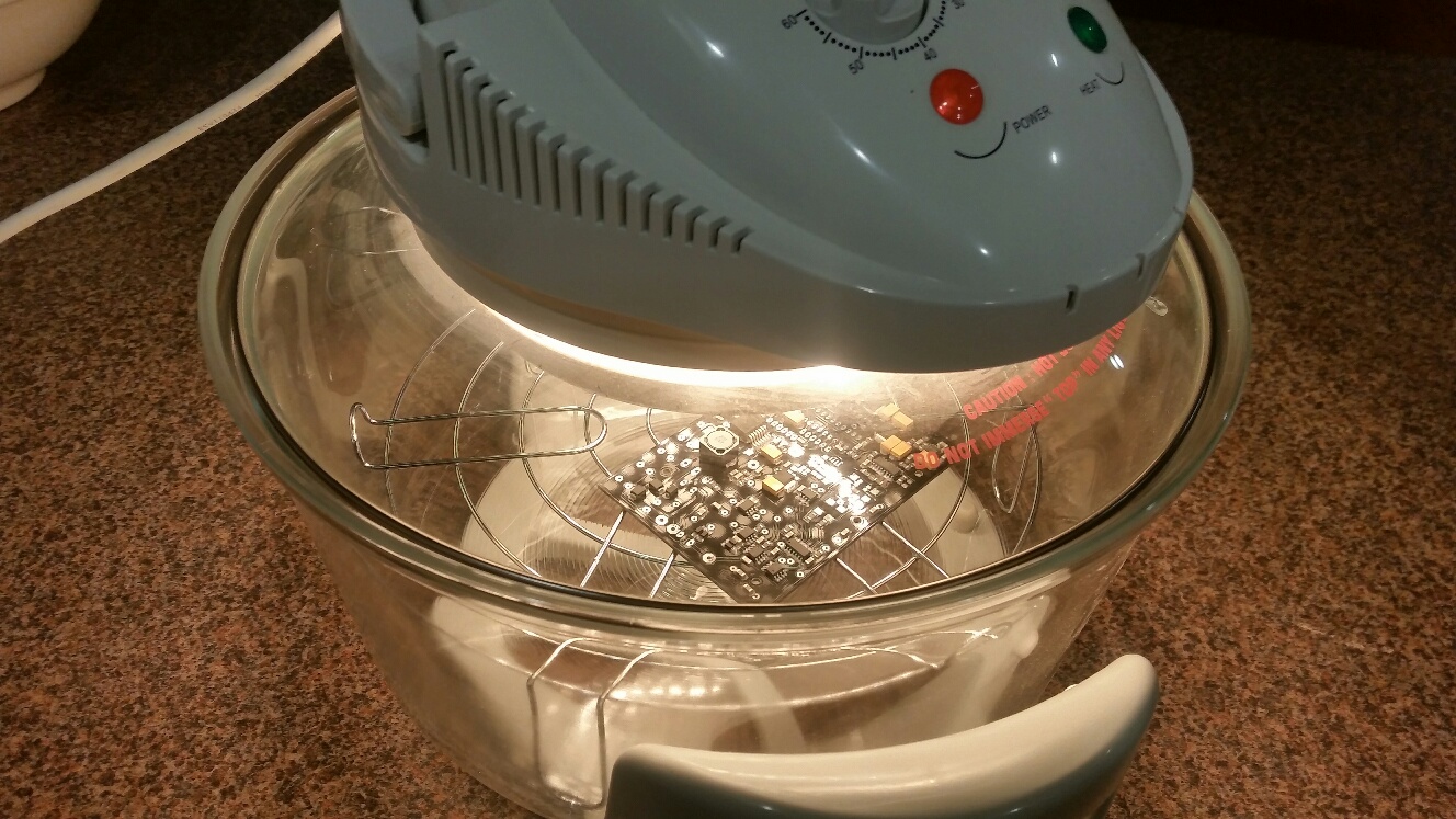

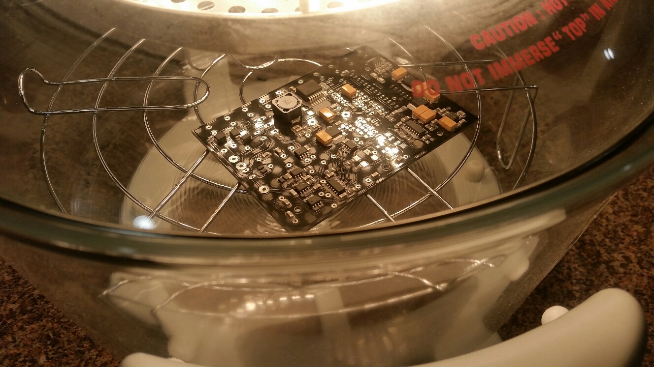

                            Soldering the boards in $29 convection cooker :-)
ID:	350572Click image for larger version
ID:	350573Click image for larger version
ID:	350574Click image for larger version
ID:	350575Click image for larger version
                            Thruhole and heat sensitive bits added later. Pretest on power = no smoke
                              Great! I hope you get tasty crust on it.
                              Can you say some technicals about whole air cooker procedure?
