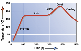

    Step 3. Set timer to 10 - 12 minutes. The oven uses a halogen tube for heating and there is a fan to circulate air so heat is very even.
    Step 4. The halogen tube lights up the interior and you have 360 degree view of your board. You can easily see when the solder "reflows" or melts. The Fan vibrates slightly ... this helps the components to align correctly when the solder reflows.
    Step 5. The timer will shut off the oven ... wait for 5 - 10 minutes for temperature to ramp down before opening or moving the board or you will disturb the solder or heat stress due to fast cooling.

          found a Video on YouTube with same oven, guy wraps the glass Body with alu kitchen foil for better ir reflection
          also he used pid Regulation to drive perfect solder temp curve

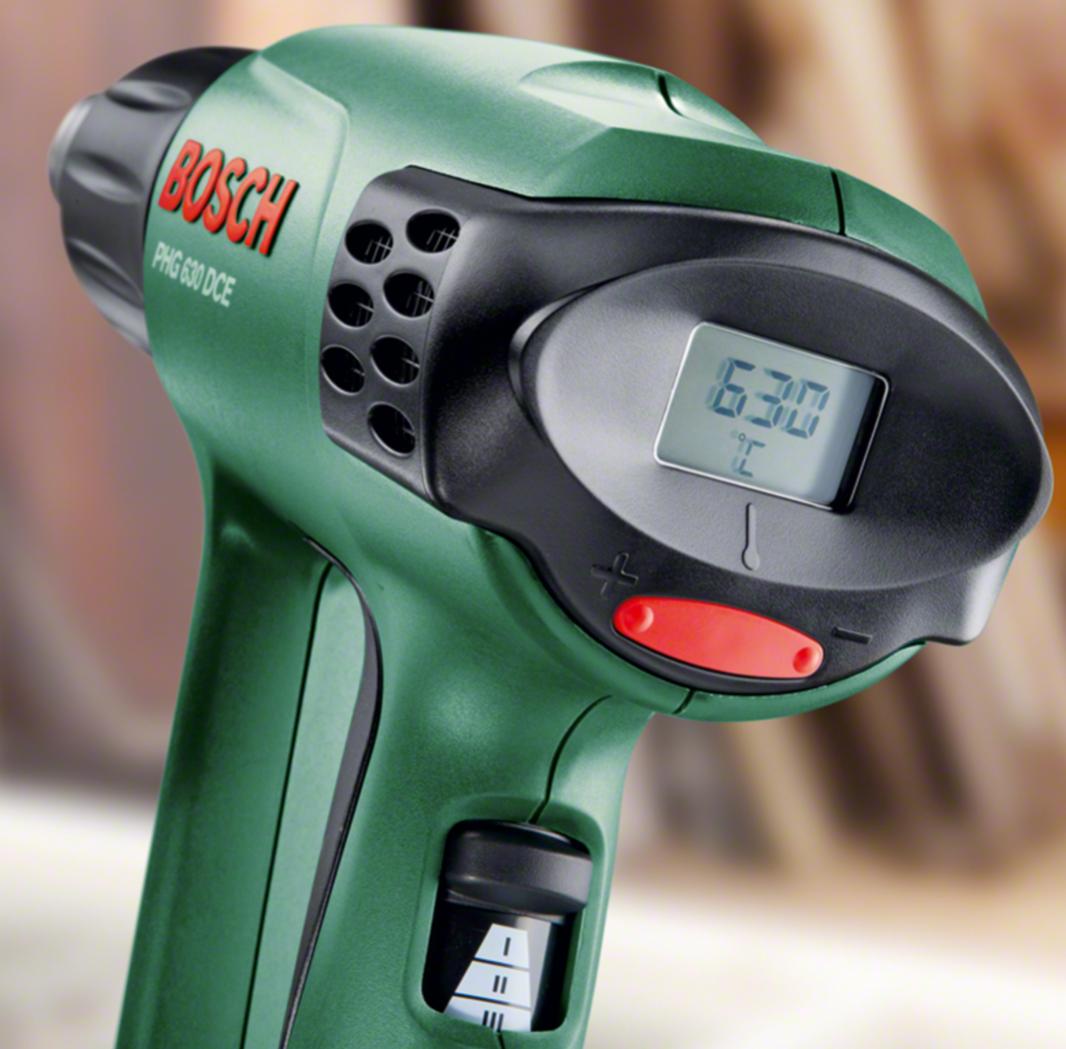

              Hand job solder/desolder reflow with bosch heat gun. Three air flows and continuously variable temp from 50 - 630 degrees C. Noice
