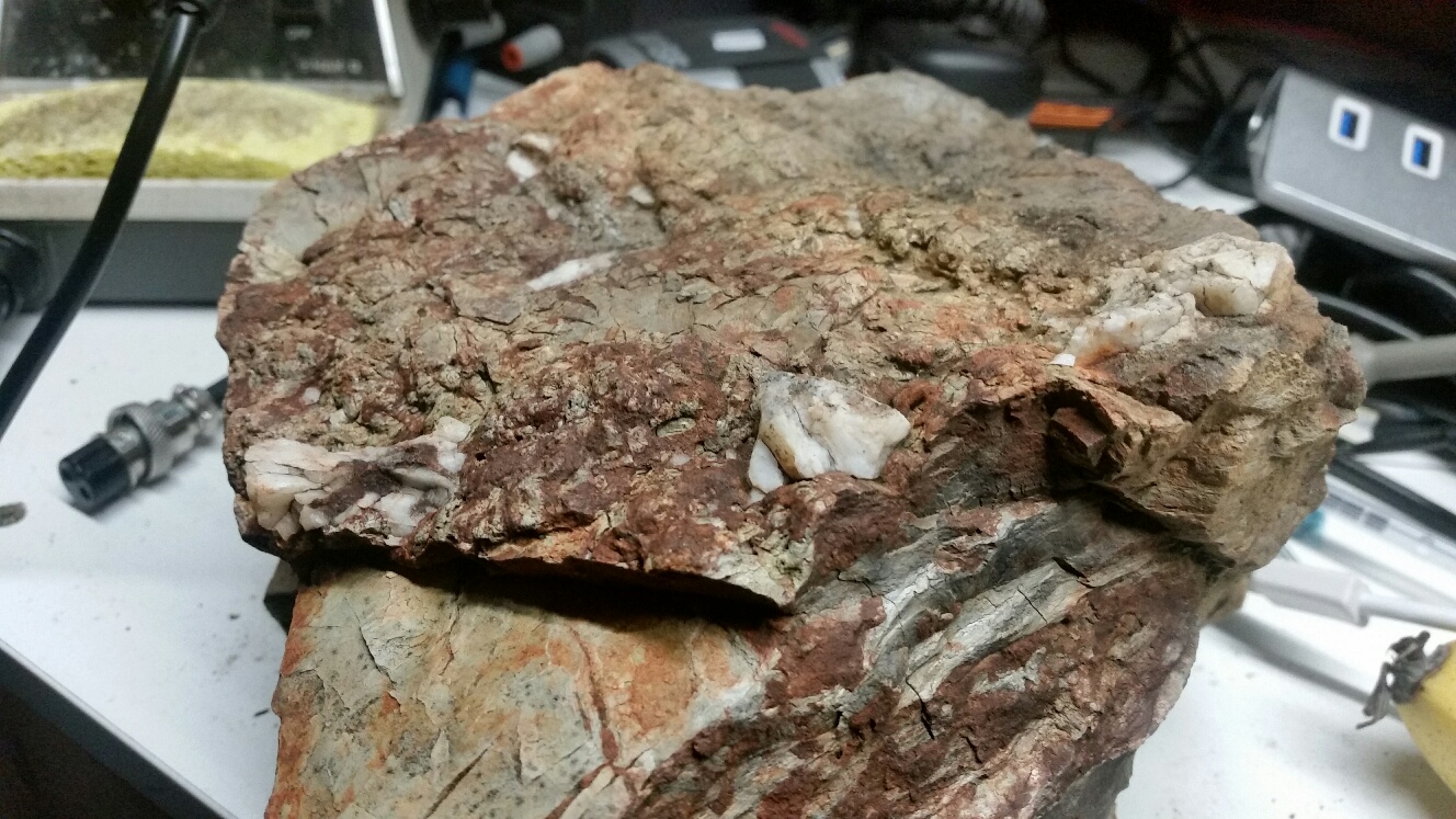

    ..yes .. found this on a reef at 30 cms ... strong signal from a rock composed of sedimentary with a quartz boundary in ferrous matrix. Signal is too localised on the rock for a hot rock .. or it could be a hot rock LOL.
      [ATTACH]42855[/ATTACH]
      Crush and pan to see if there's gold in there.

        Hey Moods , any luck with that rock?
        • #49
          Bullet fragments ....

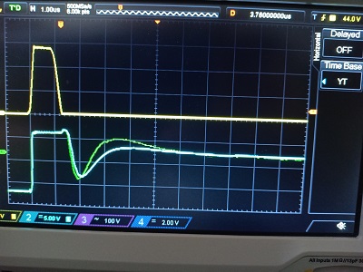

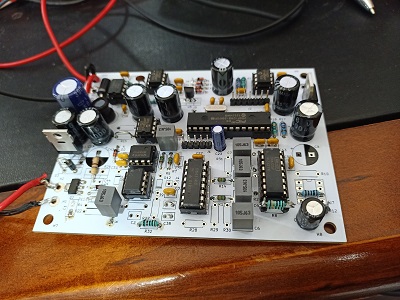

                  ...so having some time up my sleeve and having the PCBs in my desk since two years ago I assembled the MAGPI chip and all the components which are thru hole except for one SMD mosfet ( SOT223 ) and the results are quite good.

                  It is a mono coil Pi with 300uh coil / 0.5R and a peak flyback voltage of about 250 volts and sampling at about 3 us ... the green trace is a 1 inch foil target on the coil at the o/p of the preamp.
                      Excellent!

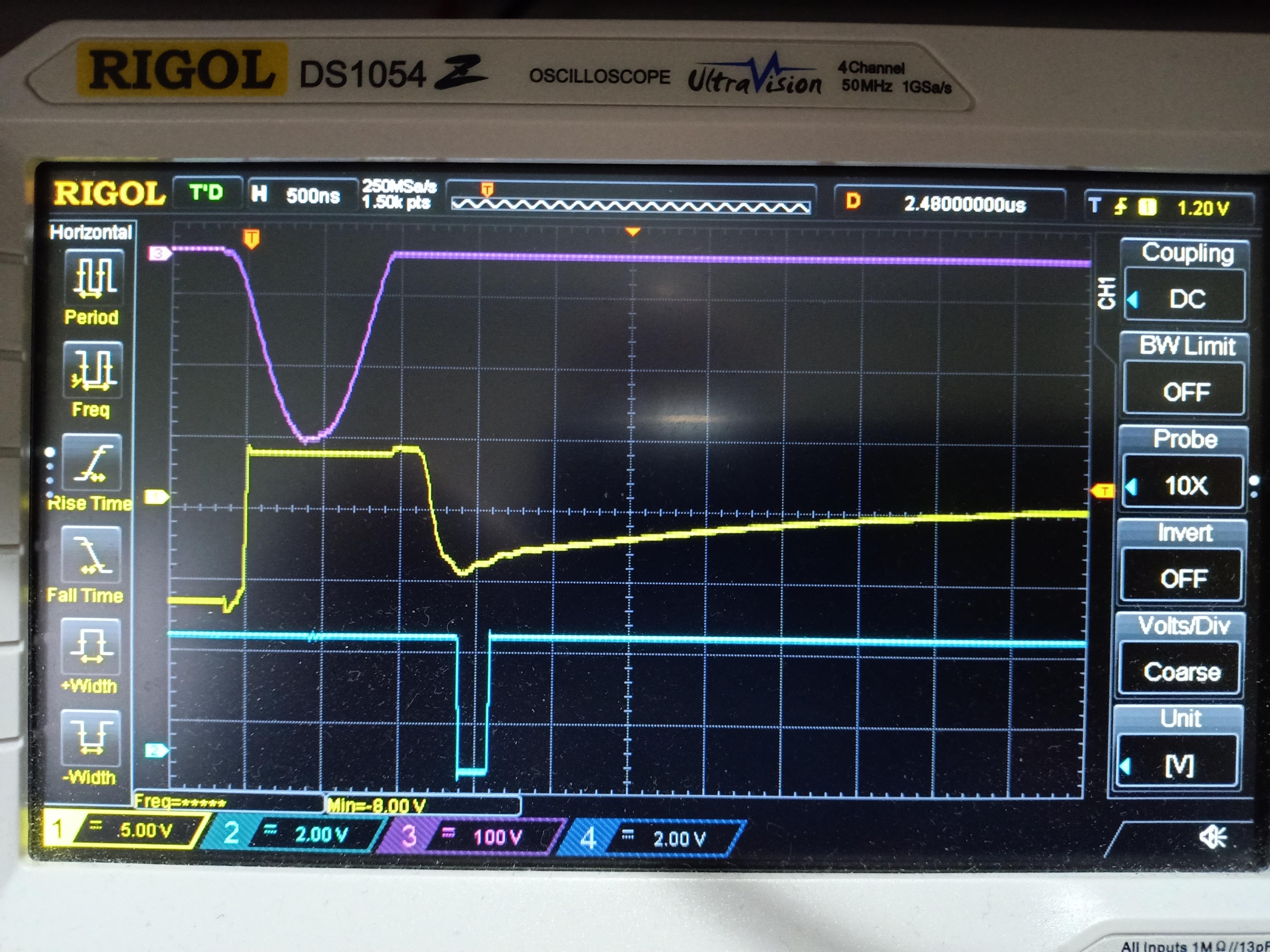

                        ..improved the active damping time to 1.5 microseconds.

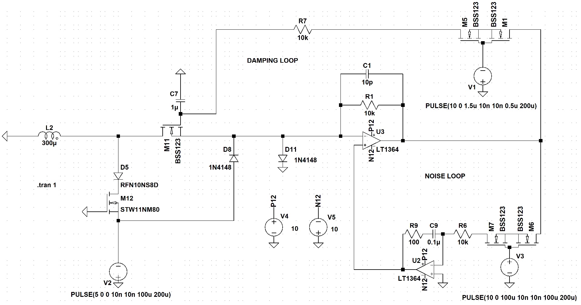

                          Magpi V22 release.
                          After a long time in the nest ( due to slackness mostly ;-) ) the magpi egg has hatched.
                          Attached you will find the schema for zero point damping PI for mono with nested noise cancelling and damping loops.
                          The damping system uses a transimpedance amplifier as the main loop amplifier and there is no damping resistor as such ( in the conventional sense ).
                          The secondary nested control loop cancels noise ( eg mains 50/60 Hz and mag fields etc ).
                          There is also a pcb and software and I will shortly post up some sims to play with.
                          moodz.

                          • #58
                            Here is the PCB top and bottom ....
                            All through hole .... ( except for one part ) ;-)

                                ...sim for the ZP damping.
                                note: this is for NMOS ... the MAGPI22 is built with PMOS ... however it demonstrates the principle. :-)
