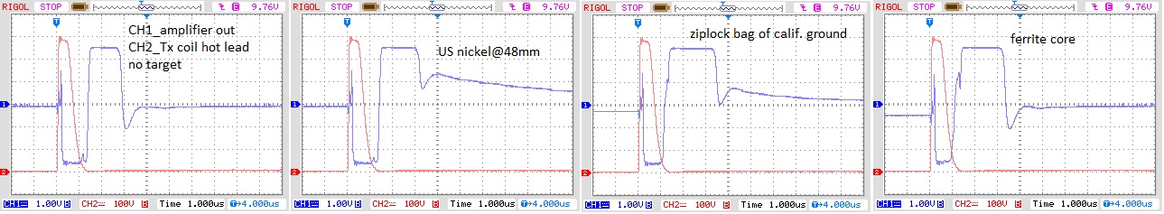

    Back to playing with the unipolar circuit. Added a 7V Tx supply so Tx signal would stay the same as battery discharged. Interested in what others see when using ferrite as the target with their detectors. I have been using a toroid core about 25mm diameter. I have tried other cores similar size and bags(around 10 cores)with smaller cores with similar results. Thinking ferrite target should be X signal with very little if any R signal.
    Tx_328uH 4.2 ohms, Rx_133mm fig8
    Haven't given up on bipolar yet but so far unipolar is winning for me.

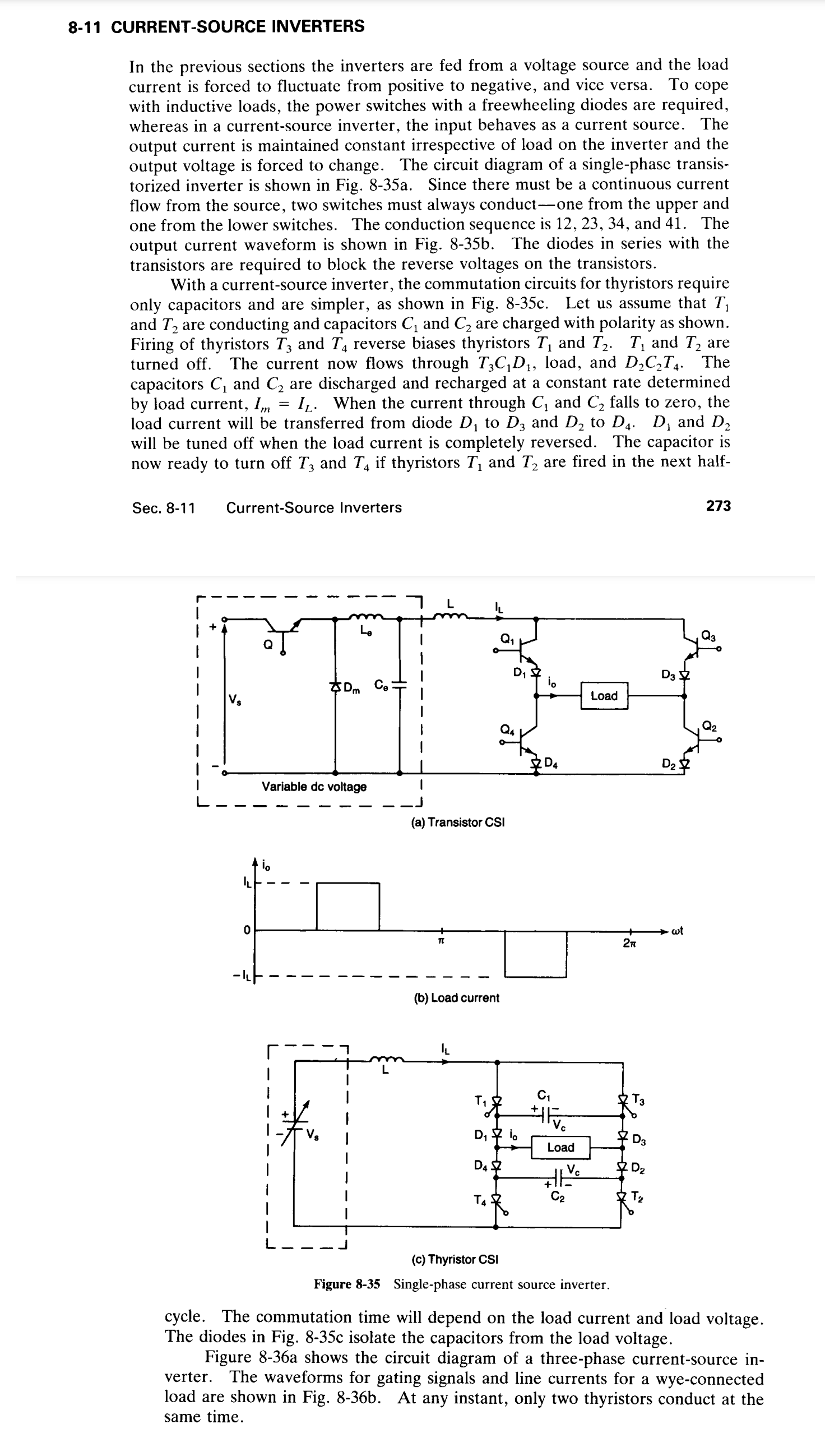

      The key in those circuits is the supply. It has to be a constant current source. Then both the standard H-bridge and moodz circuits work. I've been playing for a while with a standard H-bridge powered by a constant current constant voltage module. Power consumption was OK. However the current pulses were not completely flat-topped but I was using a high inductance coil and didn't measure the A/sec rate. Seems that a lower inductance coil is better. Still have the circuit laying somewhere round here.
          The key is NOT the supply. A constant current source has a high source impedance and cant be used in this application. The detector coil ( and associated magnetic field ) is waving around in the air anyway so the motion ( acceleration / deacceleration ) is more of an issue.

            Some refer to this as a current source inverter. For example see attached extract from an old book on power electronics. Another similar concept with some improvements is presented in the second PDF paper attached.

              I had a look at your references ... The h bridge is fine for non inductive loads but I think you are not going to get CC pulses in an inductive load ??.
              The second reference PDF is interesting for allowing the pulses to be spaced by off periods however the pulse tops show a clear tilt ( ie not constant ) so this scheme is not better than what I proposed. ( and the pulse rise times will be impacted by storage of energy in the switched cap )
              The main aim of my proposal is to generate pulses at relatively high current int the TX coil with minimal supply requirements ( eg 1 or 2 volts ). The main criteria is that the rise times of the pulses ( di/dt ) is much greater than the dwell time ( di/dt).
              DSP in the RX coil takes care of resolving target information. You can achieve CC operation with a compensation network ( in 100us the current changes by just over 1 ma ) However because the coil of a metal detector is in random motion over the target a fixed field ( ie true CC ) is a moot point.
                  Well.. it's been quite a while since I played briefly with those circuits. I've tested the H-bridge circuit with a capacitor across the load (coil) and it works but pulses are not quite flat-topped.
                  Yes, I suppose this circuit won't produce perfect flat-top current pulses too. The capacitor however is charged by the coil flyback voltage and then this voltage is applied to the coil for a faster rise time. Authors claim they got faster current rise times this way.
