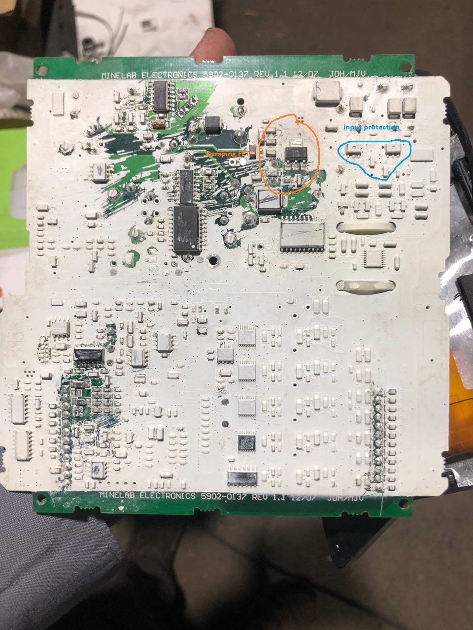

    Just checking the specs for the SOT-223 FET its good for 3.3 watts of dissipation at 25 C and 2.25 watts at 40 C .... that is good for 2 amp peaks in the TX coil - but I dont go near that ;-)
    moodz
      ML uses these small FETS as blocking switches they are not damping any power. ( As far as I know ).
      moodz.
      what I meant by that was this one:
Name:	photo_2022-05-24_23-45-36 - Copy.jpg
      they definitely do active damping with a FET in parallel to the coil or something like that, otherwise, how they get rid of the coil energy, some of it goes to the clamp regulation chain but there is still a lot remaining.
      A few hours ?? not sure what you mean here ... the TX voltage is regulated
      I meant to say what if the TX voltage is Not regulated?
      because this TX voltage regulation is not a jelly bean task as you have to make sure there is always a high level of efficiency And very low noise obtained.
        it’s possible but if they were doing the same as the method I am using you don’t need the input protection switches and if they are using bipolar pulses a single damping feet won’t work.
        the tx voltage could be unregulated and compensated for voltage variation by the cpu etc I just haven’t done it that way. If it was done that way you could get more efficiency from the batteries. With the cheap linear regulator you can still get over 10 hours from a couple of 18650 cells. This design is a an easy to build demonstrator that is still very effective.
          yes, that feature of yours, it's much cleaner, I tried those clunky switches once before, but didn't like them, bad THD at the beginning and some degradation of performance, they push the delay away...
          do they? I didn't expect them to use the bipolar method
          so what do they do? any patents
          I'll try your idea, but perhaps not with a TIA, I rather let the RX current go through a resistor and measure the voltage drop with a voltage amplifier, this way I won't get the slow decay at the end of the flyback.
          then after the first amp, I would invert the wave and sample for the loop there.

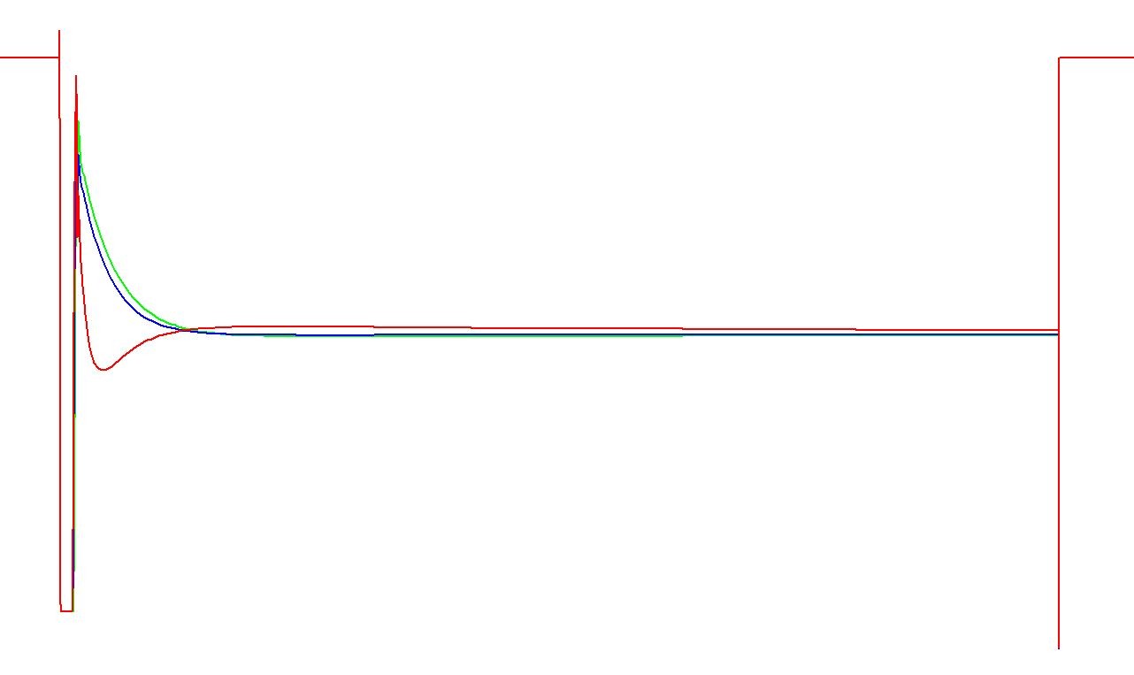

                              Yesterday I took the detector to the beach went up to the waters edge and found half a dozen bits of metal rubbish in 5 minutes ... so it works fine in salt water / sand.
                              As for your other concern ... a picture says a thousand words.
                              Look at the PIC below ... the blue trace is no target .... the green trace is large ferrous VRM ground and the red trace is small gold coin near the coil ( 50 mm distance ).
                              Take particular note of the where the zero volt reference is the polarity of the responses and also how the voltage level does not return to zero volts.
                              The coil is damped in 1.7 microseconds.
                              Its should be clear that there is a clear signal distinction between target and ground :-)
                              moodz
                                VRM is magnetic right, so you say the idea does not detect any magnetic response, for example only the conductive property of iron can be detected but no magnetic.
                                There are two magnetic responses: instantaneous and viscous. PI detectors normally ignore instantaneous magnetic responses (ideal ferrite) because it dies faster than the decay. Viscous magnetic responses are time-delayed decays so they are not ignored. But the decay curve is not exponential, it is t-n where n is typically between 1 and 1.1. This is what the 2-point subtractive GB removes. I suspect that ZP damping doesn't change this at all.
