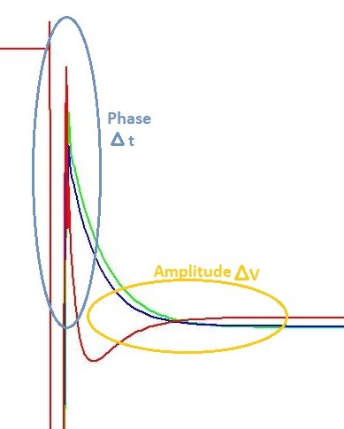

                Hi Gents,
                While I am still digesting this thread I wanted to let you all know that several years ago when I built some PI prototypes I noticed the exact pulse shape which Moodz is showing.
                The very fact that what it appears is a negative phase shift was intriguing to me and made me think about the potential for discimination.
                As you can see from the edited picture below there are two portions of the return signal that need to be considered Phase and Voltage.
                The reason I suggested using a high speed MCU like the ESP32-S3 is beacuse of its 240MHz clock. Such a high speed clock provides 4.16 nano seconds of timer resolution.
                So the idea is to use a high speed timer to sample the phase and a seperate ADC perhaps to sample the Amplitude.
                I wonder if anyone else has had these thoughts also..?

                      Hi Dean ... excellent idea however you realise that I was illustrating the "exclusive" view of responses. In reality you have the passive ground combined with the VRM ground and targets / hotrocks etc all combined together giving a combined response signal ...what is the base reference signal ??
                      The target you dont want and cant resolve is a very faint signal from say a meter into the ground and when you dig it up it is a beer can ( spent half a day doing just that ).
                      But there might be a solution ... story for another day ;-)
                      moodz

                        Hi Moodz,
                        When I was evaluating the flyback I noticed that the phase was typically negative for gold but poisitve for iron so would assume that the beer can would provide you with a positive phase response not negative.
                        This is also evident in the response in green compared to the no response in blue.
                          What I meant with the weak target ( beercan / gold etc ) was that the shift would be so tiny for deep targets that I would have to dig half way towards it before getting a strong enough signal to resolve a shift.
                          moodz

                            I also noticed studying the flyback the majority of the phase shift is at a much higher threshold voltage around 10 to 30V well above the regular 0.6V diode limited response of typical front ends.
                            In order to measure the phase I have been simulating a high speed high differential voltage comparator to be triggered at the higher threshold voltage to provide the phase shift data as well it provides for an auto threshold mechanism.
