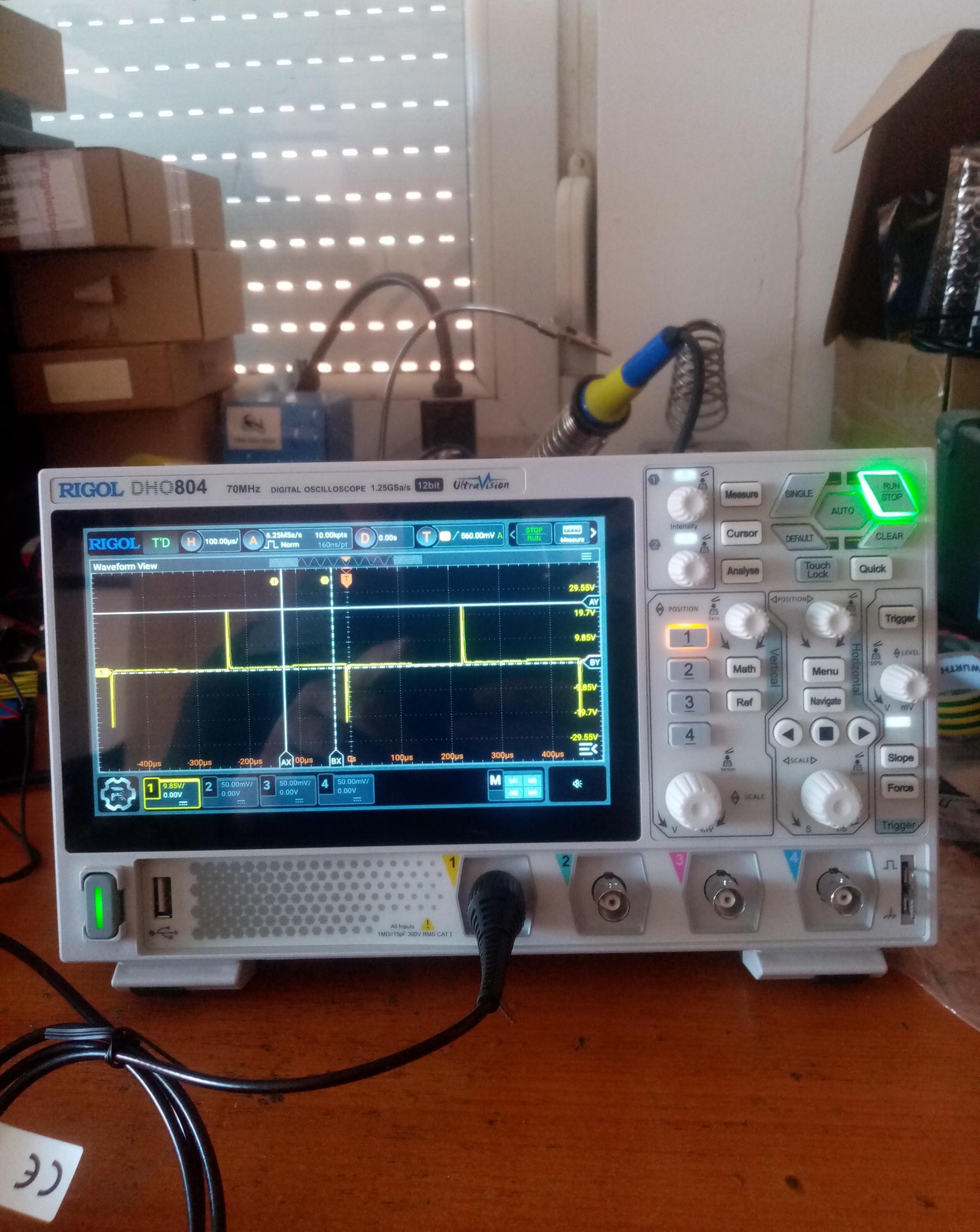

        looking at one of the mosfet gate drives and the raw RX signal.
        Blue = no target.
        Orange = Iron
        Green = aluminium
        No amplification. Pulse rate = 10 khz. ( Scope says 20 khz but there are two magnetic transitions per cycle )
        Even though the mag pulses are bipolar the RX signal come out as unipolar ... which is nice.
        I cant really post a youtube as there is a factor of demonstrating features in the public domain that are the subject of patents.
        Click image for larger version  Name:	image.png Views:	0 Size:	1.64 MB ID:	448119​

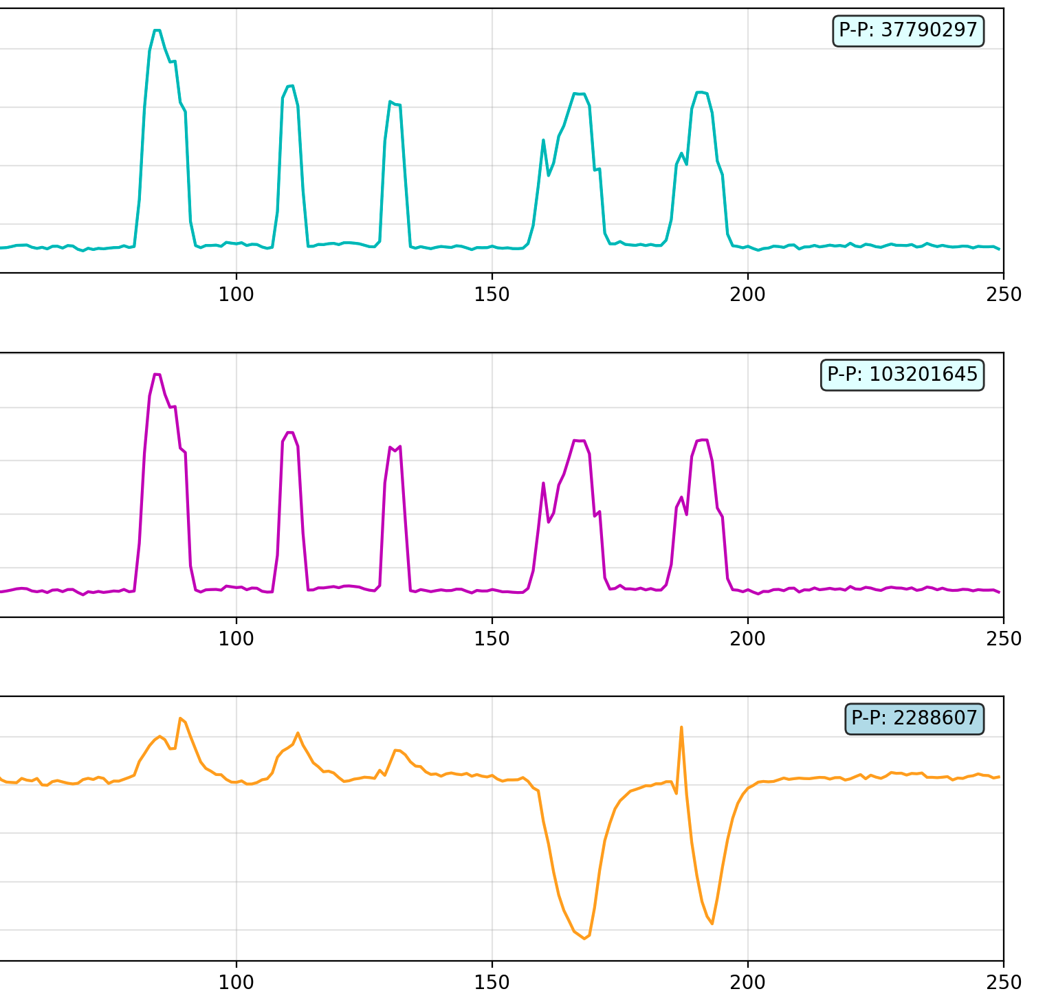

                          Just to prove the point I tweaked the earlier code I use on the E class transmit ( using an IB coil in that case ) ... and now we get the discriminating monocoil TEM with GB
                          What we are looking at below is channel 1 and 2 ( virtual DSP channels in the software ) showing target responses and virtual channel 3 is the GB balance channel but also once balanced responds with Fe / Non Fe info. ( +ve for non iron ... -ve for iron ... no response for ground )
                          The response are not as strong ( its a cancellation channel after all ) in the GB channel but we only need the sign of the signal to disc the target.
                          There are 3 non iron targets then two iron targets.
                          This is not a simulation ... its straight off the test platform.

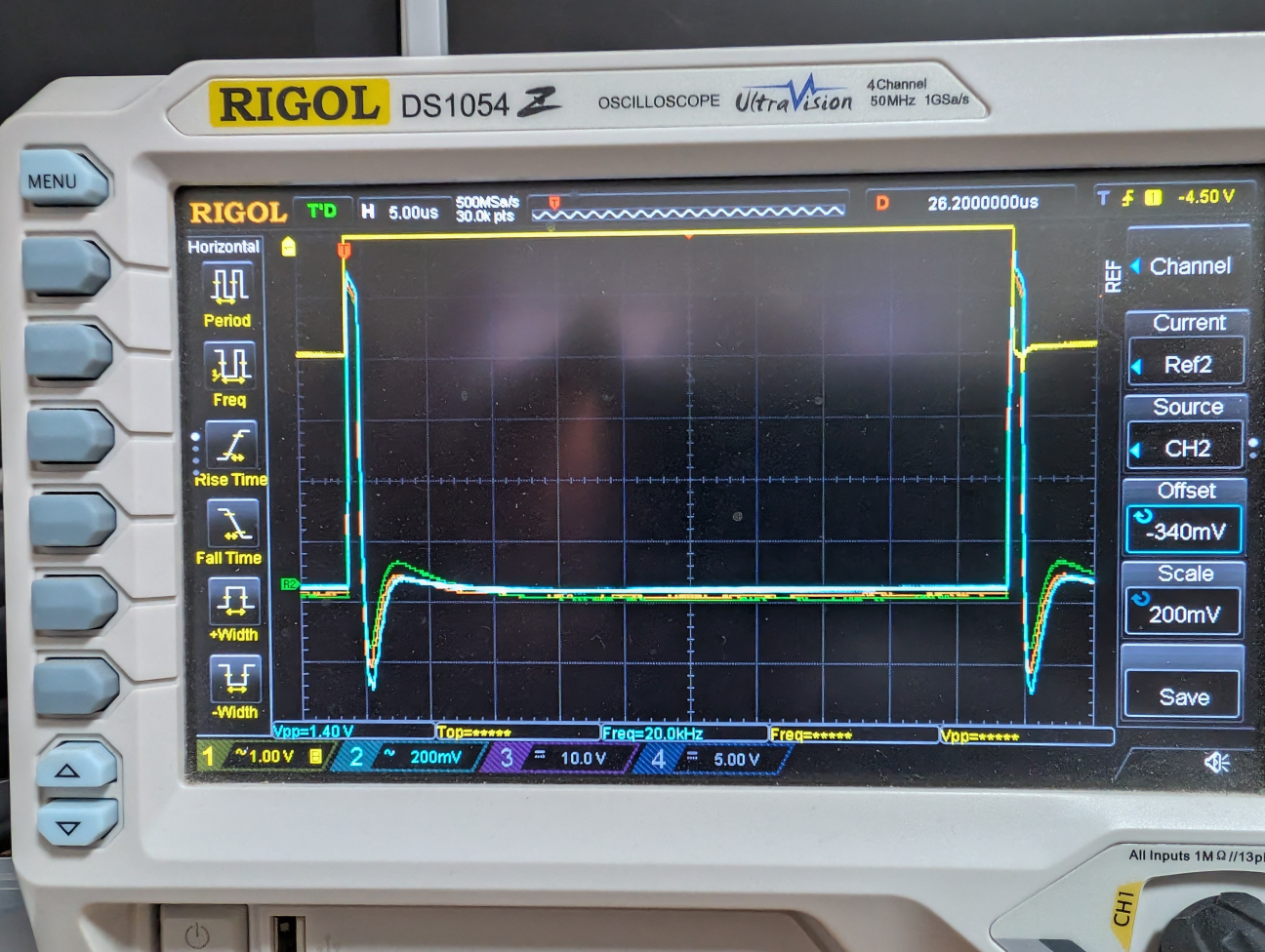

                                Lots of work on this lately ... The TX and the RX required some tricksy circuit wrangling but getting really good results now. I am using a 45 cm mono coil 300uh and 0.5 ohms basketweave. Full damping in 0.9 microseconds. Flattop pulses are better than 20 uA tilt factor at +/- 1.1 Amps and 750 volts flyback...the circuit is built with 1200 volt MOSFETs but I didn't go there yet ( tx supply is 3.3 volts .... 5 volts would be nearly 1200 volts peak ). The TX can be any frequency from 4 to 100 khz.
                                The front end amplifier uses a compound structure to achieve a gain of 1000x using 3X LME49990 .. ( opamp may be obsolete but hard to beat 0.9 nv noise ).
                                The current "tilt" at 32 Khz is approx 1 mv over 13 us seconds on the 300 uh coil ... this equates to 22 microamps so its pretty flat which is fairly good for a 1 amp pulse. ( dont get too excited though .. over one second the tilt is around 3 amps )
                                The tilt is important because if we have too much its going to limit the gain of the frontend before it overloads. You cant realistically achieve 0 tilt ... you just need to manage it so it does not overload the frontend amp.
                                In this case I have managed to put a 1000x amp on what is essentially a PI and in the past I have never put more than 30x - 100x on the preamp an sampling under 4 us on a largish coil.
                                Below is the rx signal before and after gain ( x1000 ) in relation to the gate drive.
                                The ADC wants something in the range of 3 volts PP so 1000 gain works here and we are sampling less than 4 us even though the coil is 45 cm diameter and relatively large.
                                ... and here is the important bit ... a mono coil that transmits and receives simultaneously is inherantly balanced ... think of two coils occupying exactly the same space but connected so they cancel except one of the "virtual" coils is used for transmit and the other for receive .. both at the same time. Because it is inherantly balanced ..... a ferrite near the coil causes an equal effect in both "virtual" coils and because it cant get "between" the coils ( they are the same coil ) it cant unbalance it. A large ferrite even if placed on the coil will distort the magnet field and change the inductance of the coil but it will produce NO target response because the coil balance is not disturbed. ( in this method ).
                                Another way to think about it is to consider a coil carrying a constant current if you place a ferrite there does the current change ?
                                Answer = no.
                                So all the ferrous "response" will be in the transitions .... and it there is an affect here and we can measure it ... thats another story.
                                Theres some maths there ...
