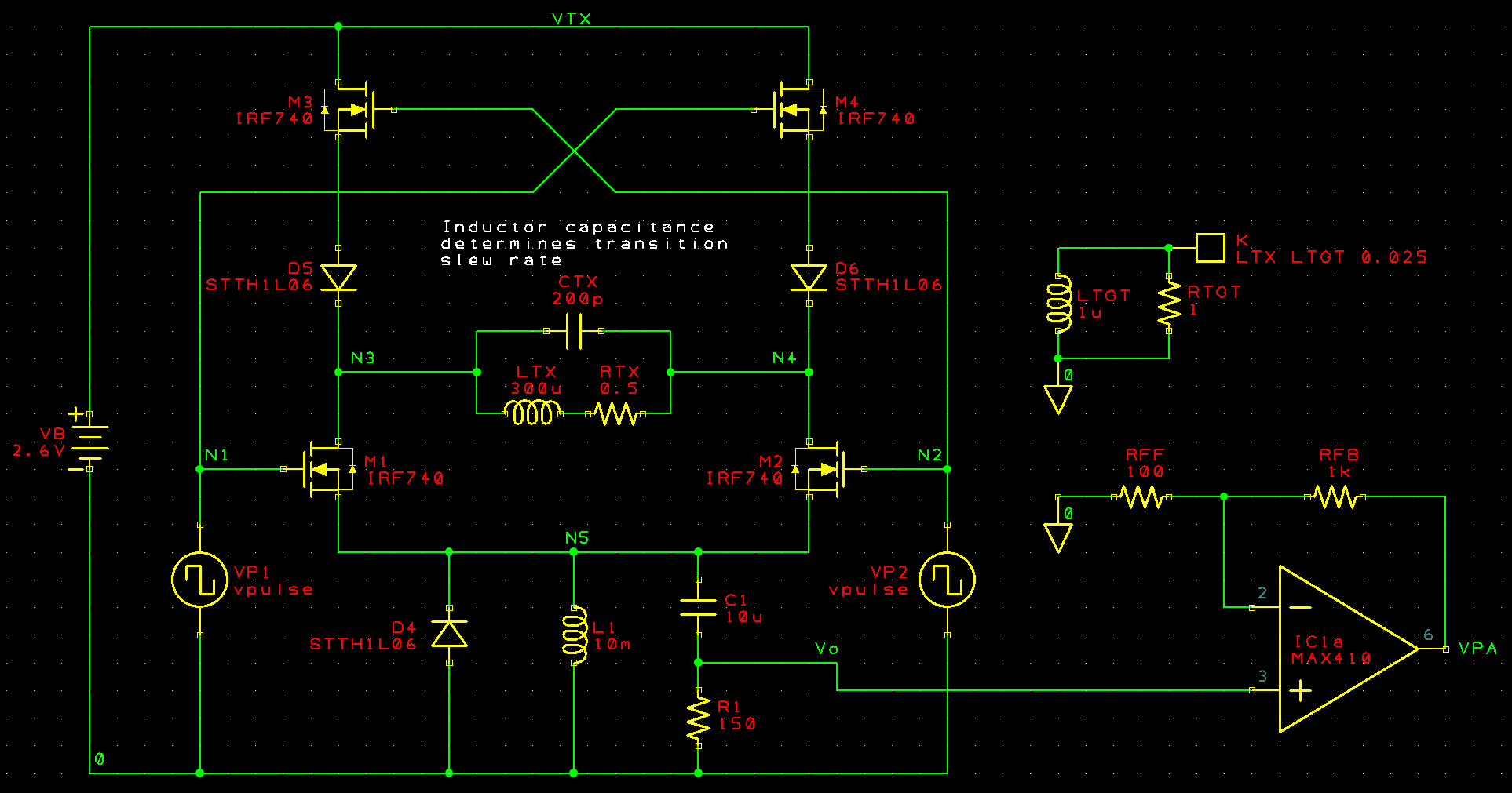

A Single Coil TEM field metal detector with simultaneous transmit and recieve.

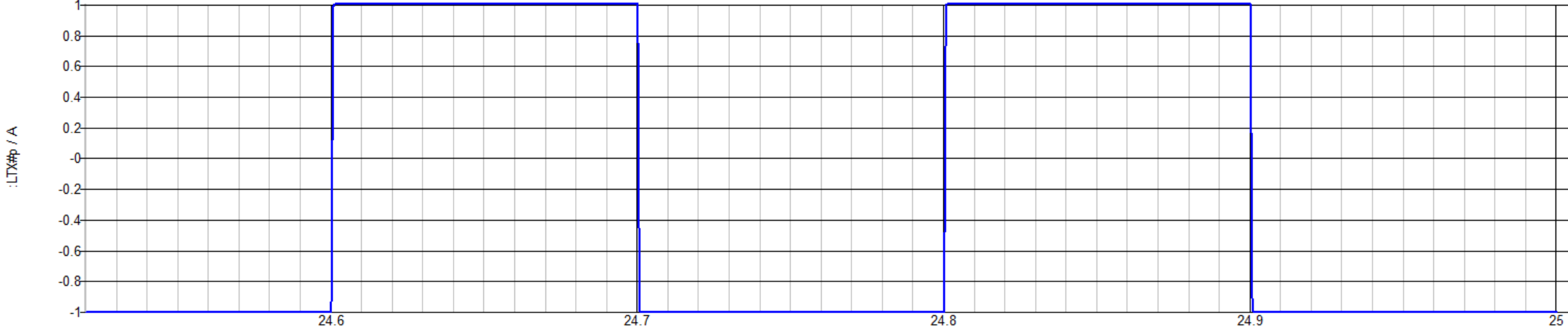

    I did some sims on this circuit and it looks really good. I set the voltage (2.6V) to produce a +/- 1A drive current:

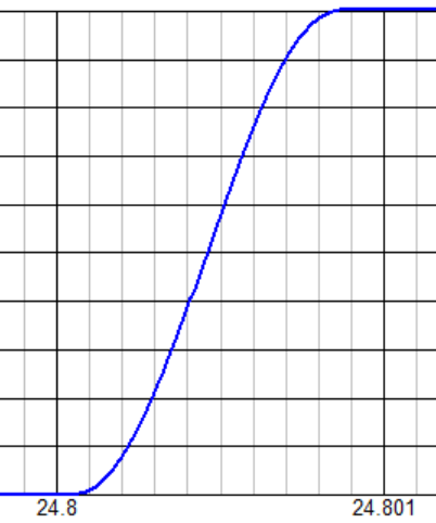

    Coil is 300uH with 200pF and 0.5Ω. Transition is the expected half-cosine:

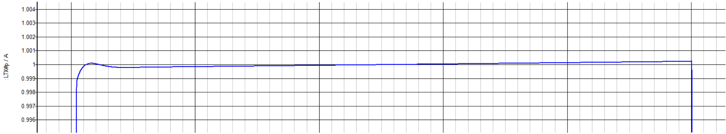

    Here is the flat-top region of the current pulse:

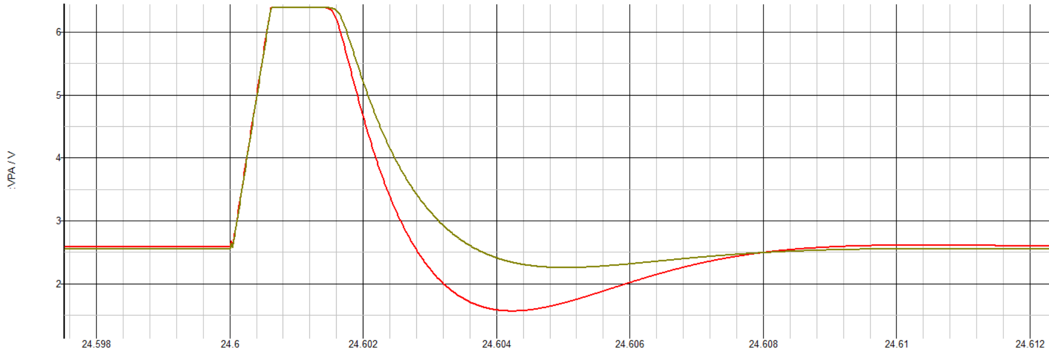

    Looks like 0.5mA/A for a 100us pulse. I suspect this entirely controlled by L1, which is 10mH in my case. Much better than the uncorrected Minelab transmitter.

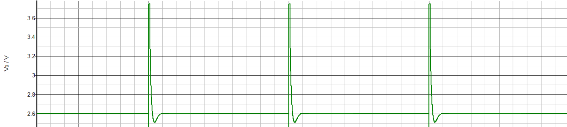

    Experimentally I found that R1=150 provided good damping and C1=10u minimized droop:

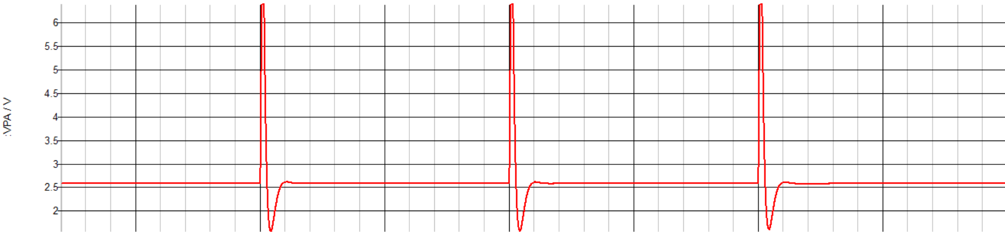

    I then fed this to a modest G=10 preamp:
    Here is the preamp with a 1us target imposed:

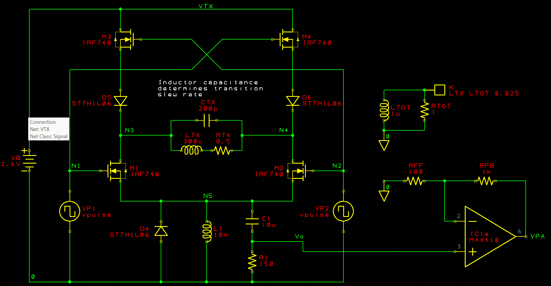

    Here is my schematic:

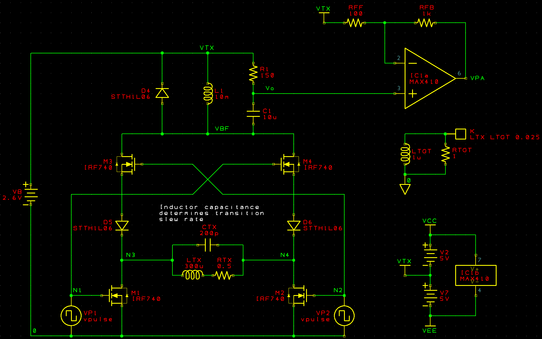

    The preamp ground is (by necessity) referenced to VB=2.6V. Offhand, I see no reason why the circuit cannot be rearranged to place the current source & output on the bottom so that everything is referenced to ground.
    Paul gets another A+... clever, practical, simple, and efficient. The nice thing is, I think I can easily modify the CCPI driver in AMX to use this.
      Yep, this works exactly the same, but now the output is ground-referenced:

        Yep, this is also very nice. A+ for you too.

          Thanks Carl for this analysis. You got almost the same experimental damping values spot on ( I used 10uF and 140 ohms ).

                  Probably yes. The output of this new scheme* hits a hard limit during the transition due to the diode.

                        The famous "tilt" on the transmit pulses is proportional to the impedance of the current source. Use a better current source and you will get less tilt.
                        If the impedance of the current source is too low the DC voltage from the current source supply "leaks" through the current source and creates an LR charging curve with the TX coil during ON time .. this is the tilt.
                        The impedance of the current source needs to be higher than say 100K for tilt cancellation. ( actually it does not cancel ... it reduces )

                        I get less than 16 microamps of tilt across 100 microseconds -- in fact its becoming hard to measure.

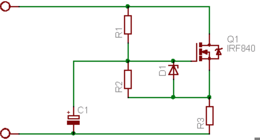

                                For magic chokes we will use something like a gyrator to replace the inductor.
                                The circuit below is an example ... it directly replaces the inductor.
                                The inductance is proportional to R^^2 x C ... so its very easy to make "inductors" of several henries with very high impedances.
                                The downside is that you lose more power than with a simple inductor, the upside is that you have lovely untilted pulses.
                                PS This is not magic .. the gyrator was invented around 1948.
                                PPS the patent claims cover its usage.
