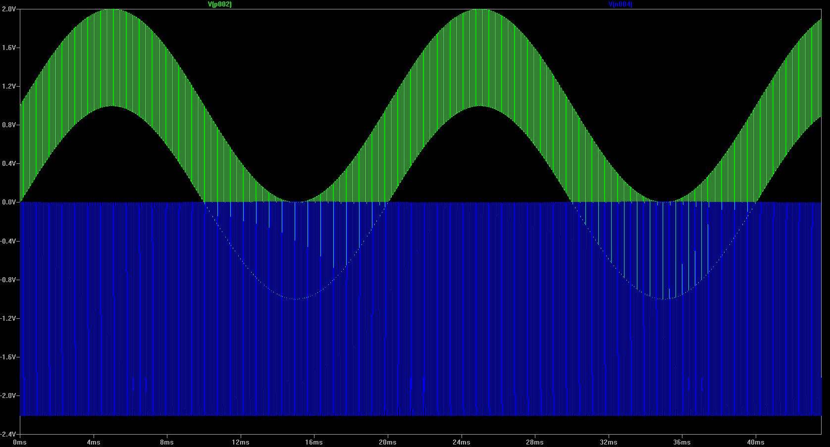

                          The performance is excellent .... been doing some optimising of the Earth Field / Hum removal on the front end gain block.
                          Pic below shows pulse train with severe 1 volt peak 50 hz hum superimposed. After passing through the EF removal prototype gain block ( its not your average amplifier LOL ) I get the pulse train with no hum ... actually if you look very carefully there is some residual ... however the pulse train has been gained up ... the hum has been severely attenuated/removed ..... The green trace is the input ... the blue trace is the output ..... there are some DC offsets ... cant have everything.... its all DC coupled and not a capacitor or inductor in the circuit ( or diode for ppl thinking this is some sort of clamp cct )
                          UF .. you can have your capacitor back now.
