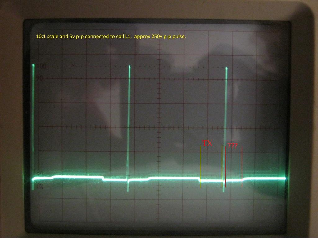

              Hi Paul, here are the extra shots I tool with out the blocking fets.
              • #82
                hmmm ...
                Mick,
                your TX is mostly OK except that after the flyback the voltage is low ???? for a period ... this is definitely wrong ... see red area on your scopeshot. you can see a step in the voltage during the RX period this is not OK.
                moodz

                  Mick,
                  moodz
                  [ATTACH]17031[/ATTACH]
                  The only difference between the your second schematic and my design are the frontend diodes, mine are HER208 and yours are FS18G. I can't even find a match in google for FS18G what are they ?
                  I'll change them for BYW96e tomorrow and see what happens.
                  Apart from that I'm not sure what else to try.
                  Mick
                  • #84
                    Hi Paul, I may have found the problem area I removed the descrim circuit including the IRF740 and the 100ohm resistor I then added a 470ohm resistor across L1 side of the Diff coil. The waveform now settles as you would expect and the descrim between ferrous and non ferrous as read on the cro works perfectly.
                    Now just have to sort out the problem with the descrim circuit.
                    All the checks are on the coil input no blocking fets fitted.
                    Mick

                        Hi Paul, I just checked again I have the source pin RHS going to coil + "7.5volts" and the drain going via a 100ohm resistor to L1 coil. I did notice that if I removed the 10uf cap from the gate, the waveform was also normal but couldn't be adjusted.
                        Mick
                        • #87
                          Mick
                          Measure the gate voltage as you adjust damping ... also measure the voltage on the cap connected L2 via diode ... should be something like 14 volts or so. The FET might be punched through ...though I supposed you changed it already.
                          moodz

                            • #89
                              I've found the problem with the descrim front end, the 78L05 that I had fitted was drawing too much current. Once replaced with a new one the input voltage went upto 15-16 volts and the Descrim section started damping correctly.
                              Without the blocking fets I've been mucking around with various targets. Copper and lead sinkers go one way and Iron targets go the opposite way when looking at the CRO.
                              The only exception was a sheet of plumbers lead it's amplitude went the same way as iron, not sure why that would be.
                              Next will be fitting the blocking fets, Paul you were walking about mods to the frontend just wondering how that's going and whether the blocking fet setup is different to the second circuit you posted. If it is I'll wait till you post up the next circuit.
                              Mick
