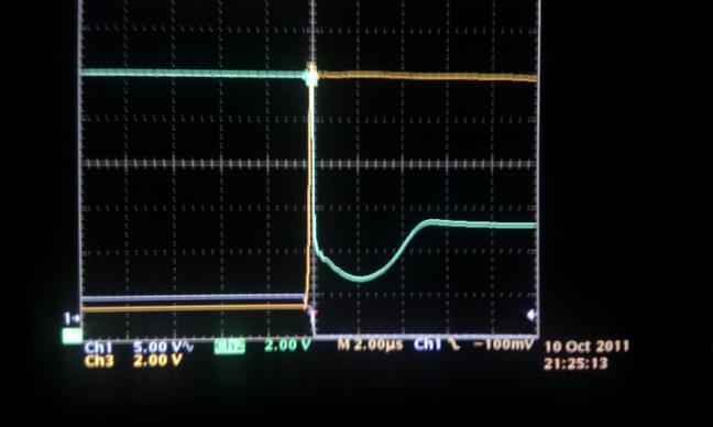

        Large iron ( metal not ferrite ) target at 2 inches ...
        It just rails the coil output .... what ?? ... 6 volts of spread .... and thats at the ouput of the blocking FETS ...BEFORE the amplifier ....

            Hi Paul, how important is the design of the diff coil. I'm using about 28turns of single pair cut out of cat5 cable and it's about 30cm diameter.
            This coil then goes into the newly finished frontend with the blocking fets. When I monitor the output of the blocking fets, all objects waved at the coil whether they be ferrous of non ferrous show the same response. I have tried the descrim balance control but still no good.

              • #67
                What to try next ?
                Mick
                Can you post a pic of your coil and the scope shots across the output before and after the blocking FETs with no amp connected.
                moodz.

                              • #75
                                Well here's what has happened. I've built another coil pictured below 24cm dia and 29 turns, wire from cat 5 cable. All Cro shots are 5v p-p at 50us per div.
                                With the new coil and once I looked in the right spot I can see the cro showing the difference between ferrous and nonferous objects.
                                The picture below is of fet sife of the coil and below is the tx pulse.
                                The picture below is FET side of diff coil and bottom picture is after the n-channel blocking fet.
                                The picture below is the other side of the diff coil top and after the p-channel blocking fet below.
                                This final picture is of the output top N-channel and bottom P-channel blocking fets.
