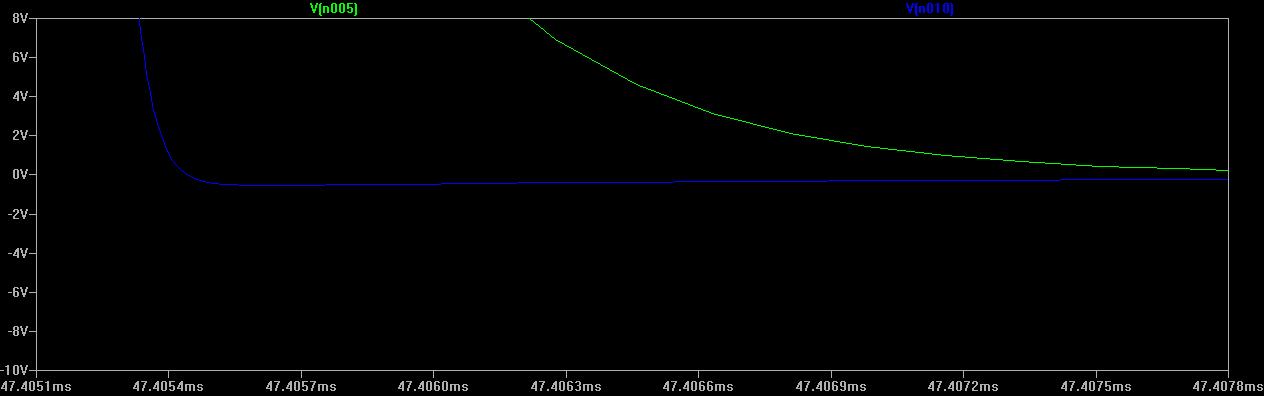

                        Its a sim as I am not near the bench .... the params are for a 18 inch minelab mono coil.

                          So interpretation is that there is no operation of your circuit. Flyback time is greatly extended. Decay is (critically damped??) from the resistor only. If so that is as expected.
                          Maybe hdphilip you meant with Moodz' circuit and resistive damping (if that is possible) although Moodz says he has separate real and reactive elements with the load switched off near the 'undershoot' so maybe you are asking for the switch off not to happen?
                          Chudster
