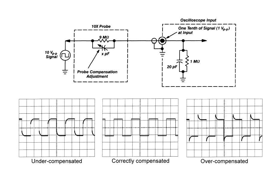

                  Is that link you posted the same model CRO you have .... figures ..... see PIC below ... see anything familiar ?

                      OK, Your graphic is showing probe compensation. I am talking about the effect a capacitor has in a square wave. Do you understand the difference??
