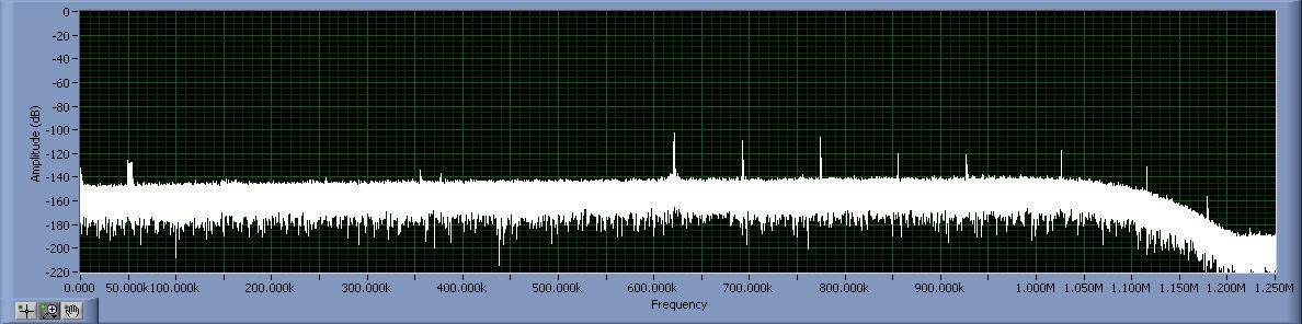

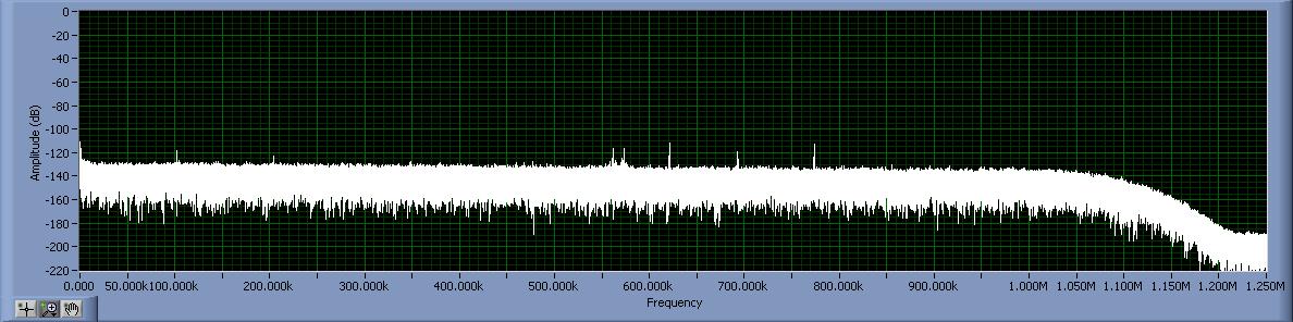

          • ....been working away at the signal chain ... happily I can now say the descrimination and target channels are working at 24 bit sampling with a bandwidth exceeding 1 Mhz and direct sampling of the frontend. Noise floor is down at -140db .. and I have not even applied the SAT yet ... I can extend the bandwidth to 10 Mhz but the effective bits will drop to 16 ..... not bad for sub $100 hardware .
            below are spectrum pix of the target and descrim channels .... I cant show waveforms with target and descrim infos as that may give away too much at this "sensitive" time .....the software PI is coming .... and its a race to the bottom.

            • Hey Moodz,
              looks like you are No 1 candidate to get the WBGB technology. 1 MHz bandwidth is by far enough.
              Direct sampling & decoding is the way to go. Get a high number cruncher for this purpose (DSP).

              • And I hope, you drive the ADC-chip in a fully differential mode (differential coil would make sense). That would give a superior SNR.
                And I think, you could implement some advanced techniques to reduce further noise. Make sure, your platform has enough RAM memory and CPU/FPU processing power.

                  Moodz,
                  Are you saying that you are sampling 24 bits at 2MSPS to get a bandwidth of 1 MHz or is this of the demodded signal at a lower sample rate?

                    Fully differential and DC accurate ... max input is +/- 2.5 volts to the ADC channels ..
                    • He is sampling at 2.5 MHz according to the FFT spectrum.

                        • This is direct sampled at 2 msps ... I can sample up to 20 msps but the effective bits will drop to 16 and noise floor to around -80 db ...Lots of testing to do .... LOL .... but now I dont have to tweak hardware .... only software. I am expecting to pick up another 6 bits of effective resolution on top of the 24 bit which together with the "new" front end and adaptive ground balance is going to be a very good system. The overall "real" bit resolution is slightly north of 26 bits and a system gain of around 10,000,000 over a 10 Hz bandwidth. ( ie approx 1000 times better than a 16 bit system ... taking into consideration system noise and processing gain).

                            • Hey Moodz,
                              do you use a DMA interface for the ADC? It would make heavily sense, rather than bit-banging the ADC interface.
