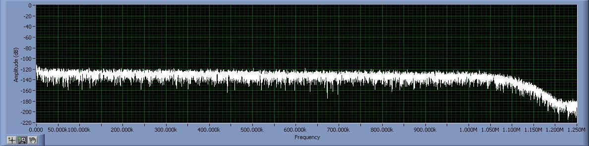

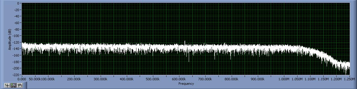

                            • hello moodz.
                              below are spectrum pix of the target and descrim channels .... I cant show waveforms with target and descrim infos as that may give away too much at this "sensitive" time .....the software PI is coming .... and its a race to the bottom.
                              correct me if i'm wrong, is that AM radio stations your picking up?

                              • Originally posted by hdphilip View Post
                                hello moodz.
                                also, who makes the test equiptment that your usuing for these tests?
                                Philip
                                you are right ... they are AM radio stations ... at this sensitivity with the shields off the circuit, even waving your hand a few inches above the circuit board will change the amplitude of the signals by a few db ..
                                I am not using test equipment ... this my a "roll your own" experimental rig .... a fully digital signal chain with a target and descrim channel and my ( patent pending ) front end. Because a patent process is currently progressing I cant talk about the method obviously. This is unfortunate but certain parties have forced this situation on hobbyists.
