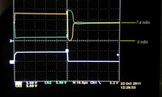

            Mick ... I think you still have a problem ... the output of the blocking fets should look like below .... if the coil is sitting at 7.4 volts then that is what the voltage should decay to ...
            I have wired up a board for field tests ... just finalising the amplifier ....
            moodz

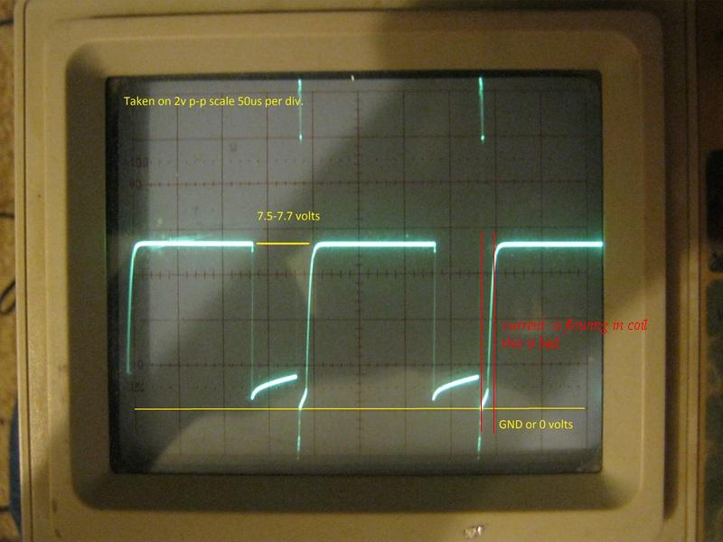

              Just took this shot the cro is set to DC input 2 volts p-p taken on one of the blocking fet output's. If this picture isnt correct I don't know whats going on I must mention that I may have done previous measurements on AC input.
              • #97
                Mick there seems to be some current flowing ... if you have diodes connected to the ouputs of the blocking fets disconnect them then measure.
                moodz

                    This seems to be looking worse every time I do something to it. no diodes on output of blocking fets
                    • Hi Mick,
                      I think what your seeing there is the Miller effect.
                      Tesla Coil design, construction, operation and measurement information
                      It shouldn't normally be a problem and it indicates that your not driving the gate of your coil drive mosfet low hard enough.
                      Which raises the question how are you driving the gate of your main coil driving mosfet?
                      I noticed the mosfet driver dropped off the schematic a while back.. I'm not sure why. I hope you didn't make the not so unreasonable assumption that meant you could drive the mosfet directly from the PIC.
                      If you are using a suitable driver then as a next step I'd recommend scoping the mosfets gate and make sure it is working as it should driving the gate high and low nice and smoothly.
                      I hope this helps you get it working properly, I'm keen to see someone else replicate moodz's excellent work.
