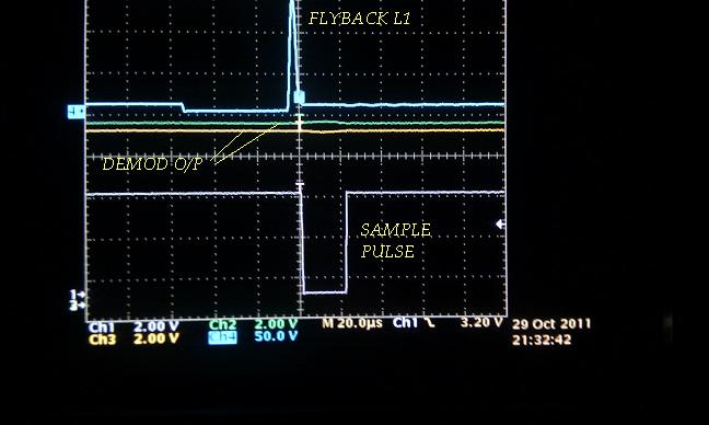

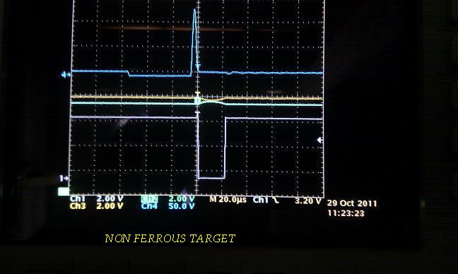

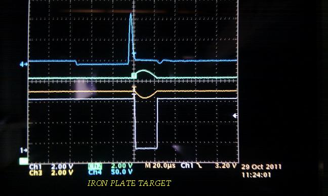

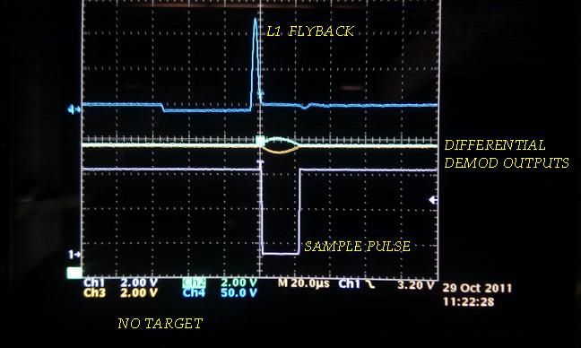

                • DIFFERENTIAL DEMODULATOR SUCCESS
                  After a fair amount of stuffing around ... the differential demodulator frontend is now operational ..... this includes the blocking fets and damping circuit ( I thought the damping circuit might have been dodgy ... but it isnt .... its all about critical balance )
                  The gain of this frontend is only 1 .... the design and timing removes the need for low noise high speed fast recovery amps in the frontend whilst still offering sub microvolt accuracy.
                  The output is differential ...so now we need a good DC differential amp ( )
                  Output noise is extremely low and narrowband ... no resistors used in frontend at all ... ( you once challenged me to do this Carl .... so its done now he he )
                  The descrimination is excellent for ferrous / non-ferrous ..... see pics below ... note polarity&shift of demod ouput voltages.
                  The next task is to get the precision DC amplifier going ( chop chop )
                  After the DC amp task is complete we will have a complete detector signal chain ... sigh.
                  moodz

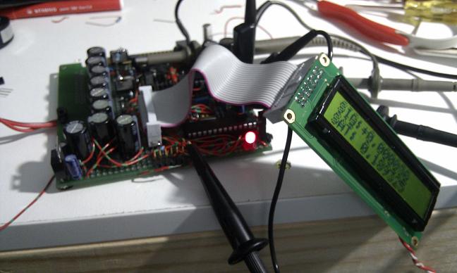

                    Mick ... I thought that might work ... the CRO should not be the issue ... though a multichannel digital CRO is more about saving time than resolving issues.
                    It appears that the damping is very critical to the descrimination process .... variable damping is required to set the "balance point" .... PI detectors to date have ignored this ... most designs just set the damping to some value to try and optimise the coil decay ... however I have come to realise that it is absolutely critical to obtaining the correct operating point ( well for my design anyway )
                    The second factor is that the blocking FETS source connection is effectively floating with respect to the gate and so can be easily upset by any voltage imbalance that occurs across these devices ... this will either cause the fets to stop blocking and switch high voltage through to the demod or punch through the FET gate. The other factor to consider is that any imbalance will upset the damping value which is extremely sensitive when at the balance point.
                    Even the high impedance probes on a CRO can upset this balance point by loading a very small current through the blocking FETs ....
                    I am looking into a more robust set of balanced FETS with 500 volts of isolation.
                    Below is a shot of the current circuit being probed on the bench.
                    I have not drawn the circuit yet ...as I only got it up this morning .... I will try an complete the DC amp this weekend .. unless I have to get some parts
                    moodz

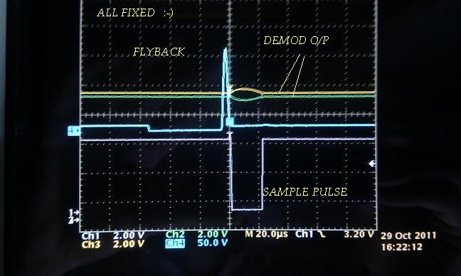

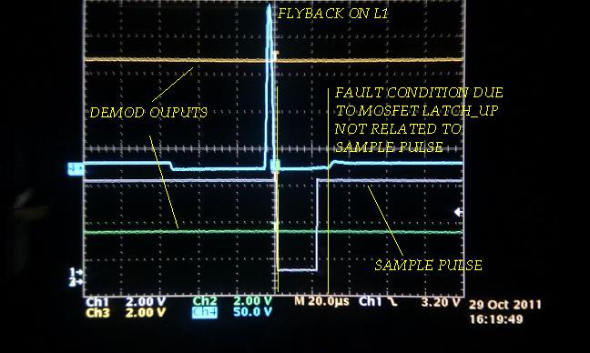

                        Mick ... I have been able to reliably recreate the fault and a fix is in place ( very simple ). I will do some more testing and include in next drawing. The problem was to do with the damping mosfet latching up during turn on and never being within control range of the damping control voltage It also causes the flyback voltage to reach excessive voltages which can damage the blocking fets.
                        moodz

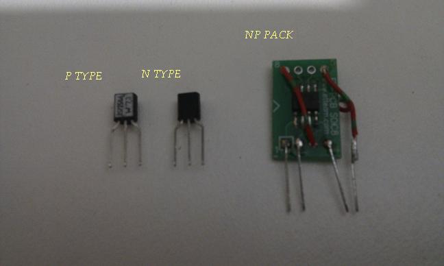

                          • Mick .. before I get onto the amp .. I just wanted to make sure that NP FET pack you are using was OK ... I had not actually tried it when I recommended it to you .. only went off specs .....
                            The result is PERFECT ... works better than the discretes.
                            Tick that one off ...
                            I mounted the chip on a little SOIC board with some "pins" that go into the sockets where the blocking fets plug into.
                            The demod outputs in the pic below are close to, but not balanced ... the descrim balance control setting is 2619.
                            moodz.

                              Hi Paul, I'll bung another in tomorrow and see what happens. What was/is the mod for the descrim so I can fit that as well.
                              Mick

                                Mick ... add a 1K resistor in parallel with the damping fet like so ....
                                moodz.
