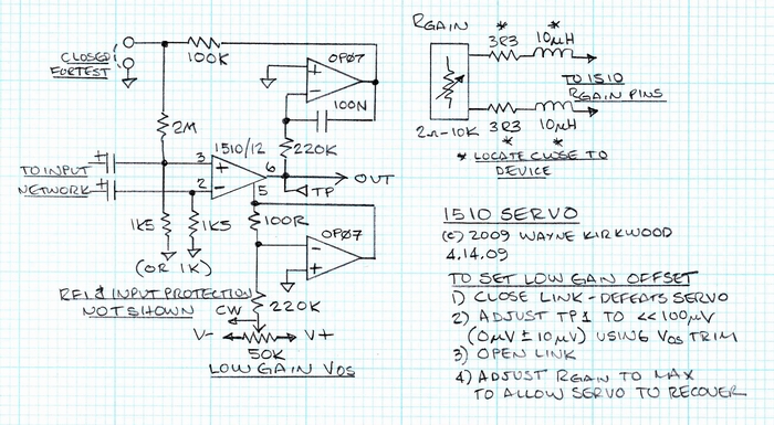

                • Hello to everyone. My thoughs... (just saw this design.) I have been using the that1510/1512 for 3 years now. Very quiet chip intended for audio appl. and not DC amplification, with some major flaws. Extremely temperature sensitive! I have mounted mine on a large heatsink to make it temperature "steady/stable". Offset on this thing is close to 40uV/C. Datasheet does not mention these cause of audio appl in mind. That means do not amplify a lot, or you get close to supply rails and saturate the output...or if oscil/on. occurs, now you know why!!!

                    The MAX32 is easy to get, cheap, small and "relatively" easy to program.
                    2) The frontend is fairly stable and people are happy with its performance. Ground effects and interference are greatly(??) solved by the differential coil approach. (Although this is development and the aim is to always improve so we should never really be satisfied).
                    The differential coil largely eliminates EMI .... audio and radio technologies have been using them for years ... ground effects are another story....
                    3) Typical waveforms to be processed are as in the quoted posts.
                    The published waveforms clearly indicate that differential coils do work.
                    4) The current sampling is low bit rate (<32Khz) via a high accuracy A/D (24 bit). Three options are being looked at for future sampling- higher rate but striving for accuracy.
                    The sampling rate will be lower if sampling demodulated signal and higher if direct sampling ... I am looking to use 24 bit sampling with rates from 5 KHz, 192 Khz and 2.5 Mhz.
                    5) Development is ongoing and probably always will be. At some point a practical design (or numerous) will spin off.
                    Practical designs are being worked on however some commercial companies are trying to tie up the PI market with Patents ...we are fighting back with our own patents before publishing new designs.

                    There is lots of stuff in the signal that is not known in the art .... DSP is revealing it ... again it depends if you sample pre or post demodulation
                    6) Thus the 1MSPS 10 bit ADC built into the PIC might be a better choice than applying sample and hold/ integration/ analogue type techniques. You can augment the accuracy with some kind of programmable amplifier and adaptively change the gain depending upon the echo to maximise it while avoiding clipping or saturation. That is start out looking for the weak target and then adaptively drop gain to better determine what you have if it clips.
                    The UNIPI samples at 12 bits on chip and integrates with SAT function ...sensitivty is adequate for basic to medium performance. On the other hand I have some AD7760 chips and they will do 2.5 MSPS at 24 bits ....
                    7) Maybe consider strategies to do better than the 1MSPS rate in the PIC although getting such high speed data into the PIC may be difficult (20MHz max serial clock???).
                    There are faster CPU chips but $20 of programmable logic allows you to keep your favourite microprocessor.
                    If the PIC (and its ADC or the ability to get high sample rate data) is the limitation then an alternative processor with faster ADC (if such a beast exists) might be warranted.
                      The THAT amplifier is used for the following reasons ..
                      1. The bandwidth is over 3 Mhz at a gain of 1000 and very low noise ..... The layout and decoupling is absolutely critical as this is effectively an RF amplifier. I regularly run it at a gain of 60 db No Problemo.
                      2. It is a true differential amplifier and thus suited to the differential PI experiments for effective common mode rejection.
                      3. The amp is DC coupled at the input because it has to be ( read the data sheet very carefully ) though it is not being used as a DC amplifier ... PIs dont work that way.
                      4. The output is AC coupled to the ADC ... no point digitising DC offsets.
                      5. Temperature drift and DC offset ( less than 10 uv ) are solved by utilising a servo loop ... see below ... however I have never found this to be a problem.
                      • Hmm...servo loop is a "partial" solution since it will introduce some noise. Need careful design/layout etc. Temp drift according to my tests on 10 of these came out from 16uV/C up to 32uV/C. 60db of gain is typical but how about you use it with a follow up amplification so the total is 200KX to 500KX and let's see how well it works. We have to be realistic, 60db of gain is going to get you below average sensitivity. Again, I am not saying that this is a bad amp since I am using it too!!! but didn't agree with the " major PI sensitivity improvement " quote.
                        • So why don't you build your own CFIA with discrete transistors and op amps? Unlike a THAT configuration that has unbal output you could make it double balanced, just like the THAT's inspiration - Cohen preamp had. You want to use it for AD converter, and those are happiest with balanced signal ... even a bit of bias would not bother you any more
                          Alternatively if you insist on THAT solutions, try THAT1570. It is basically 1510 without the output differential amp. The only downside is 0dB common mode gain (no cross-coupled diff amps to enhance CMMR), but for supplying AD converter WITH a balanced input - that's just fine.
                          • Thanks for the advice but my "THAT IC" testing period, is over. Yes,I have designed my own pre amp, with excellent results but it was a bit tricky and time consuming- not to mention the high cost of buying all precision components...have to congratulate you all for the time, effort and info you're given to all.
                            • Until i see proven design flaws, i am open to Moodz use of the THAT Ic. Looks interesting and I am all for it until proven otherwise.
                              Cheers Sido
                              • I don't see any design flaws because I have not! built this machine but at the same time I can pretty much "see" its capabilities and where this is heading. I gave advice and my opinion about some of its "flaws" and mentioned info that the datasheet does not have! It took me plenty of hours, for example, to do the set-up for the temp. drift. It's free info.
