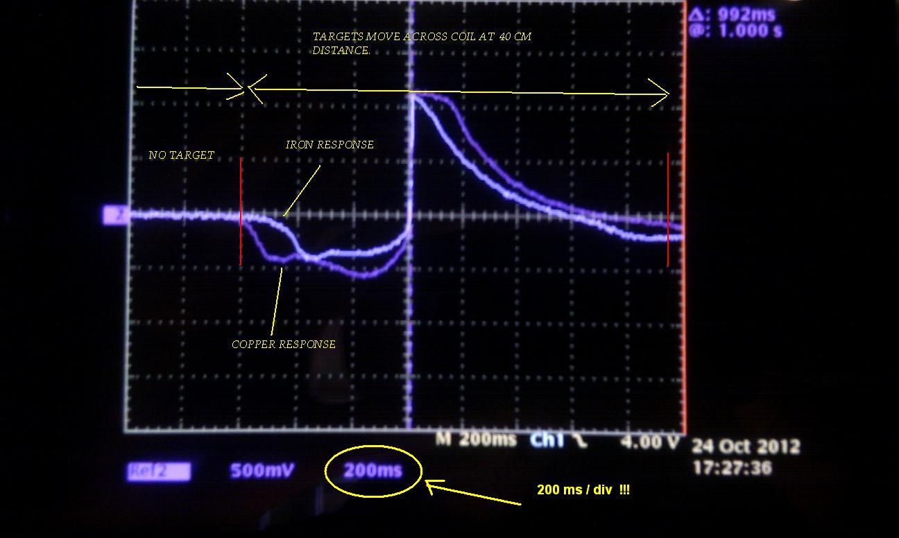

                  Below is the input signal to the audio modulator ...ie the output from the amps etc etc .....
                  OK
                  two identical test targets are moved across the 18 inch monocoil at 40 cm ( note the time base ... about 1 second target time ) .... iron and copper ... for comparison.

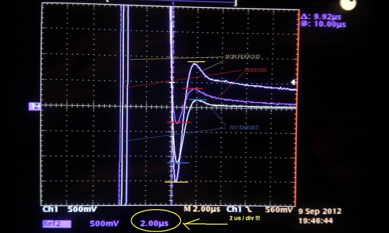

                  Moodz, IMO there is not a significant difference between the iron and copper signals you are displaying above. The large negative swing you have previously displayed in post 360 for non ferrous is not evident in this latest waveform presented????
                    ...the correct term should be IMHO ... and yours is truly humble in this case .... because you are comparing apples with oranges. Post 360 is much earlier in the signal chain ...just after the damping magic happens .... post 555 is the audio tone envelope modulation waveform ... just after 140db of processing gain and filtering ... but prior to audio tone modulation ... look at the time bases ... 2 microseconds vs 200 milliseconds or so.
                    The descrim function is still in the signal chain ... the "super pro" experimental model extracts this channel separately ... post555 only shows the target channel for the "pro" experimental model and combines discrim and target in one channel for cost reasons.

                    • Hi Moodz,
                      I think to truly demonstrate descrimination you should show a variety different shaped targets made of different metals and show that there is something in common with all the targets of the one metal type. I'm assuming that with this test you used two targets of indentical dimensions but differing metal types, which obviously respond differently. But that doesn't neccessarily mean you can determine the metal type or even group of metal types when you don't know the shape and size of the target.

                        Very true ... this version only has the one "channel" and the focus is on ground balance and sensitivity. At this stage I am not that worried about discrim ... but when I am digging deep holes I will be ... LOL. The signal processing version will have a second discrim channel. I have made this version to demonstrate superior sensitivity ( goal is > 10% depth ) and ground balance utilising a relatively simple design and lower cost utilising new PI techniques. Dont forget I am using a monocoil which is probably the most difficult to achieve any level of discrim. I wont be posting lots of target tests as they just take too long to do properly .... I am aiming to prove the performance in the field not the bench ... I have got cabin fever from being in the lab for too long.
