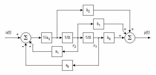

                  • OK, let me try finishing the proof thing once and for all. You can observe a PI receiver with late sampling as a state variable filter. it consists of a summing node and two integrators in a sequence with feedbacks and a summing node. Now, if you can't see how these two integrators are put into sequence, go back to George's neat formulas and find it yourself. In short, late sampling per se is the form of integration because it decimates high frequency content. In effect it is a Nyquist filter with cut-off frequency at 1/t (this is actually a key point here). When such signal is integrated, and fed back to the input - you have a state variable high pass filter.
                    A state variable filter in it's straightforward form is as follows:
Name:	state variable diagram.gif
                    And it can be put into a formula as:
Name:	state variable.gif
                    (different authors use notations H(s) or G(s), where s is jω)
                    The second order HPF can be presented as:
                    As seen from the previous formula, b1 and b0 are not summed, and the factor a1 determines the Q of the filter. In case of Q being 0.71 we have a familiar Butterworth response, which is equivalent to a first order high pass filter. The Nyquist thing in this procedure is responsible for the filter Q. For the same reason a faster first sample has more of the high frequency content, and with this state variable ... thing the output is actually band pass filtered: Nyquist sets the low pass (t1) and state variable (Nyquist of t2 + integrator) sets the high pass.
                    Q.E.D.
                    P.S. whoever wishes to play with the state variable filters may do so in excel sheet that I made a slight facelift, but all credits to Mark Williamson. Link to his state variable filter page is in the sheet.

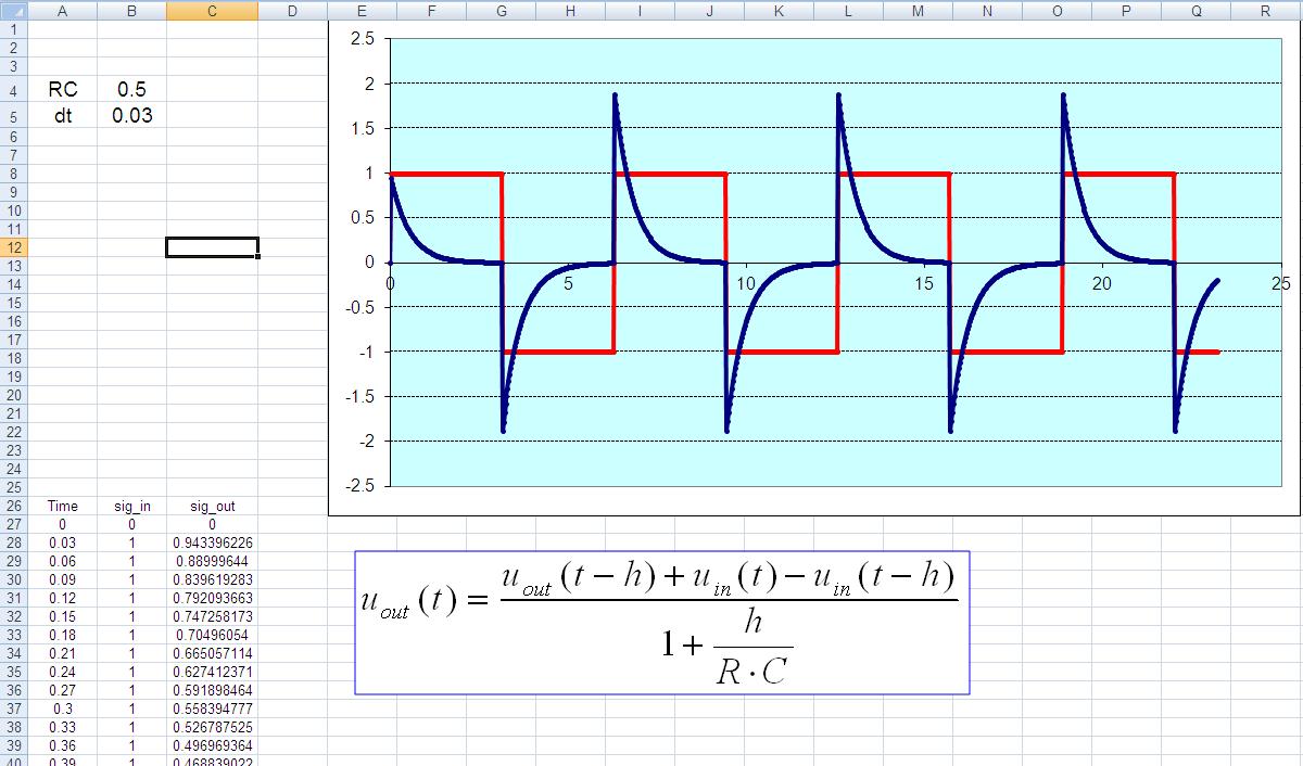

                              • yawn ...
