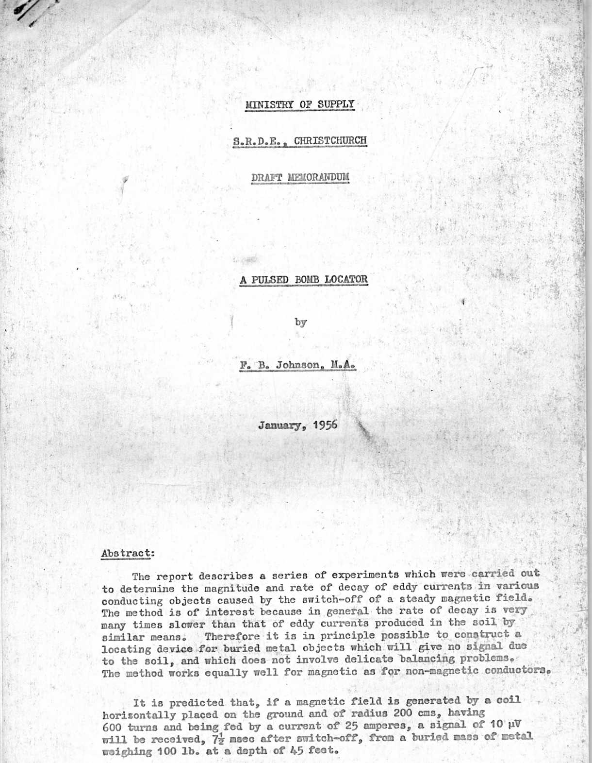

          • I have many of the historical documents still, and will post extracts from them when appropriate. The information may be useful to others who have more recently entered the PI camp and can apply cutting edge techniques to advance the technology further. Here is the cover page of Johnson's paper.
            Eric.
