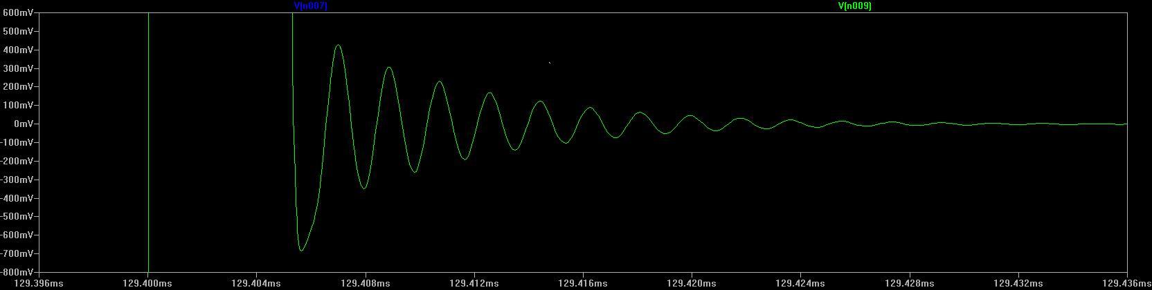

        ...in the mean time while you guys have been waxing lyrical about amplifier development I have been working on the front end ...
        .... the good news is that we have made major progress in developing a new topology PI front end that does not use damping resistors. ( actually no damping resistance at all )
        A new control circuit perfectly damps the coil at all times utilising a new patent pending technique. It also surpasses all previous art in noise and the invention works on monocoils, DDs, ground loops and differential coils.
        .... the bad news is we cant release it ( yet ) to prevent patent leaches from ripping the idea off ... we have had to apply for our own patents to protect the idea.

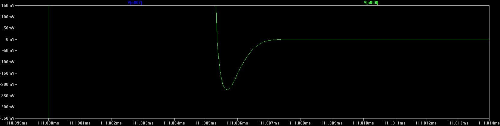

        To give you an idea the first picture below is the response of a 300uH coil with a 200 microsecond Transmit pulse 3.2 amp peak coil current and damped in 5 microseconds ... with NO damping resistor ( the new control circuit manages this bit ).
        In the second picture the control circuit magnetic factor is backed off to allow the coil to ring slightly ( remembering that there is still no damping resistor ) ... If you sampled a standard coil at this point in time with NO damping resistor the ringing would be in the order of hundreds of volts .
        Because there is no damping resistor ... target sensitivity is greatly increased.
        Sampling commences at 5 microseconds.

          • I never talked about amp noise except in the case of the servo loop, to justify my reasoning. I talked about other parameters that can be of importance to high gains. It is not my problem that some members like to get off the subject.
            About your damping circuit, hope it works as you said, too bad you can't publish it, but may I ask why this will improve noise. Since it is damping the coil, it some has a resistance/reactance and it has inherent noise. The only way that I can see, to improve sensitivity in certain situations only, if it is dynamic in nature and over/under damps the coil at specific times.
            • I'd say that having heavily damped coil during initial stage, and then relaxing it to see low impedance would squeeze the most juice out of the targets. It would shorten the initial stage, and widen the sampling stage, so that's good. In a way a simple inverting amp does that - as soon as it drops from saturation the effective series resistance drops to one half of what is written on the resistor.
              My view of the PI damping is that it is transformed to the targets as well, so all the targets will under such conditions appear more resistive, which in turn ruins discrimination.

                • It sounds good to me...And if it is user, real time controlled, it will improve sensitivity in certain areas. I first heard about impedance matching in high school, from my father. Was too young to understand its implications. In order to get the most energy transfer from source to load, there must be an impedance "match". This is standard 101 course in electrical eng. The better the match, the better the energy transfer. BTW, I am working too on an active damping circuit to get better sensitivity. So far, I have only seen an improvement of 5% to depth range. Hope yours is a lot more.

                      Carl, I made up multiple bench top versions letting plenty of smoke out along the way with only limited real tests because a fair bit of time was spent writing up the idea for the patent apps. however the two key discoveries ...new damping method and a servo to auto regulate are definitely hardware verified.
                      This invention is based around new behavior apparently not previously discovered in PI technology and describes a system for exploiting it. It is not some arrangement of special parts and though relatively simple ..can be done in analogue or digital ...it does appear to be a new technique and will have benefits especially for monocoils. I don't think it will double the depth LOL. But it will have benefits for earlier sampling, signal to noise, easier ground balance, lower power consumption, wide tolerance to variations in coils and probably more as well. One key aspect is that it bypasses the techniques currently patented by a well known oz company who seem to want to own all the PI ip. ..and makes it hard for us little guys to come up with non infringing technique.
                      The sims merely provide a means to explore the dynamics of the system and try to understand why it works as well as it does.
                      We are currently working towards building a prototype based on an existing high performance design. ... However this is new territory and I also shortly expect to add descrim to the list of claims. ..though this has been observed but not quantified yet.

                                True .... I am laying out a final version of teh cct for the prototype ... I will take some real measurements and put them up .... believe it or not the most difficult thing has been adding some protective circuitry to prevent damage if the invention does not do its thing ... ie because there is effectively no damping in the traditional sense ... working this close to the flyback if a fault condition occurs results in "ringing" voltages that quickly let the smoke out of the components I am using which cant take alot of juice through them. However the protectives have to be added without impacting the operation or sucking the signals we want. The most critical time is when the detector is first turned on and voltages are ramping up at different rates in various parts of the circuit. I am upto version #20 or so of hardware builds so it pretty much works like the sim said it would .. the prototype will tell all ( maybe ) hopefully.
                                As for manufacturability .. for sure the frontend is more complex than your standard damped PI ... there are 33 parts in the analogue version ( just counted them ) including the usual bits of a frontend ( except the damping resistor of course LOL ). However there would be about $10 worth of bits there. The rest of the signal chain, demods and sampling / CPU etc are unchanged. A big advantage as I see it is that this cct will "tune" to a much greater range of coils .. so the coil hackers / builders will be very happy. For a manufacturer that must be a big plus ( no need to tightly spec coils ). Also there are no adjustable bits that would need tweaking at the factory ... like damping values ... since the circuit self optimises itself ... that would have to be a plus also.
