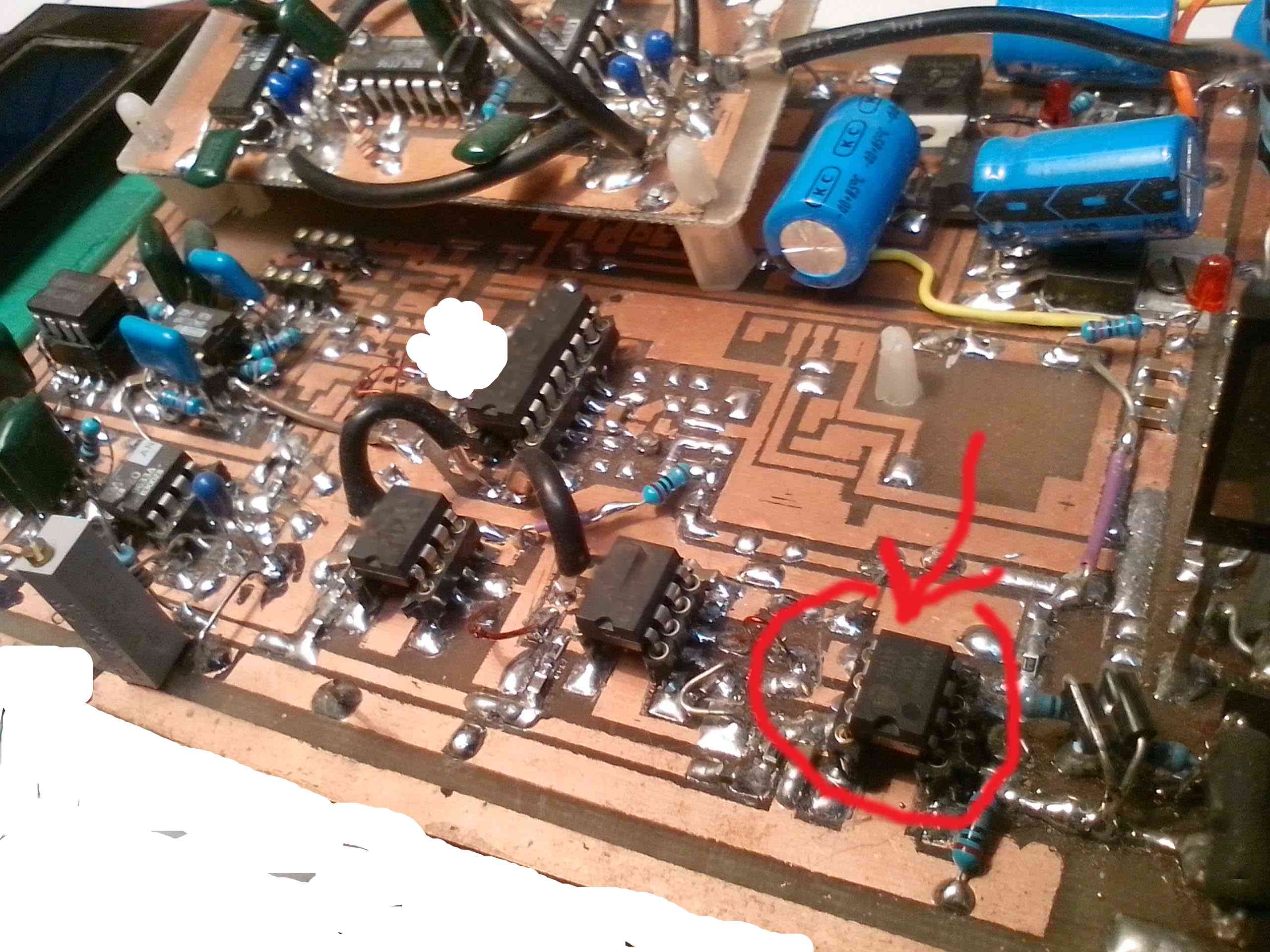

    Here is the prototype. Bottom side is where all digital electronics and controls reside. LCD display is on left side. Hope this post is not off topic. If it is, I apologize.

          ...since you all here, are talking about a differential front with a THAT1510 pre amp, here is my design, back in 2010.
          Don't get me wrong, but going balanced leaves you with far more options than the overhyped THAT1510. I'd much rather build my own CFIA, or if forced to go THAT, it would be THAT1570 instead.
          Being an amateur, or at least choosing an amateur stand point in the matters of electronics and metal detecting, I'd never go for a part that is difficult by any means. Difficult to obtain, difficult to pay for, difficult for care and feeding ... by any means difficult. I'll leave to my ingenuity to fill the gaps of the missing difficult parts instead.
