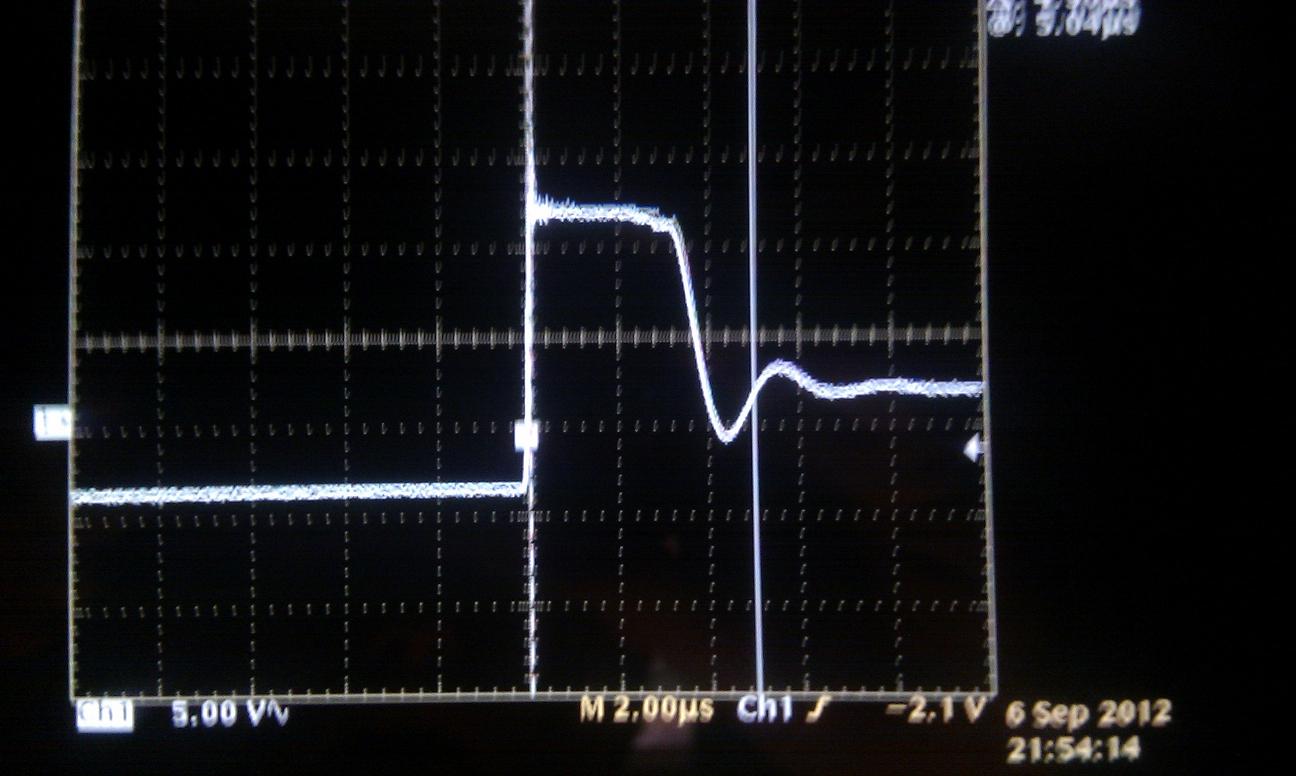

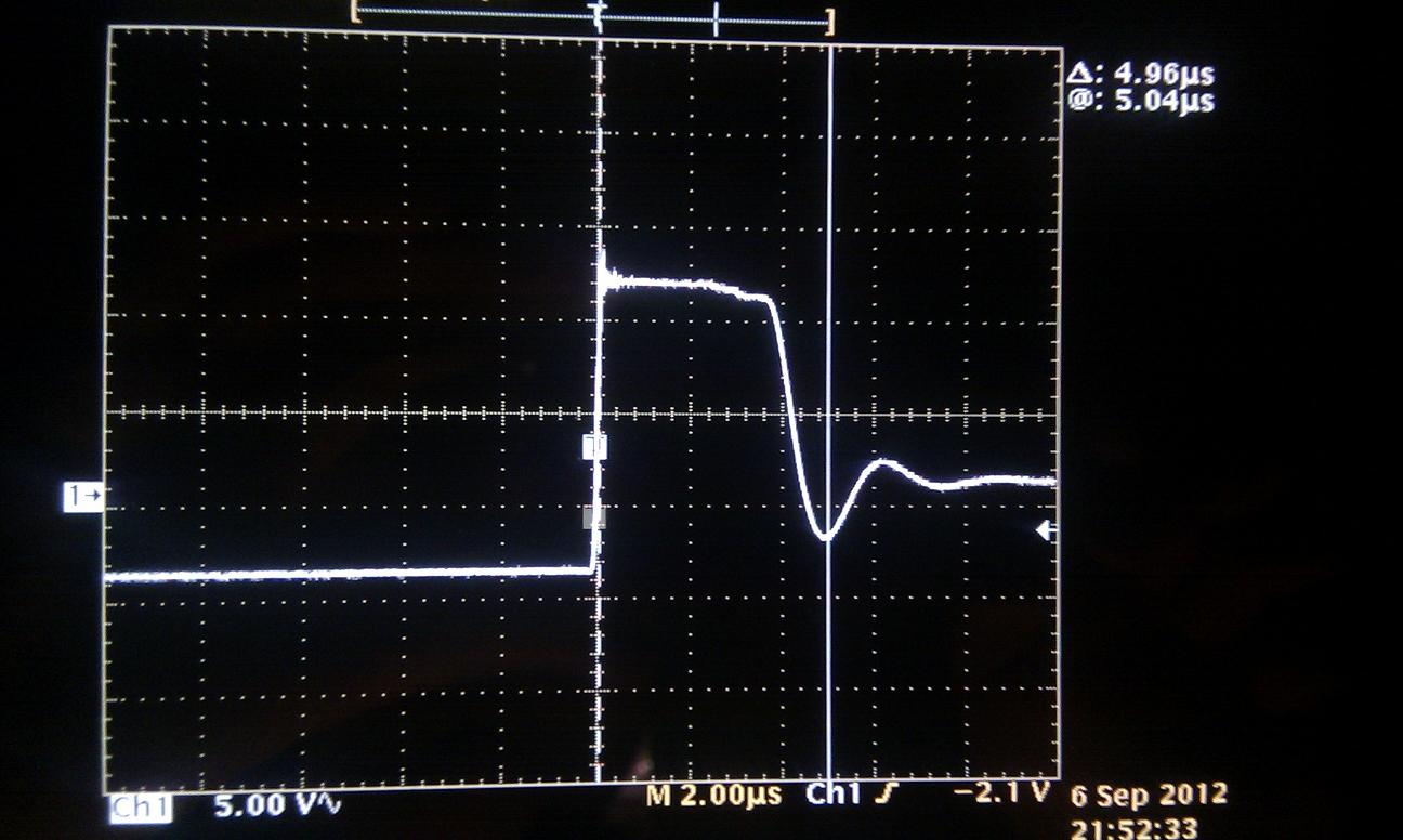

                            That is a bit defeatist ... there is always something to improve .. mostly because people look past the obvious stuff ...In PI technology everyone has assumed that the critical damping equation is the optimal solution and then proceeded to improve everything past the coil and damping resistor ...I offer some evidence below to show that if you want to make a chain stronger you have to look at the first link as well as the ones in the middle...
                            ...I have used a minelab 18 inch coil which on a good day might get 8 microseconds to first sample .... the results below show that it can be done in 4 microseconds with very large target response.
                            The autodamping is functioning but the signal is not amplified ... note the signal response for a non ferrous target at the vertical marker ... I wont bother publishing a ferrous target
                            .....see it does work in real circuits .... not just sims.
                            The circuit can be used on any existing PI design IMHO. No manufacturing issues or part sourcing and it "tunes" the PI coil to have a perfect response so you coil hackers will have a wider window to play in with regard to coil parameters like inductance and resistance.
                            • Hi Paul,
                              ground balance gets difficult, when the residual voltage is swinging at the coils self resonance frequency. It (frequency) will be changed due to ground conditions (coils inductance changes slightly).
                              It needs some refinement of the damping I think.
                              Aziz
                                So is this the signal prior to the preamp?
