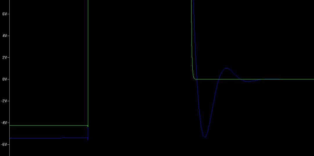

        • no problem:
          blue trace current thru coil
          green trace across the in4148's

          • Originally posted by hdphilip View Post
            no problem:
            moodz ,
            this line at the patent office is pretty long today, oh wait, their opening up another window...........
            the "team"
            hmm ... your coil current is not zero post decay ... make it ring or you cant prove the coil is unclamped and responding only to target fields.
            nice snubber waveform
            moodz.
            • hummm, ok
              i had to adjust a few "things"
              would be fun to revisit the differential front end with this,

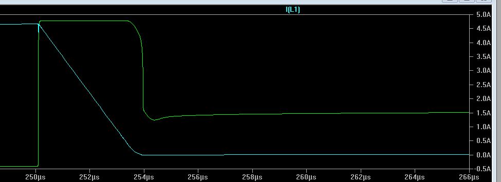

                  Firstly Moodz, fantastic work.
                  Got to jump in here though. I have scoured these forums looking for the magic trace that shows the target response from eddy currents. Can someone please point it out in theses traces?
                  I assume trace 1 is with the non ferrous target and trace 2 with air.
                  Why should I not simply interpret that the coil has higher inductance with a target meaning more energy is stored (yes eddy currents could be part of that) leading to a longer flyback time (to get the energy out)? Instead I keep hearing (the myth?) that there is this "magic" signal detected after flyback ends that no one has shown me in a sim or real life. To me it appears the two signals are more or less delayed or advanced flyback of each other due to energy/ inductance differences. We shorten and shorten the flyback and it does not seem to leap out.
                  Can someone please help me see what I am missing or has the Emperor got no clothes?

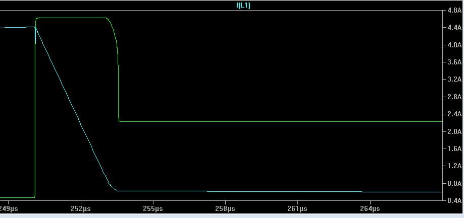

                  • chudster
                    those pictures don't actually show the "decay" as in the perfect sense of an example, due to moodz damping, but as you can see in the second picture, that increased "bump" at the marker would have been a "lost detection" if the flyback pulse was a microsecond longer.
                    so the importance of flyback control is very real,

                      • Thanks for your reply and input. Maybe I am still not seeing it but 1 just pretty much looks like a longer flyback time due to more energy to get out than 2.
                        Hdphilip, I hear what you are saying but the bumps I took to be Moodz' explanation that he has let it ring a little. However if that is the feature needed to be measured then at 500KHz fundamental sampling need be better than 1MSPS if sampling before demod.
                        Not to take away from Moodz' amazing achievements to terminate and shape flyback leaving essentially an open circuit coil without a resistive damped signal (which I am sure will revolutionise detectors because they do work already and it should make them work better), but I've read a lot of theory that says its there somewhere. That the time constant for non ferrous materials is short so they decay and show up just after flyback (provided its gotten to quickly enough and current is terminated fast enough) but I am still looking. If we could get flyback down to 2uS or 1uS would it show up? Can anyone point out that magic target signal in terms other than as longer/ shorter flyback less/more energy?
