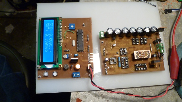

        • moodz,
          I'm going to build the 4012 first, then experiment with the different front ends, I'm making the PCB now. I do have the 4011 chip also.
          I found some software, "PICPgm development programmer 1.6.4.2" that I'll try to use to program the dsPIC30f4012 with the jdm programmer.
          Philip

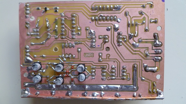

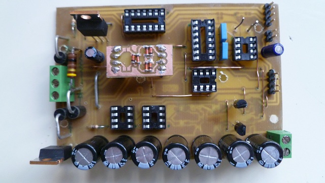

                • rev 003 front end pcb
                  so far so good on the front end pcb project, can't wait til i start testing it!
                  I decided to make the "series blocking fet on it's own plug in board for testing, right now i'm going to just stert with the diodes first, then I can just change board to see what the performance differences are.
                  the trimpot (next to the voltage regulator) is inserted between the gnd and the 7805 gnd tab, set to about 5.3 volts
                  for some reason, i'm still having a few issues with the rotory encoder,
                  Philip

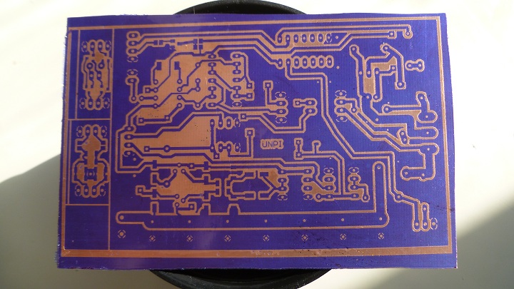

                  • Good job Philip
                    what method did you use to make the PCB ?
                    • 6666,
                      I used the negative photo resist,
                      MG chemicial 416 DFR
                      i make the transparency on my laser printer
                      making pcb's pretty easy, it just takes a few tries to get the exposure
                      right, i find 6 minutes with a "black light" at 12 inches works,
                      here's the board before i etched it.
                      the two boards on the side of it are for input blocking fet ideas
                      Philip

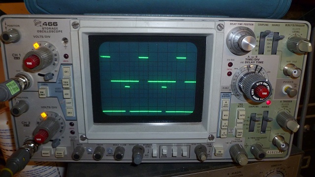

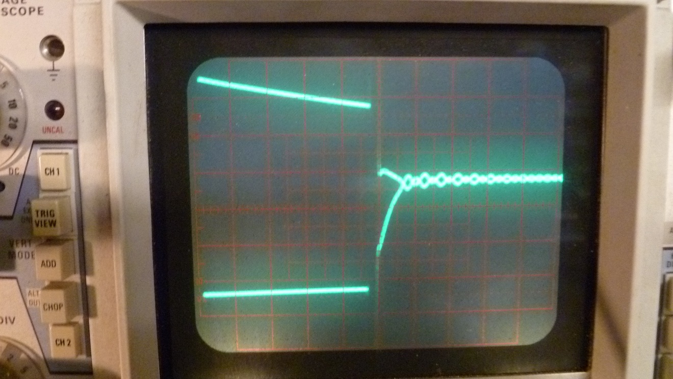

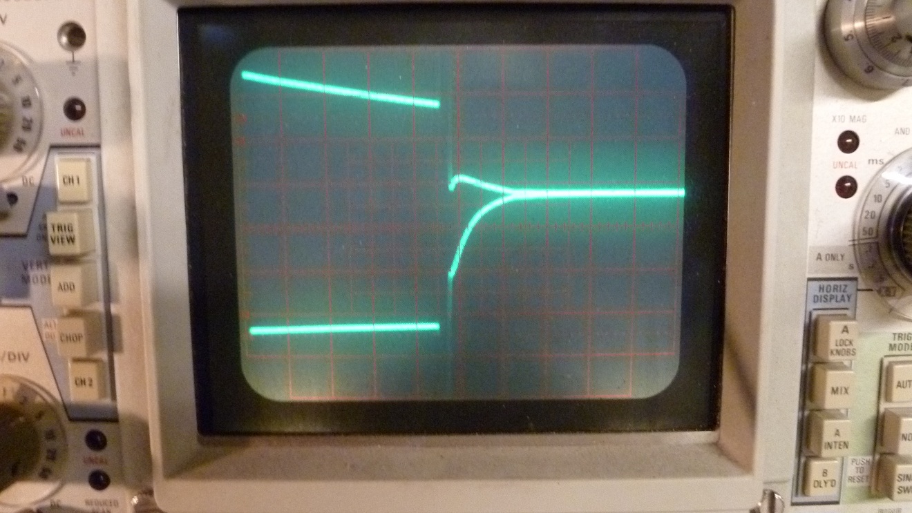

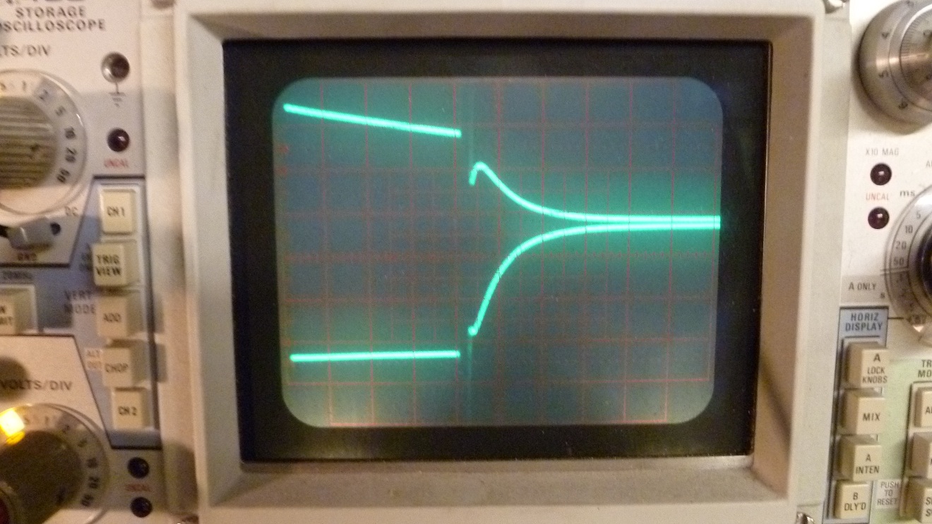

                        • Here's a few pictures of my current progress
                          first picture is no target
                          second picture copper pcb laying on the coil
                          third picture is a metal cover also laying on the coil
                          the scope leads were attached to L1 and L2 referenced to coil center tap.
                          next, the blocking fet setup.
                          Philip
