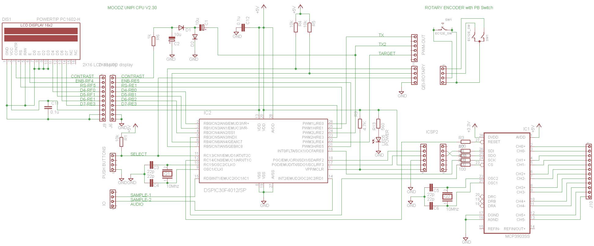

  • dspic30f4012 UNIPI fitted with 6 channel 24 bit converter + programmable gain amplifiers.
    PS dont try to build this ... you dont have the hex yet ... it is still under test ... and the audio output is missing ( need to allocate another pin ).

          • progress
            Well,
            here's my progress so far on the Rev oo3 front end connected to the 4012 processor.

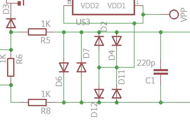

                              I looked at the " diode module" idea
                              been wondering what the function of diodes D2,D4, D11, D12 is
                              and why they are connected to VPP, are they part of the bias generator
                              are they needed if not useing the bias generator ?
                              • hello 6666,
                                The diodes,
                                D2,D4, D11, D12 they serve to knock down the fly back spike coming from the coil, those 1K resistors should be 1% and at least 1/2 watt they do get very warm.
                                The "VPP", even though it's at +12 , it's serving as "gnd" in the analog processing chain, if you look at pin 6 on the THAT 1510 chip, it's also going to VPP which sets the ground reference, So with that being said, when i look at signals with my O-scope i hook the ground on the test probe to VPP as it is my ground reference.
                                on my o scope, the gnd if floating, if it wasn't, I'd short out my bench power supply.
                                Philip
