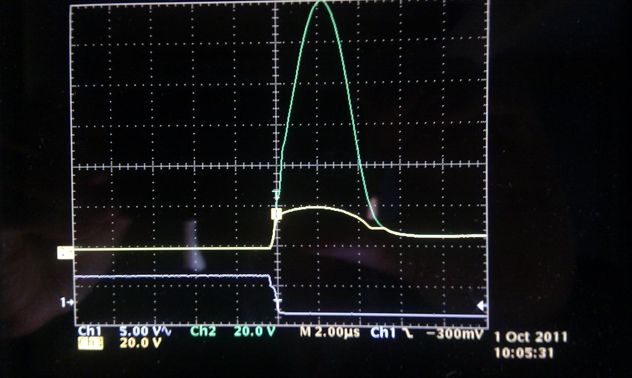

    Instead of the usual "crowbar" diode and resistor arrangement that shorts out high level voltage into the amplifier a series blocking FET arrangment is proposed where the FET becomes an open circuit when a high voltage is present a the input thus protecting the amplifier.
    The Pic below shows the circuit in operation where the incoming flyback pulse green is knocked down to 20 volts peak yellow which the amp can deal with. The white trace is the gate drive for the TX MOSFET.

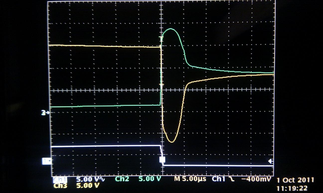

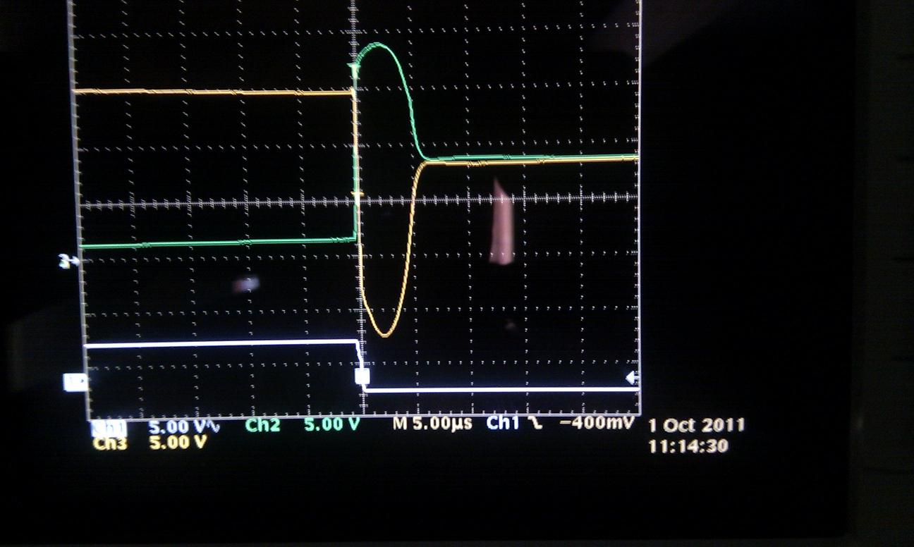

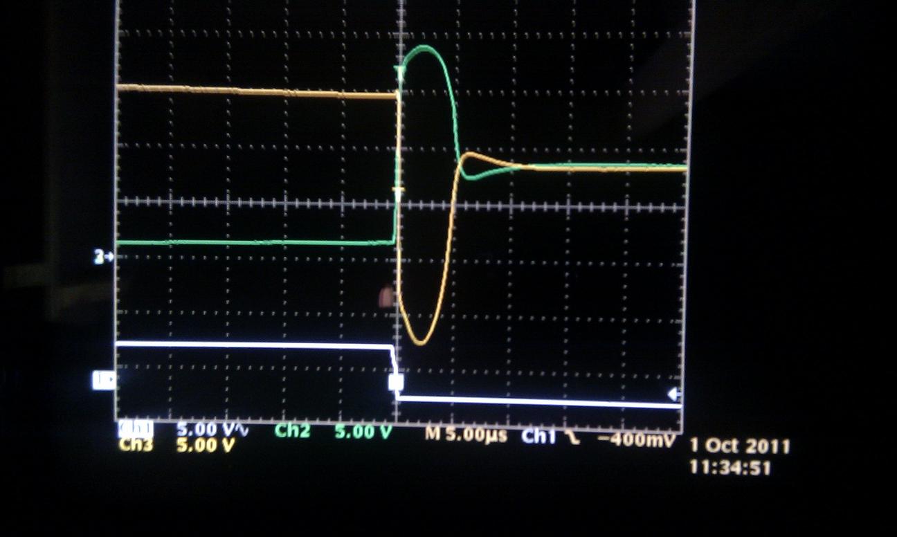

      Series blocking to the input amplifier is a success.
      Pics below show blocking signal at input to amplifier and .......
      descrimination info
      and I have not even begun to amplify it yet.
      This working on the UNIPI chip with the damping circuit and series blocking FETs. The series blocking FETs dont require any control signals ... they block depending on the voltage signal at the input ... basically high negative or positive voltage = OFF.
      The three pics are in order 1. No target 2. Ferrous target 3. Non Ferrous target
      I dont have to tell you where I will be sampling do I ??

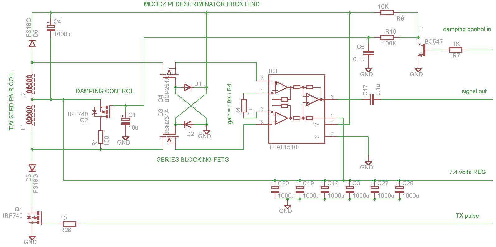

            DESCRIMINATING PI FRONTEND
            Below is the descriminating PI frontend with series blocking FETs and damping control compatible with the UNIPI chip.
            This is a major development in descriminating PIs and free for everyone to use
            Enjoy ... moodz.

              Hi Paul, brilliant thanks for posting that up. The design looks so simple obviously your way smarter than the rest of us.
              Relating to the circuit D1 and D2 are they just standard small signal diodes ?
              I'll have to find a supplier for the blocking fets and wire it up and see what happens.

                Thanks Mick ... power mosfets will work as blockers for demo purposes however the large capacitance will slow the damping down... the damping control is absolutely necessary as it is used to balance the descrimination function ... you will see what I mean when you play with it. The damping connects to pin 22 on the UNIPI. The diodes can be small sig types but I actually have 16 volt back to back zeners fitted. If you are testing don't connect your amp till you are sure the blocking function is working. Buy a few of the mosfets (try to get lowest capacitance and highest voltage. P and N) they blow up easily if you touch the wrong bit of the circuit. The damping circuit is driven by a PWM signal from the UNIPI and takes about a minute to settle after powering up. ..after that you can change it using the menu. I find the best value is around 1300 to 1900. A future feature isto switch the damping circuit off the coil after fly back is done and maybe an active filter on the damping gate control voltage.
                As for the simplicity of the circuit I have to admit it surprised me that it actually worked. I must credit AdrianM for the technique of obtaining the differential power supplies for the amp by connecting a diode and cap to the other side of the diff coil. You can use an alternative to theTHAT1510 specified here but gain should be low if sampling early.

                          EDIT i've noticed the damping circuit is only across one of the two coils whereas the previous version using a damping resistor was across the two ends of the diff coil. Wouldn't the other half of the diff coil have undampened coil pulse on it or am I looking at it the wrong way.
                          Mick

                            The unbalanced damping improves the fly back time and the descrimination signal. ....arranging for variable damping on both sides of the coil is more difficult. You will see hopefully when you build one that damping only one side provides near perfect damping for both sides of the coil providing the coils are made as specified in my coil posts. I guess there is plenty of room for investigation here though.
