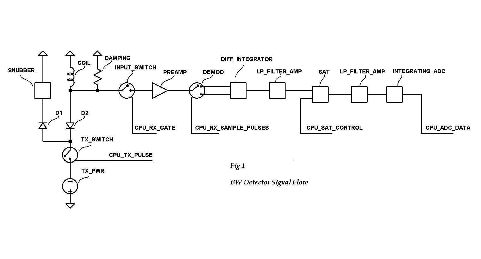

                      You said it
                      below is what I reversed out of this post .... http://www.geotech1.com/forums/showt...682#post152682
                      The critical functionality of the signal chain for a BW detector is shown with details of the exact cpu, power and audio left out. The audio is also clever but that is on the other side of the CPU and is in effect another signal chain. Everything is pretty much in functional blocks even on the circuit diagram ... note that some of the integrating ADC seems to be done inside the CPU ... and I dont mean binary. I am interested in this design because I would want my PI design to be "at least" as good as this one in performance .. so its a kind of benchmark for me.
                      Now maybe after a few tweaks in the understanding and deciphering of the schematic ... the components can be mapped over the functionality in a clear drawn schematic. Then using the public information already published here and there with some hints from forums like this you would arrive at a functional detector. Note there are two CPUs on the original schem but only one is used for the core PI functions ... the second one seems to be for bells and whistles ...

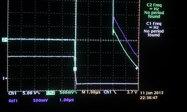

                          • earth field test results update ....
                            ... been fairly busy with other things however the earth field rejection tests have proven successful. I realised I forgot to check the waveforms around the front end after I did the earth field mod and ( unintended benefit !!! ) the mod actually improved the "no resistor" LOL damping method. I am now getting the minelab reference coil ( actually its a commercial nuggetfinder mono coil ) to damp in 3 microseconds ( was previously around 5 microseconds which was still good ) so I picked up a couple of microseconds.
                            Now the pic below shows the waveform at the output of the first stage of the detector, the white trace is the mosfet gate, you can guess the rest, its not a very big target but its "tc" is definitely not near 3 microseconds and some of you will realise why my damping method is new and that the old math dont count no more. ... clue the only bit of the waveform that moves is the bit after the flyback ... and no dorothy ... I am not using a switch to do that .. only the target LOL
                            ( maybe get ready to see alot of PI patents become old hat in 2013 ... )

                              Hi Moodz,
                              Did you get the can at 6' !!!, an 18" coil @1us will open up a lot of ground that was too deep for the littlies, how will this result help with the larger deep nuggets
                              Ron
                              PS:Is there much else to do cause i'm finkin i gotta sell me M/L
