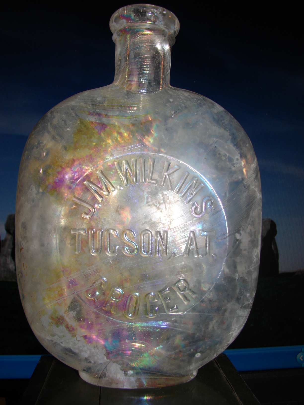

          Thanks for the reply and the explanation of the nano-tesla estimates. My main hobby is digging old privies for bottles and mainly use a spring steel rod to find them. Had a Mala GPR at one point but 250 mhz did not give the resolution needed. Have triClick image for larger version
ID:	334427ed other devices as well and always go back to the rod. Here in AZ need one with a slide hammer for the top layer. I spoke with Eric Foster years ago about one of his first PI units being built to find roman burn pits. I am taking some plots of pulse responses from dug privies and untouched privies and the surrounding undestrurbed ground. My goal is to build a PI for the explicit purposes of finding these Outhouse pits. Sorry to hijack your thread.....attached a picture of one of my finds, it is an unknown whiskey from 1883. A.T. is of course Arizona Territory. Will keep my education going by reading as much of the old posts as possible. Happy New Year, Karl
