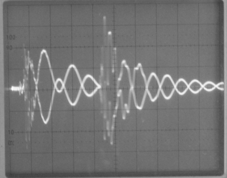

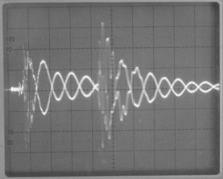

      Hi Tinkerer,
      Thanks for the explanation. Looks like you have some novel features - no damping resistor for instance. Presumably this works for a wide range of coil inductance/resistance/capacitance, plus cable capacitance and the resulting resonant frequency?
      My question still remains though: where is the noise that is troublesome? A transient can be avoided as noise if it occurs outside the sampling window and is synchronous - which this one has to be. Any long or stretched transient that strays into the sampling pulse will be fixed and of constant amplitude and can be easily nulled out.

        I think you refer to my post #745, where I mention switching noise with traditional PI.
        The circuit above is the solution I found to the coil, cable and shield capacitance. It does indeed work over a very wide range and the resonance makes it very power efficient.
        It also makes it possible to increase power very much, without avalanche.
        There is no damping resistor on the TX, but on the RX there is a damping resistor. R1 +R7, shown in the preamp circuit. I add the screen shots of the differential signal, as it comes on the cable, before the filters and without damping.
        There is a feature on these 2 pictures that I find interesting. The change in the waveform is clearly seen between the NO target and WITH target. But I think it tells us something more although I have not yet deciphert what it says.
