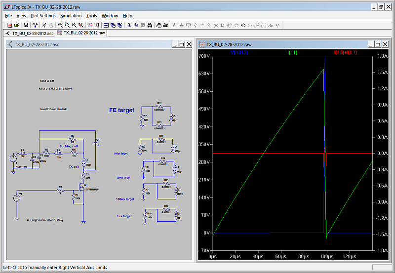

                        Have a look at this simulation.
                        The green trace is the coil current.
                        The blue trace is the coin voltage.
                        The red trace is the RX coil current with IB configuration.
                        Adding more capacitance to C1, reduces the coil voltage and increases the Flyback time. You need the increase the OFF time.
                        The full cycle is 100us, for a 10,000 PPS
                        Try the target response with different target TC's
                        I add the LTSpice sim in zip

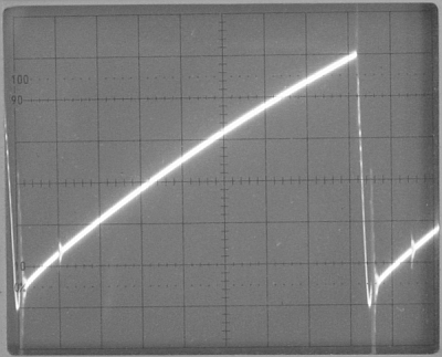

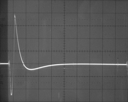

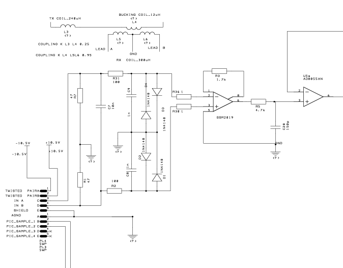

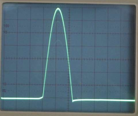

                            I have some old scope shots, not exactly the same Flyback voltage and time, but if you find it interesting I can fire up the circuit and take pictures.
                            Attached picture of coil current wave form, measured across 0.1Ohm resistor in series with coil.
                            Flyback wave form
                            Input filter and preamp.
                            Output of preamp, with no target but ground, full cycle.
                            The coil is a 45cm diameter TX about 300uH and 22.5cm diameter RX + Bucking coil. RX is center tapped about 300uH

                                I have never succeeded in making a balanced coil system for a PI that didn't show a transient during the flyback time. Your flyback appears to be without any avalanche phenomena, so it is a cleaner transient and therefore your resulting RX trace is different to what I have observed. However, I do not get the long tail which stretches out to mid screen in your RX scope picture. Could this be due to the RC time constants that you have pre the clipping diodes - are they matched?
                                I have tried DD arrangement and coaxial stacked coils on a PI, and the coaxial stacked gave the best balance as the geometry has the best symmetry. However, each coil has to be individually shielded, taken via separate cables and carefully grounded at the electronics end. Shielding and where it is grounded is very critical and I dont know if this can be replicated on a simulator. Most commercial DD coils seem to have minimal overall shielding for both coils and is no good at minimising the transient. Having three cables is a pain and I suspect that it is possible to get it down to two by having screened twin and a good differential front end.
                                I would expect to see a transient during the switch off period but for the RX to flatline as least as quick as that obtainable with a mono coil.
                                By the way another thing to look out for is eddy currents generated in the coil connector, if it is metal bodied and has parallel pins. This gives a long tail as in your waveform due to the TX pins acting like a small one turn loop close to the metal body. I got rid of it by using separate connectors for RX and TX. For a mono coil a coaxial connector is best.
                                Eric.
