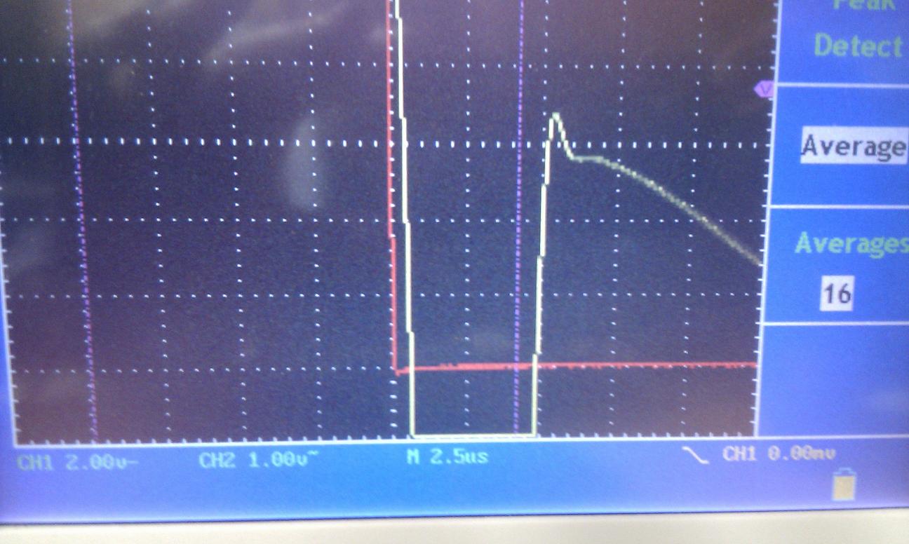

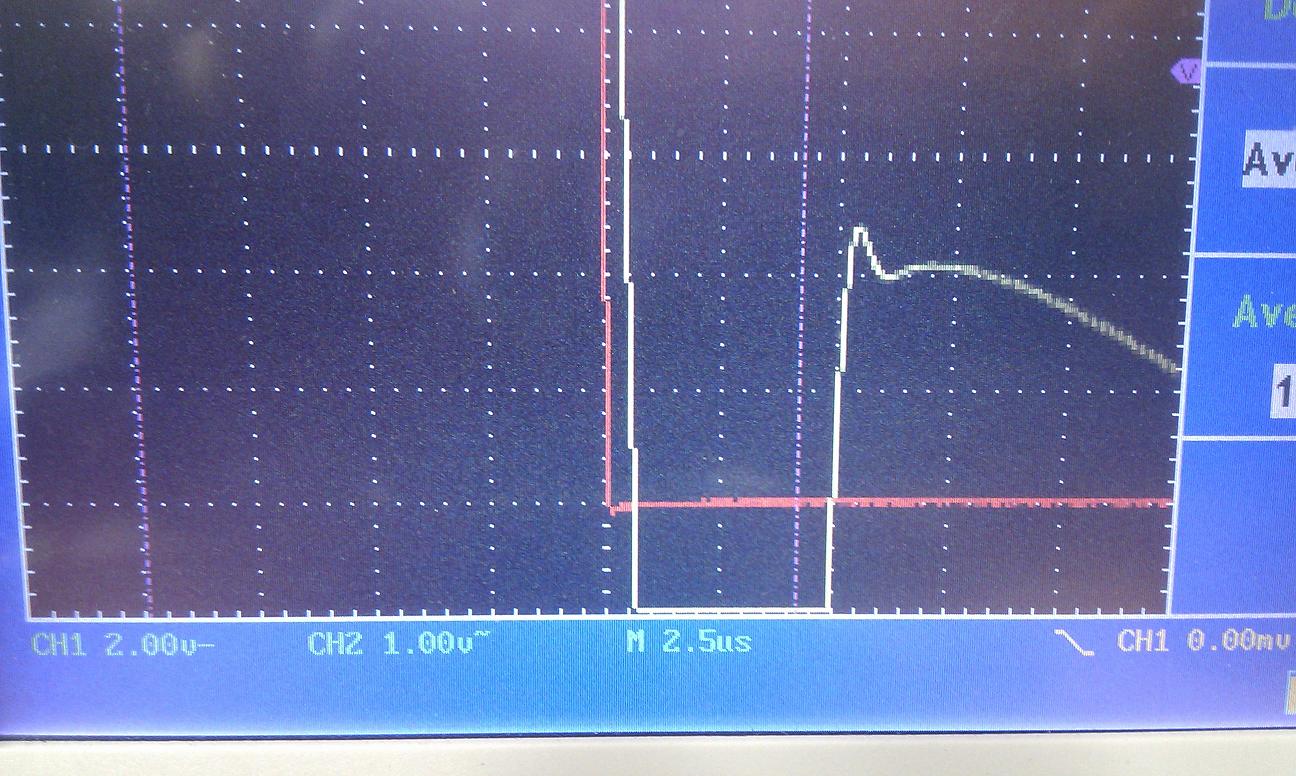

        I made a couple of changes to the front end and the Mag problem is solved now ....
        The shots below show the output ( yellow ) of the first stage with a 1 gram natural gold nugget ( ie not a ring or foil ) at 2cm from the coil.
        The red trace is the TX OFF gate pulse edge.
        I am getting 1 volt of deflection which is not bad IMHO .
        This signal goes to the second stage where it is amplified again and DSPed etc etc etc
        The coil is a mono, 0.4 ohm, 300uH
        My "magic sauce' front end is damping this coil in around 5us ...
        waving the magnet does not change this result.

        • Wow! That's an impressive result.

              Moodz, the only changes I can see being made to the front end to reduce static magnetic field effects is to use capacitive coupling. Is this what you have done?
              • Originally posted by UrbanFox View Post
                There is a far more elegant solution involving DSP. Though I did give the cap method a go in a previous design. I have not tried the late sampling method suggested because it can create holes in the target response profiles.
                  However, your statement was "I made a couple of changes to the front end and the Mag problem is solved now ....".
                  What advantage do you expect to get from DSP when you state you have already solved the problem?
                  • I said " there is" not "there will be". ..... The changes to the frontend actually just pipe the mag signals to the dsp instead of trying to block them. If you can't solve a problem in one place ... Solve it in another.
                      The "holes" in the target response profiles will only be a problem if you make the secondary sample pulse too close to the main sample. A much later secondary sample will only affect targets with longer time constants, and I presume you're really focussing on targets with very short time constants (such as gold nuggets).
