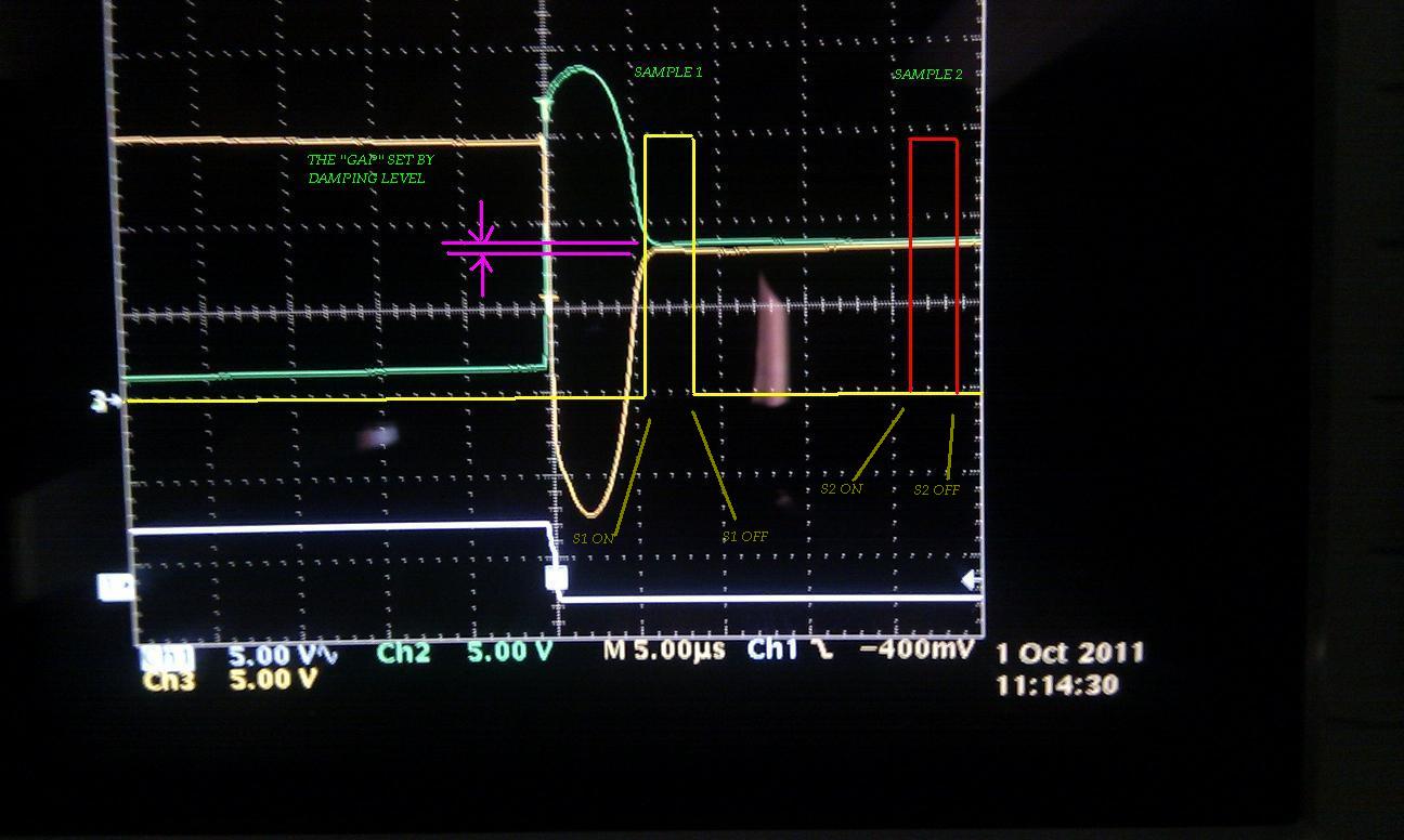

              That should be fine to try out ... I am going to modify the UNIPI code to move the damping control to the primary adjustment followed by sample pulse 1 position ... the damping level and the sample time for pulse 1 are the two most critical controls on for setting up and using the detector .... or they seem to be. The voltage "gap" or differential between the two flybacks at the settling point can be minimised by adjusting the damping. This point is also where the descrimination occurs.
              moodz.

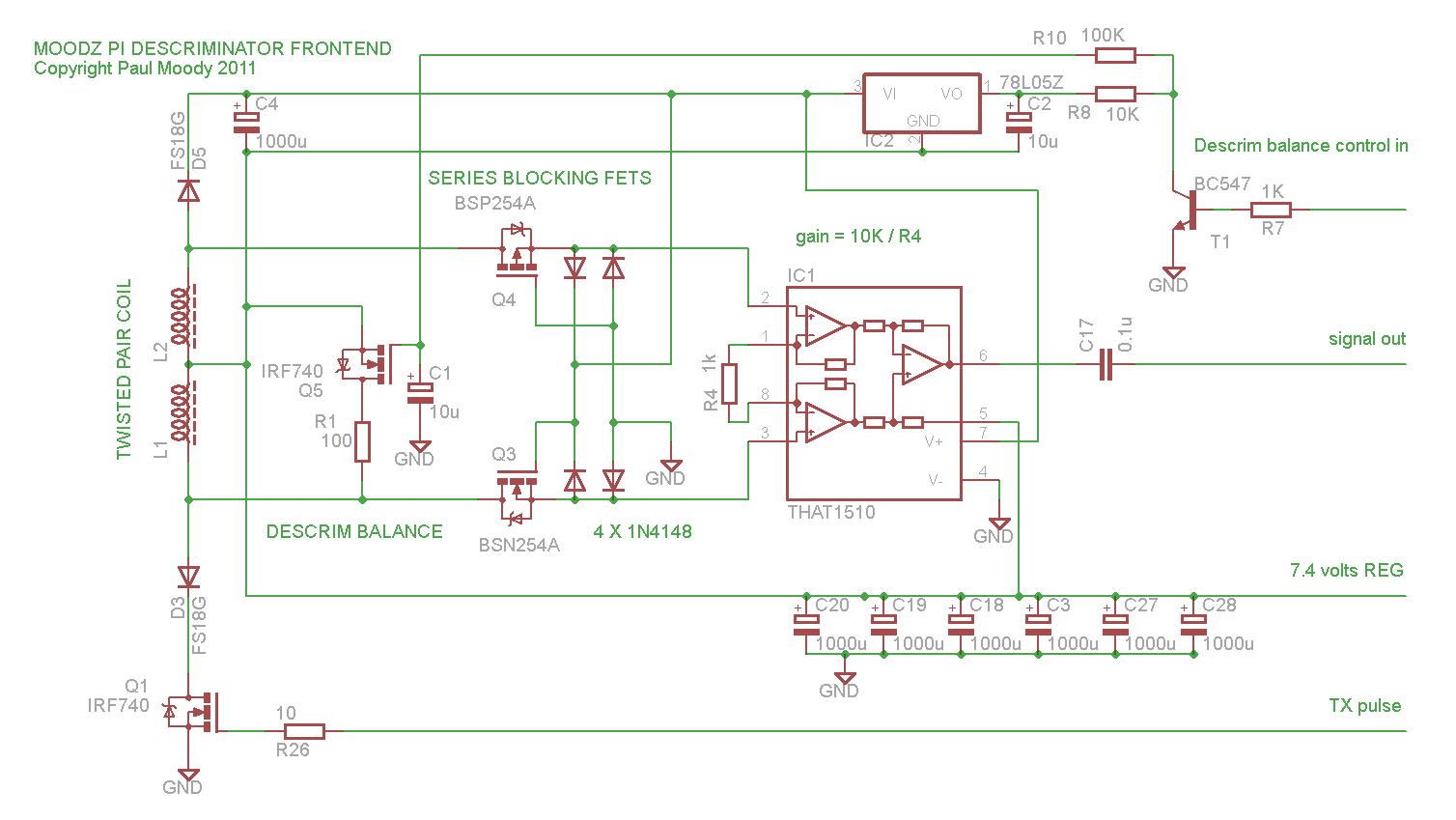

                          UNIPI Descriminating PI FRONTEND v230 Revision002
                          The control signal previously referred to as a damping control is more correctly termed a descrimination balance control .... you will see it how it works when you build it
                          Its beneficial and cost efficient that the split supply rail power for the frontend is provided by the differential coil however when a big target is near the coil like a large piece of iron alot of energy is lost and the voltage varies ... because the descrimination balance control is fed from this voltage it causes the descrim to "unbalance" ... and because of the low pass filtering delay ... there is a "memory effect" .... ie a target response remains after the target is removed.
                          So to fix this a 5 volt regulator for the descrimination balance supply has been added .... I suppose a zener diode would work also however I personally prefer the regulator ...
                          Also I have cleaned up the protective diode arrangement .... the previous schematic was not good in this area.
                          Updated schematic below ..
                          Moodz.

                            Hi Paul, how does the that1510 cope with the variation in voltage. Would it be better to have a second regulator before the 5v reg for the amp ic and for the protection diodes.
                            Still waiting for the fets to turn up, maybe tomorrow then I can test I few ideas I've had.
                            Mick
                            • #59
                              Mick
                              The problem with regulating the amp supply is that because one side of the coil is sitting near ground during TX it would "short" out one of the power supplies via the N mosfet via the protection diode. The amp also has protection diodes on the input.
                              The power suppy rejection on these amps is very high and additionally all the fluctuations on the supply are synchronised to the TX. The descrim balance has no rejection though and was being affected by large target field suck outs on the coil.
                              moodz
                              • #60

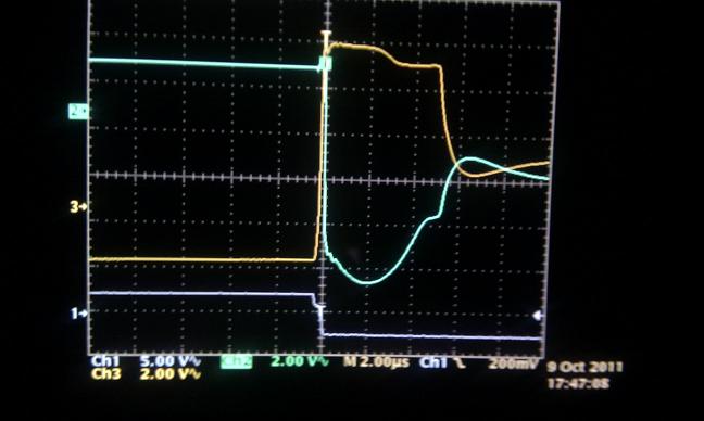

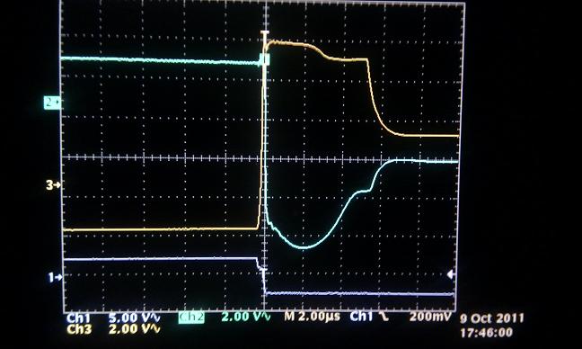

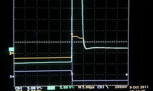

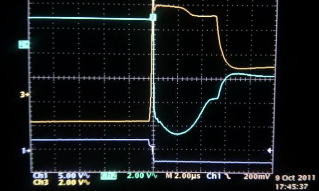

                                some results ...
                                Regulated voltages all round and some nice blocking
                                moodz
                                blocking the the flyback ... +ve only shown here ..
                                The voltage excursions a the input are 400 volts and busted down to this with no resistors or diode clamping No target.
                                A small pair of side cutters about 2 inches from the coil ....
                                A small piece of copper PCB about 2 inches from the coil .....
