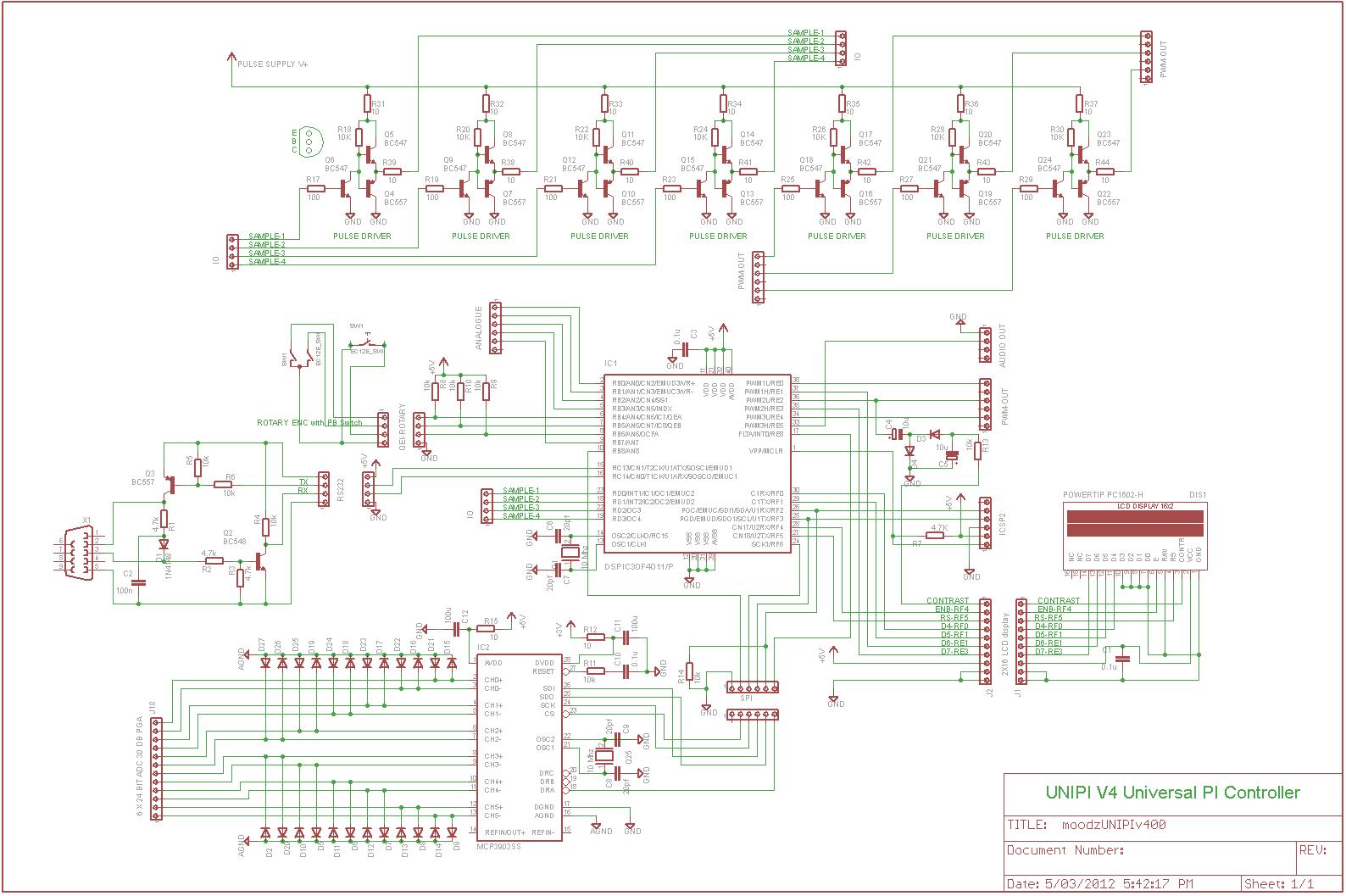

    • Hi hdphilip
      I understand that D6 and D7 will clip down the fly back spike coming from the coil, thats pretty standard
      but I dont get why we need the extra D2,D4, D11, D12, going off to vpp, when the signal is all ready clipped
      please enlighten me
      • You don't need D6 or D7 but you do need to have the other four diodes connected and referenced to the coil VPP.
        D2,D4, D11 and D12 are the ones that clip the flyback.
        • Thanks Mick

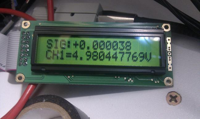

            ...been slaving over a hot processor for a couple of days now ...the good news is that the 6 channel 24 bit ADC code is now stabilised ( had some comms issues ... solved ) and the initial DSP filtering code is working .... see below ... the old resolution is the top reading ... the new resolution is stable voltage readings to 9 decimal places ....nanovolt country.
            The dithering, oversampling and narrowband measurement technique allows effective measurement to little shy of 28 bits and could probably do better with a little clock fiddling.
            There are 6 independant 24 bit channels that with a filter cut off of approx 32 hertz down to DC ( think of 6 ultra precision voltmeters ).
            The next steps are to build the samplers / demodulators and construct the code to do the (V1 - 0.77V2 + tan(V3)) * 0.006V4 ... .... or whatever the algorithm is going to be for target extraction.
            moodz.
            • Paul,
              very impressive
              in order to have the last digits being stable, were you measuring a battery?
              Philip
              • Originally posted by hdphilip View Post
                Paul,
                very impressive
                Philip
                Good question .... actually I have just realised what you are looking at is a bug .... but its a good bug . If you refer to the schematic posted previously you can see that every channel has protection diodes to AGND at the differential channel inputs. Channel 1 was reading a precision 5 volt reference coupled via 1 K resistor .... but of course this will forward bias the protection diode and the channel is actually reading the voltage drop across the conducting diode.
                So actually that reading is supposed is supposed to be 0.4980447769 volts .... the bug means I have a decimal point in the wrong place so I need to check the printf formatting in my LCD code.
                Thats 10 decimal places not 9 or 0.1 nanovolt resolution.
