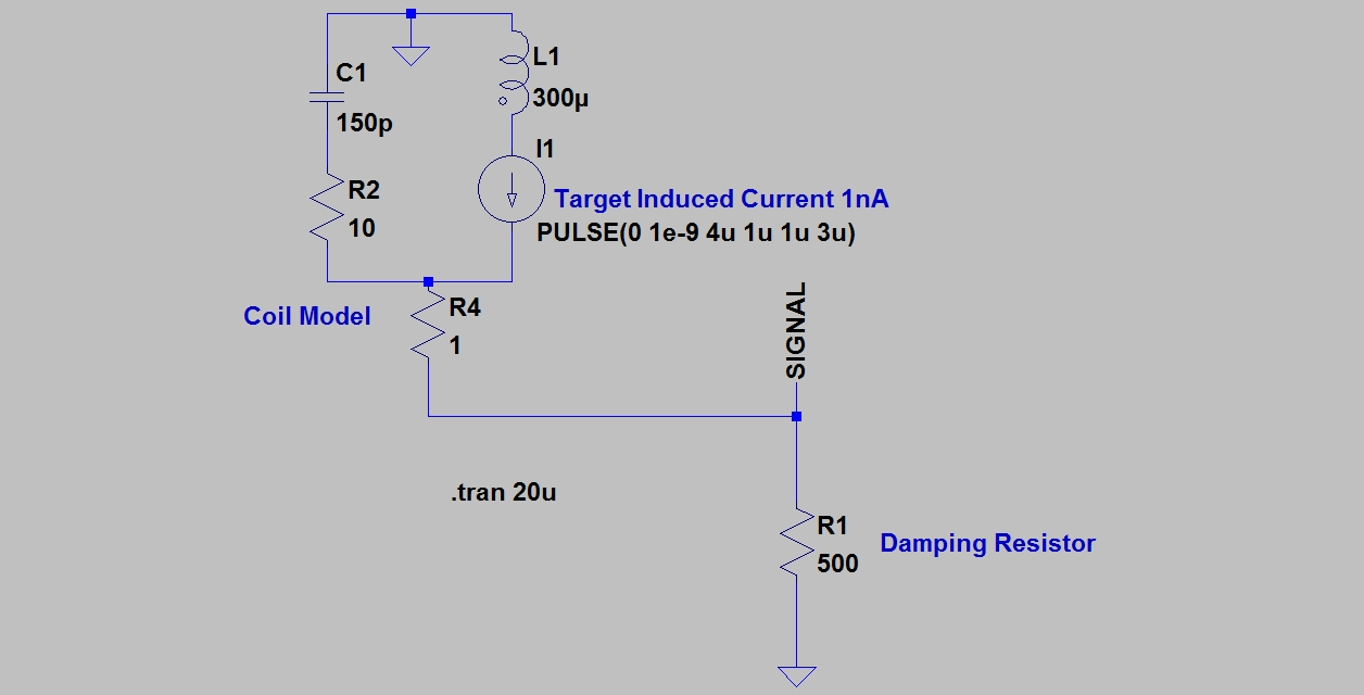

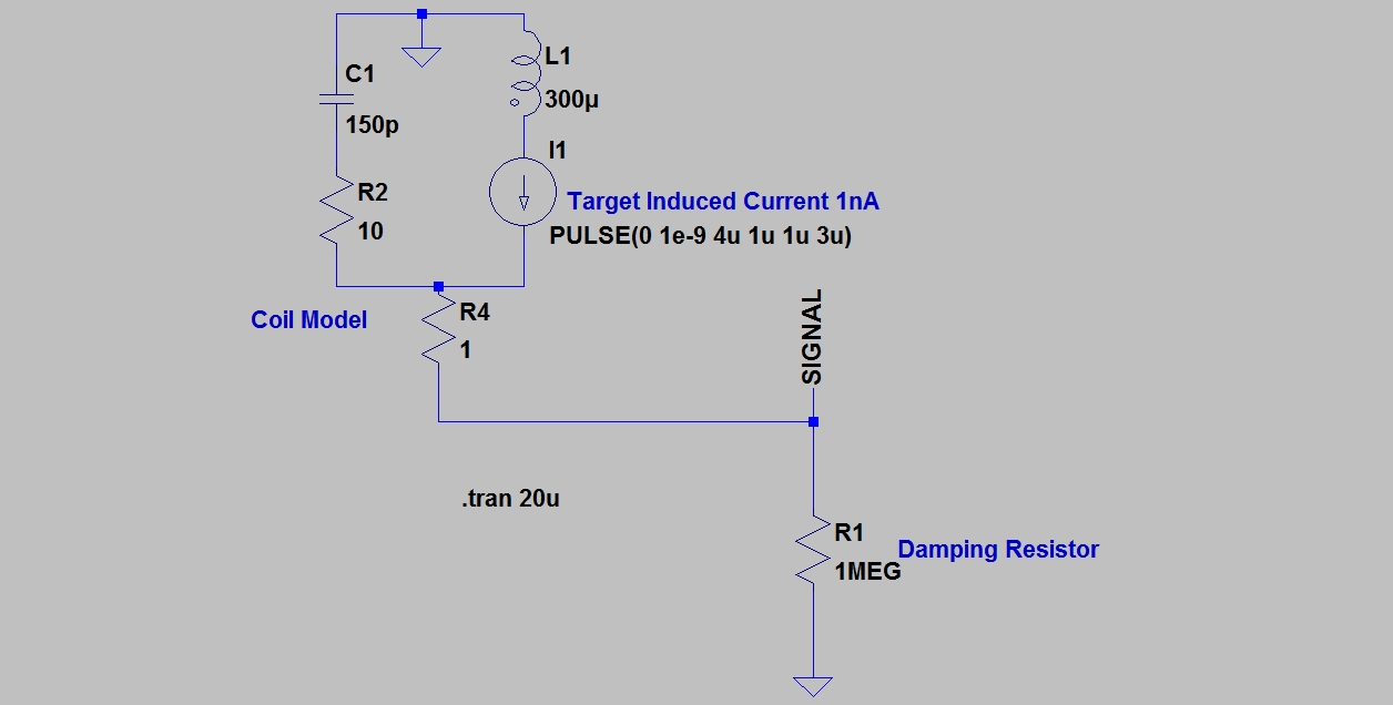

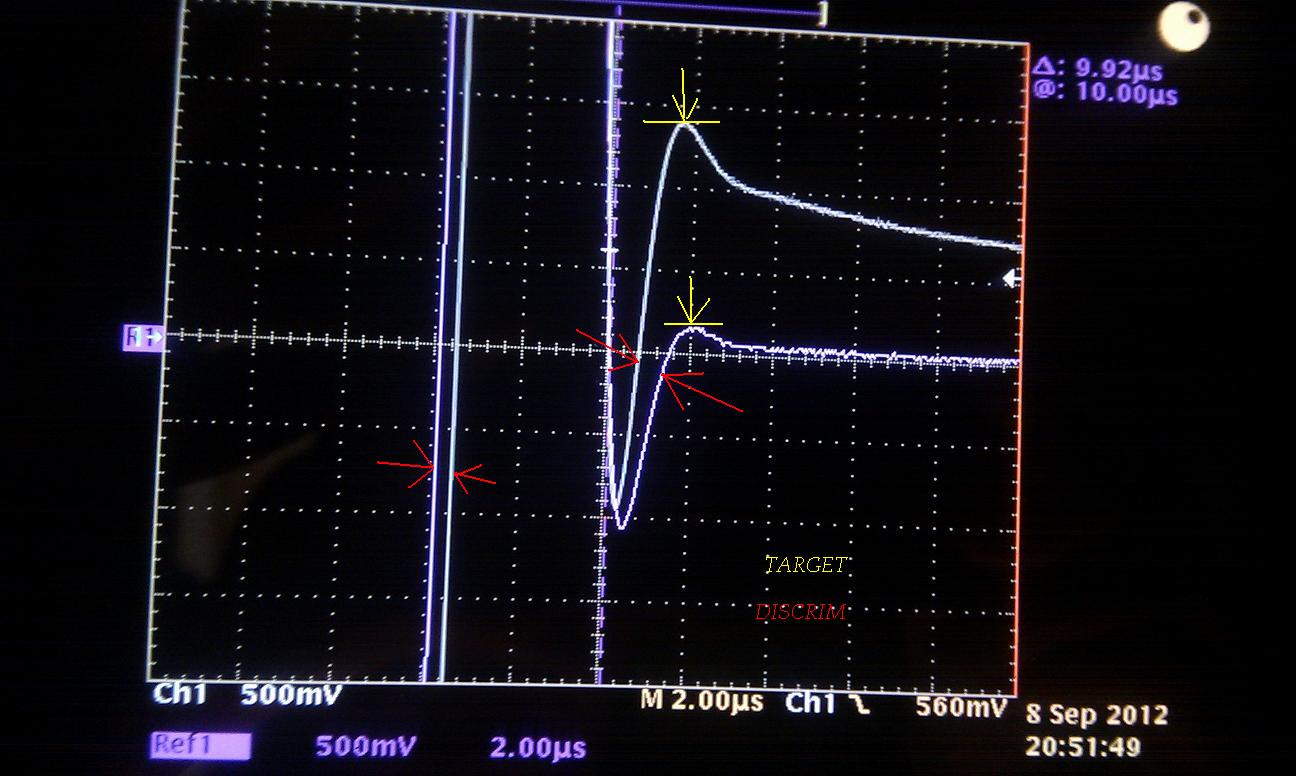

However, playing with Mr. Thévenin's theorem and the fact that coil/target system works as a (very non-ideal) transformer, that 500ohm would interfere with target taus.
It would not interfere greatly with target signal strength, but will surely screw up any chance of correct discrimination.
